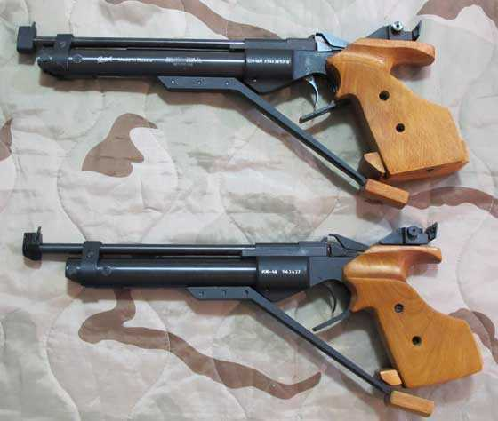

M model (top) pistol has a longer compression tube, and shoots faster; so a shorter "lock time":
From PA article linked above:
"Difference between the IZH 46 and 46M
There is really only one significant difference between the standard IZH 46 and the more powerful 46M and that is the length of the pump mechanism. The 46M pump tube is almost an inch longer than that of the standard 46, resulting in a longer piston stroke that compresses more air. The result is a muzzle velocity of about 500 f.p.s. over 425 f.p.s. for the standard model. Other than that, the two airguns are identical.
