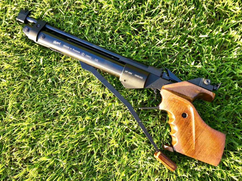

I’ve been thinking of getting a 10 meter pistol to shoot indoors this winter and the M46 looks like it might be a good choice. First off I’m a lefty so a set of grips will be needed but that’s the case regardless of whatever gun I get. My question to those of you with M46 experience is what if any problems do you see with it and are parts available if needed? Are there any other (maybe better) choices in the $700 price range? Thanks! Uj

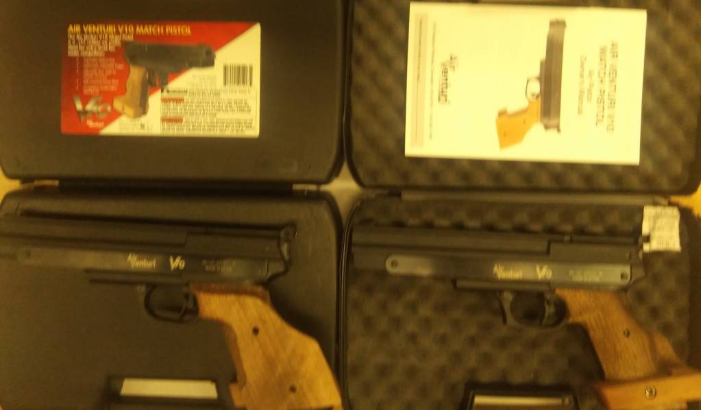

The Air Venturi V10 (Gamo Compact) is very accurate and quiet and easy to pump compared to most SSP pistols and available with optional lefty grips too and a great value for the money. I bought both right and lefty versions one for each hand like Nicholas Cage in FACE OFF.

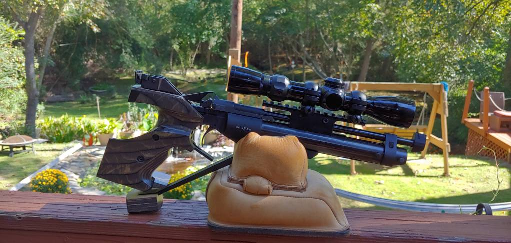

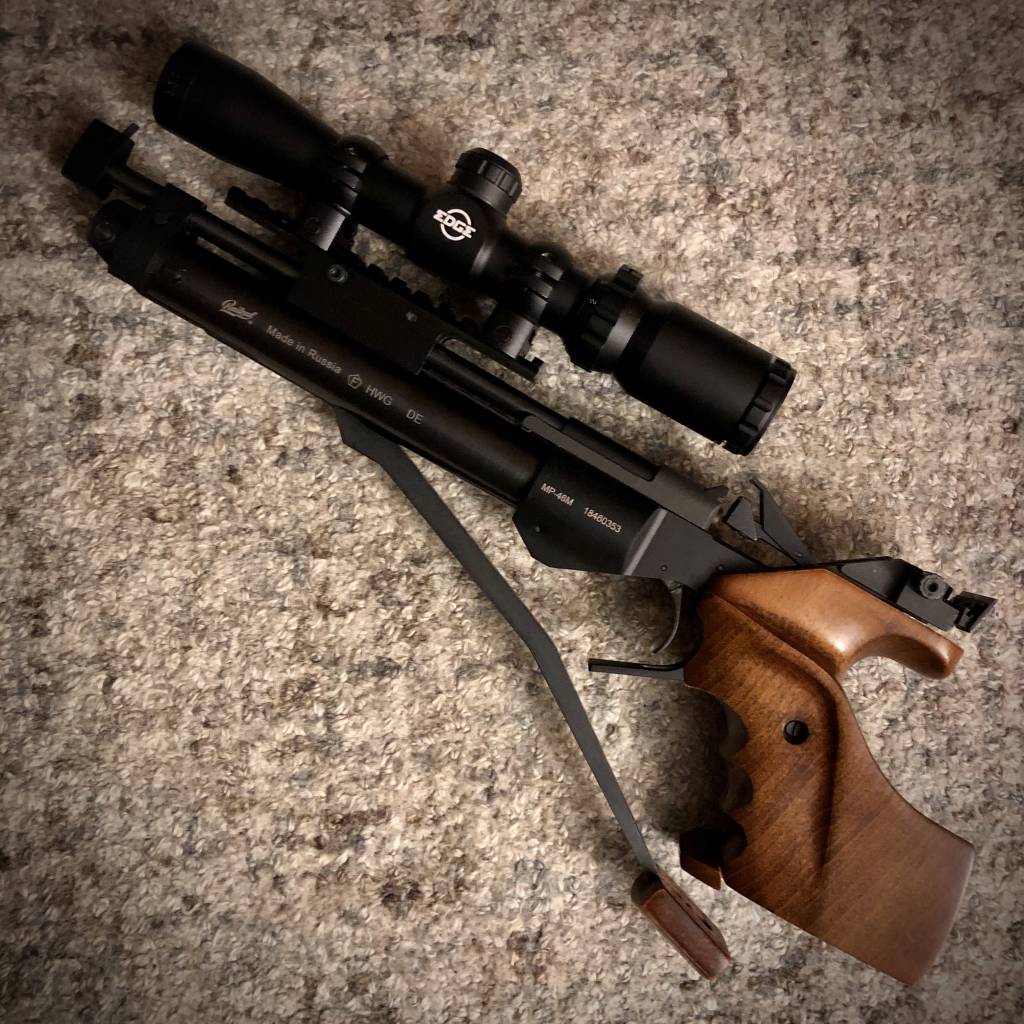

I haven't had one problem with either one. I had a red dot on one, now have a scope, and the other one is open sights.

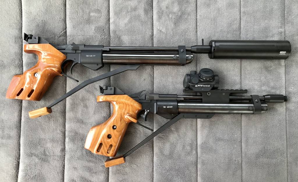

I purchased two 10mm moderator adapters from Donny FL and with the Sumo the gun going off sounds like a twig breaking. Cocking the gun makes more noise that the shot. Excellent for backyard use!

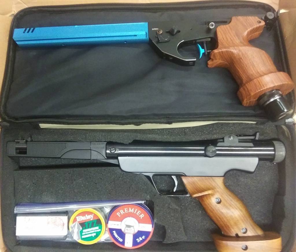

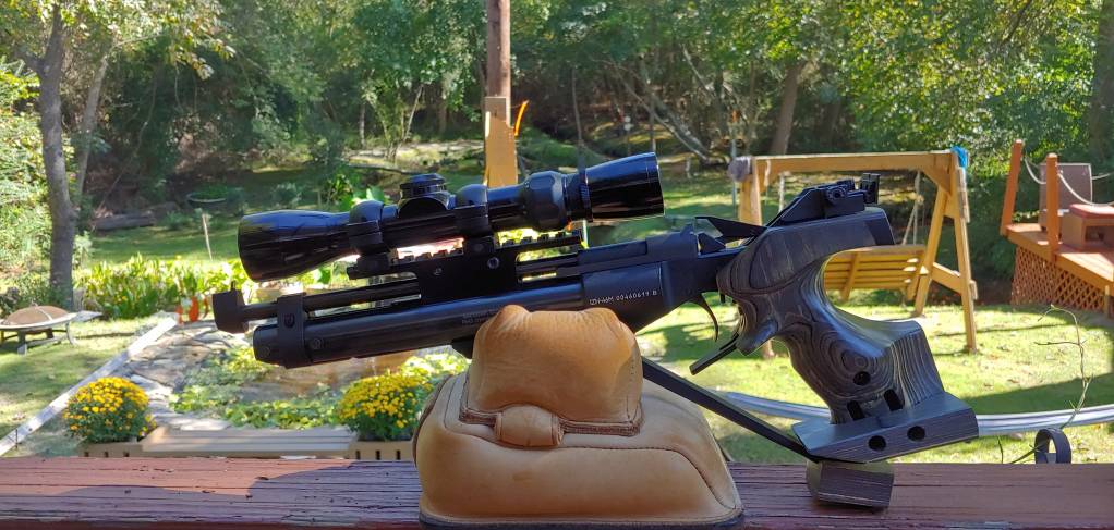

Pictured below 2 Air Venturi V10 righty and lefty. Only negative the upper half that houses the barrel is plastic.

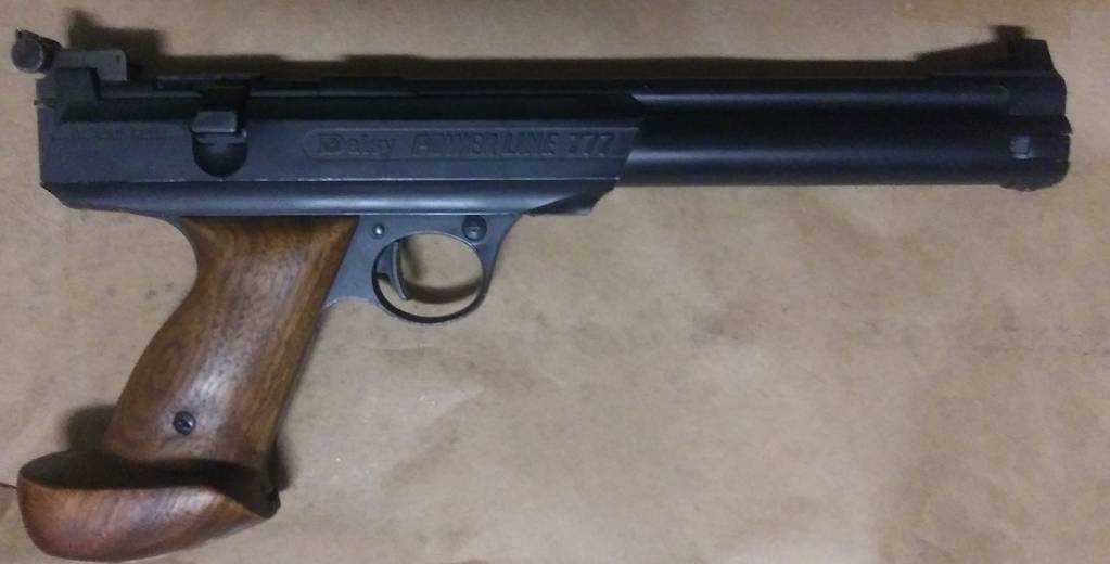

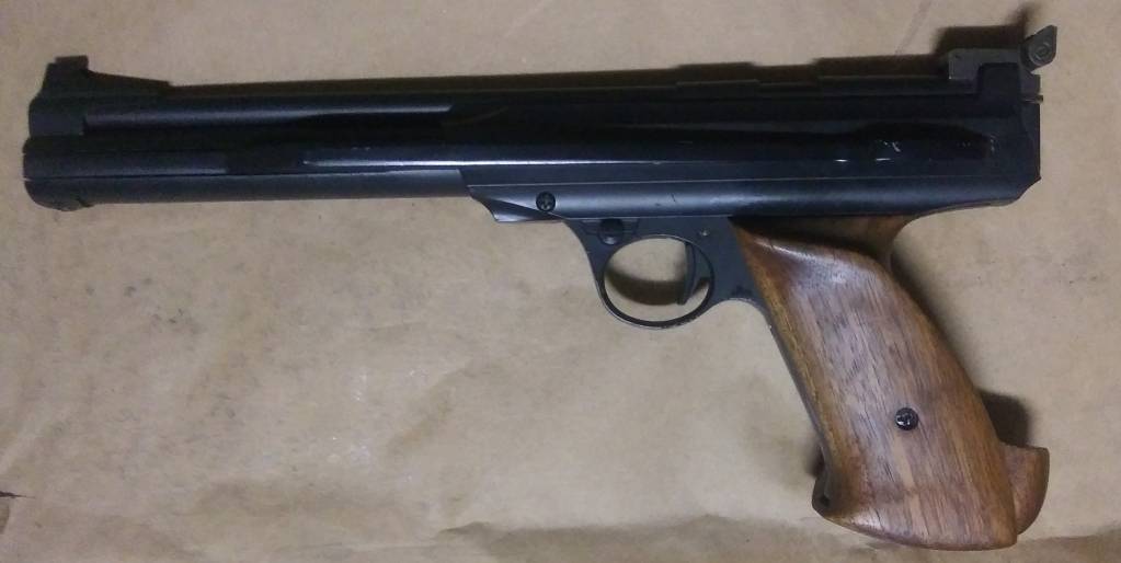

Daisy 777 worth buying if you find a used one in the $300 price point or a 747 for under $200. No fatigue shooting them all day pumping. Super quiet and one holers all day long. The IZH 46 Sun optics (formerly B Square) mounts work for scope or red dot sight use.

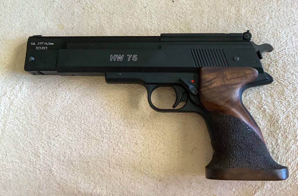

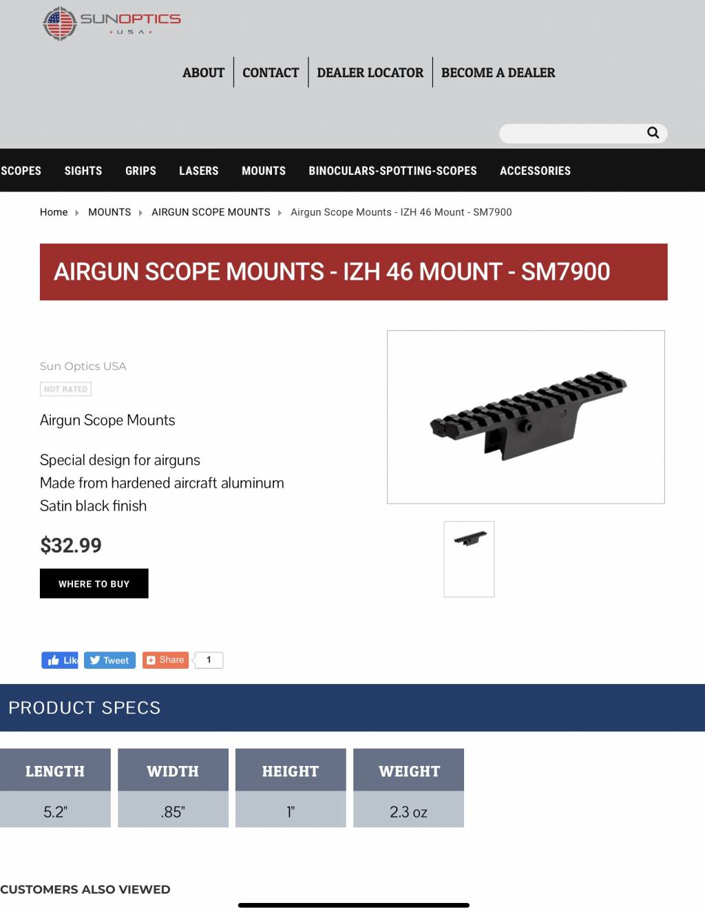

I have an Izzy and an HW75. I prefer the Izzy. Easier to pump and easier to get the adapter rail to go to picatinny mounted sights. The Sun adapter is still available for the Izzy but getting a 13mm to picatinny is difficult if not impossible. Parts and service are available from Mac 1 in California. There is a source via eBay from Russia that has numerous parts. Delivery is slow but he does get good reviews.

Both show special order for the Sun Optics mount. Call and ask. B&H supposedly had 8 mounts shipped to them but they never got back with me about them. I ordered August 1st. I contacted Teresa at Sun Optics and she graciously sold one to me which isn't their normal thing. I just received mine in the mail this past Monday (Oct 19th).
Go for the Baikal. I love mine and I'm NOT an air pistol kinda guy either. This one will be a keeper.
