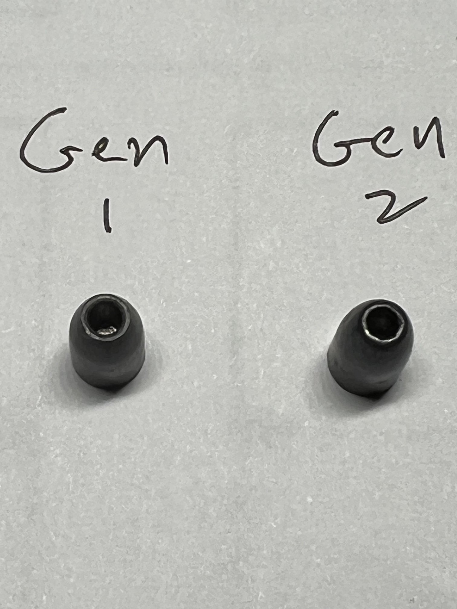

- I visually compared the 2 pellets... the Gen 2pellets have a smaller hollow point "hole" in front and look a bit taller and thinner. With a micrometer (mm) I measured Gen 1 @5.54w x 8.93h and Gen 2 @ 5.47w x 9.36h (see images)

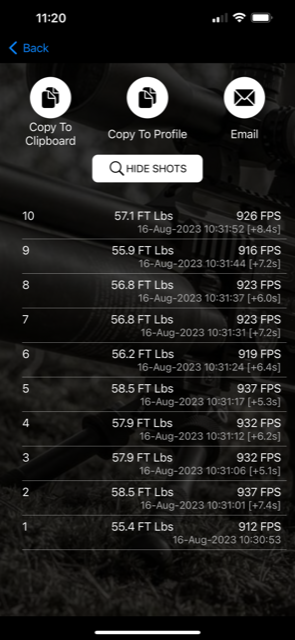

- Then using the same magazine and no change in settings of the rifle and shooting from a bench in sequence, I noted a large change in velocity with Gen 2 being 90 fps faster than Gen 1.(See images)

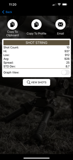

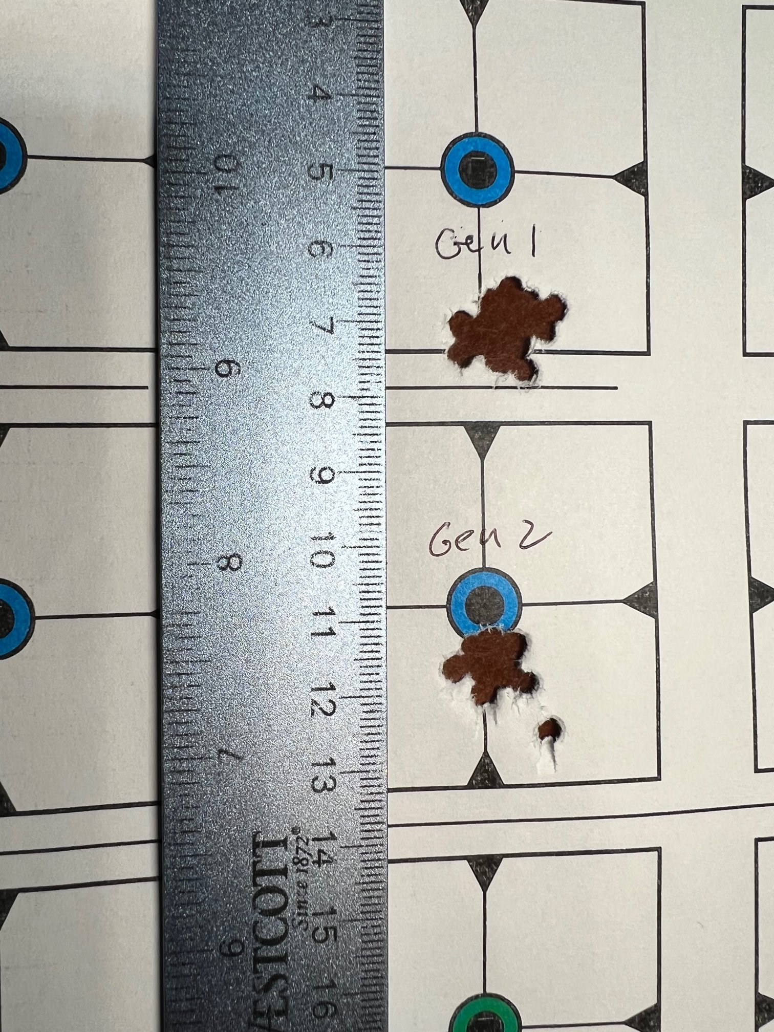

- Shooting a target @ 25 Yards with only a 2mph wind and no sig gusts I noted that the Gen 1 grouped around 1.5 cm and Gen 2 around 1 cm if I excluded 1 flyer (improved accuracy). There was also improvement in my velocity consistency (both SD and ES) in Gen 2 (See image)
