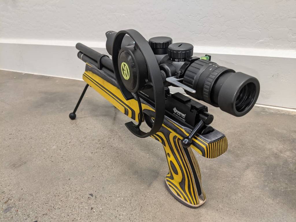

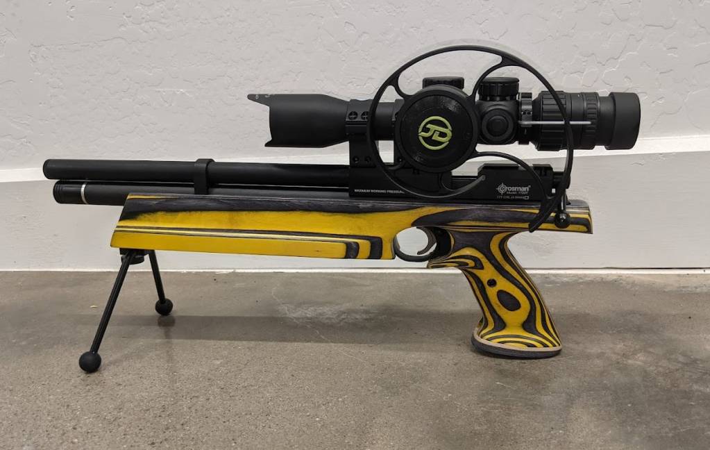

Bumblebee is the FT pistol I've been slowly putting together for the last 6 or so months.
The starting point is a bone stock 1720T.
I won a MTC Viper Connect 3-12x32 scope at the AZ State FT match, donated by AOA which is really what got the ball moving on this project. So that's the scope. Dunno how it'll shape out as a FT pistol scope but willing to give it a fair shake.
Sports Match rings.
And now the flashy parts....
Steve Corcoran laminate stock
and the final addition (TODAY), the JD's Custom Design aluminum side wheel.
My initial assessment is that I'm impressed. Very intuitive method of attachment. Elegant in it's simplicity really.

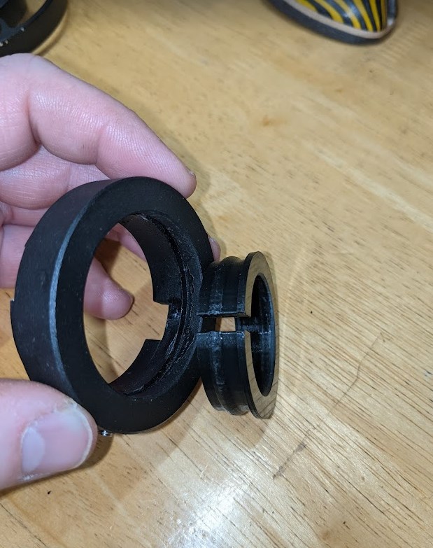

The "hub" that attaches to the side focus knob utilizes a 3d printed split ring. Split ring on the right in this photo.
There is also a raised ring all the way around the split ring that nests inside a groove in the aluminum hub, in the left in the above photo.
Those two rings are nested and then slide over the side-focus knob on the scope. One single set screw goes through the alum ring and compresses the 3d printed split ring to clamp onto the scope side focus knob.
My first thought when I saw only one set screw is that there's no way this is going to be a very "tight" fit. I was skeptical. But as I examined the parts, and subsequently attached them to the scope, I was pleasantly surprised to see that, by design, that single set screw compresses the split ring so that the surface area of contact between the split ring and the side focus knob is more than sufficient for a snug fit. There is no movement. The alum/set screw goes from being easily slid onto the side focus knob to provided ample securement in about 1/2 of a revolution of that set screw. Ingenious.

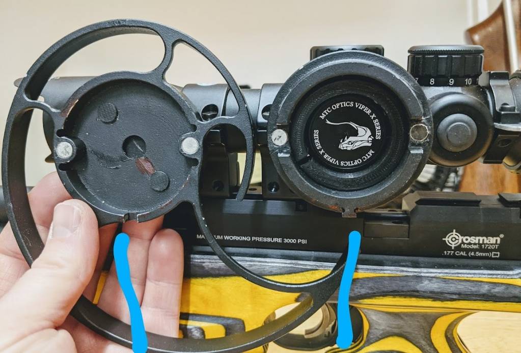

It is also magnetic. There appear to be 4 rare earth magnets holding the wheel to the hub. The wheel is indexed to the same point after removal and replacement by a notch/tab situation (blue lines in photo below). Simple, but superbly functional. The magnets hold the wheel to the hub quite securely, and the tolerances of that notch/tab are tight enough that there isn't any "play" in the system.

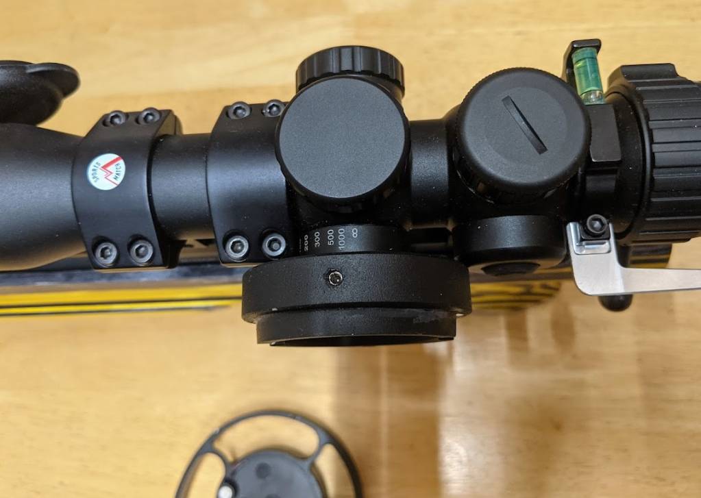

Oh yeah, forgot about the pointer option. Joe asked how wide of a bubble level I'd need to fit between the reticle light button bulge and the scope power bulge, and then included an appropriate sized one. That bubble level holds the pointer for the wheel. AND, there were a couple different designs of pointer included for preference, and fitment. You can see I used a raw alum one as it didnt extend across the button for the reticle light.
