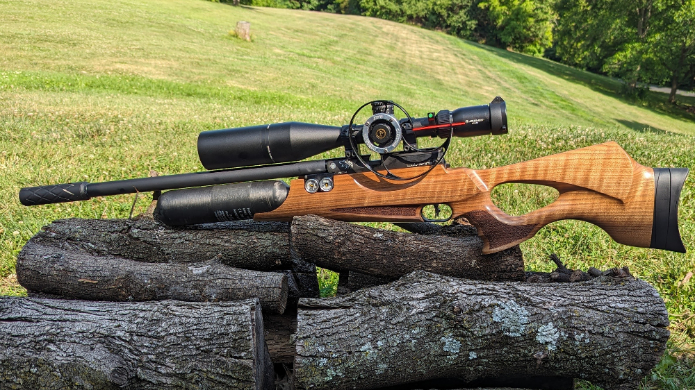

Ordered one of the magnetic wheel kits in aluminum from Joe a while back, & received it about two weeks ago. The hub fit perfectly on my Athlon Heras, & the extra real estate on the nautilus wheel helps spread out those 45-55 yard markings compared to the 5" round wheel I had previously. And it allows access to the illumination knob.
Finished my holdover dope & initial ranging dope last week, & double & triple checked this week, finishing yesterday (at least for "hot weather" settings). Out of the blue last night, Joe sent me a text to see if the wheel is working out for me. Now here's a guy who cares about his customers!
Really nice to be able to remove the wheel for casing the rifle or when not needed for ranging, & have zero changes to your markings when you pop it back in place. The pointer & bubble level that come with the kit also work well.
