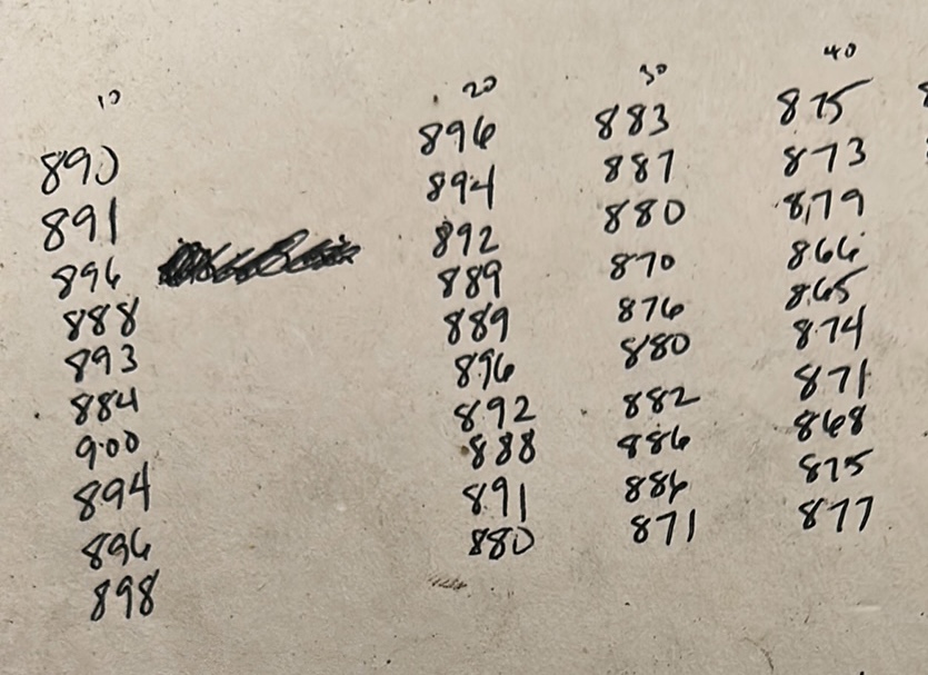

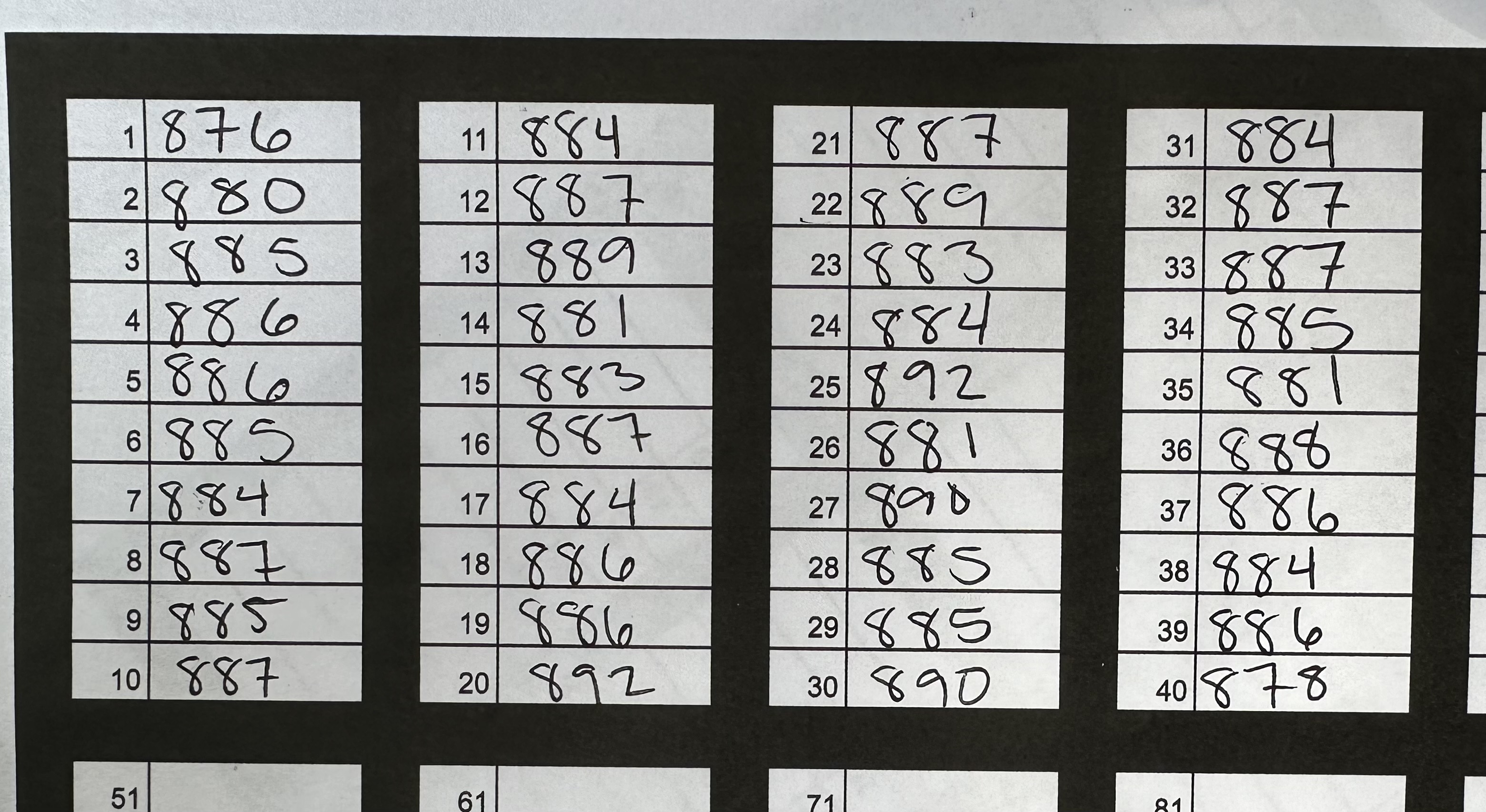

Here's an update for anyone following or looking to learn:
I removed my regular and the valve was not correctly firing. I would describe it as "seizing". Once the tank pressure dropped below 2100, it would shoot completely normal. So, I put the regular back in with it set to approx 2000 psi. Gun is shooting really good now. I will attach 2 images of my shot strings. The first one is from the stock(OEM) valve with my huma regulator. The second is the JSAR balanced valve with the huma regular. I calculated the standard deviation of the 1st 40 shots. The stock SD was 9.64. The JSAR SD is 3.11.
