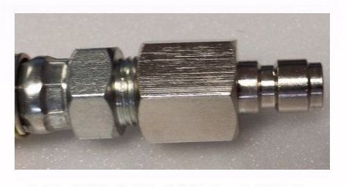

This male connector from China will mess up both Chinese and US Foster female o-rings. I've had no issue with Chinese female fittings for the most part.
