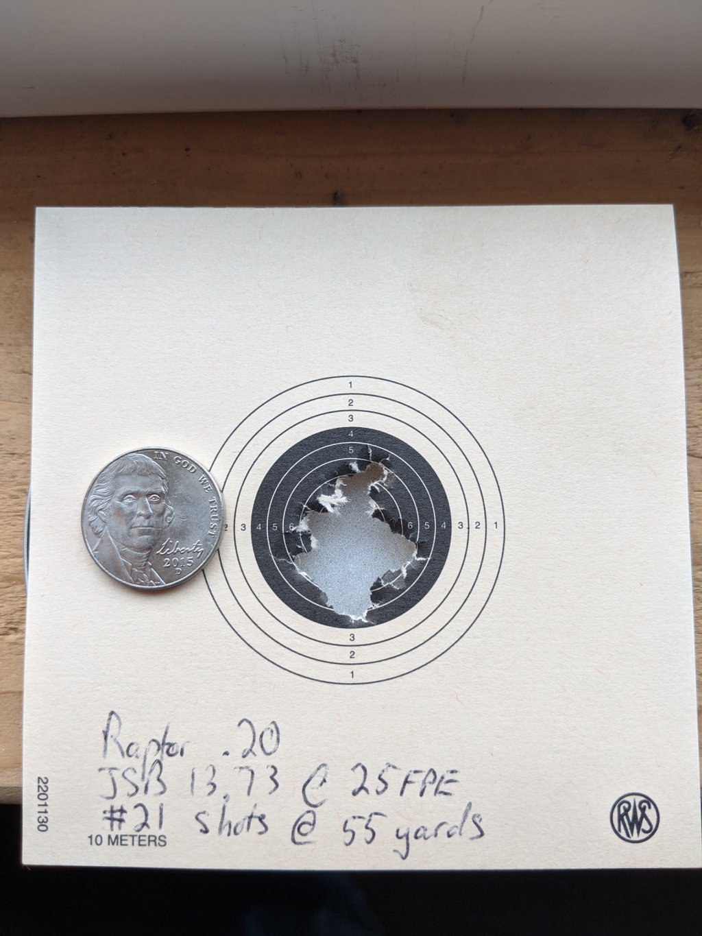

I received mine about 5 weeks ago, a full size in .20, somewhat as an experiment to see how .20 does in the wind at sub 20fpe, and somewhat to scratch an itch for a .20 pcp that Ive had since briefly owning an RX2 gas ram in that caliber.

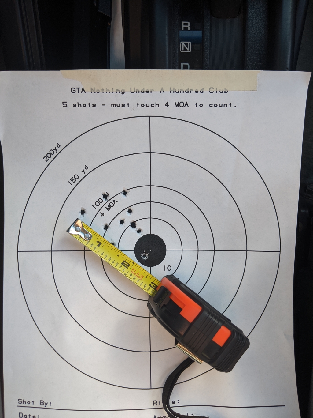

(Not FT related but this is how it did @ 102 yards and 24-25fpe with pretty windy conditions. 10 shots.)
While mine shipped with a fixed regulator (adjustable one pending-it currently does best at 24-25fpe and above), I have found my hopes for the gun to be true. By using my standard metric for a FT gun, the IFP paper target, the Raptor is performing right up there with a gun proven to be capable of winning matches, without any of the accoutrements found on the FT specific gun.

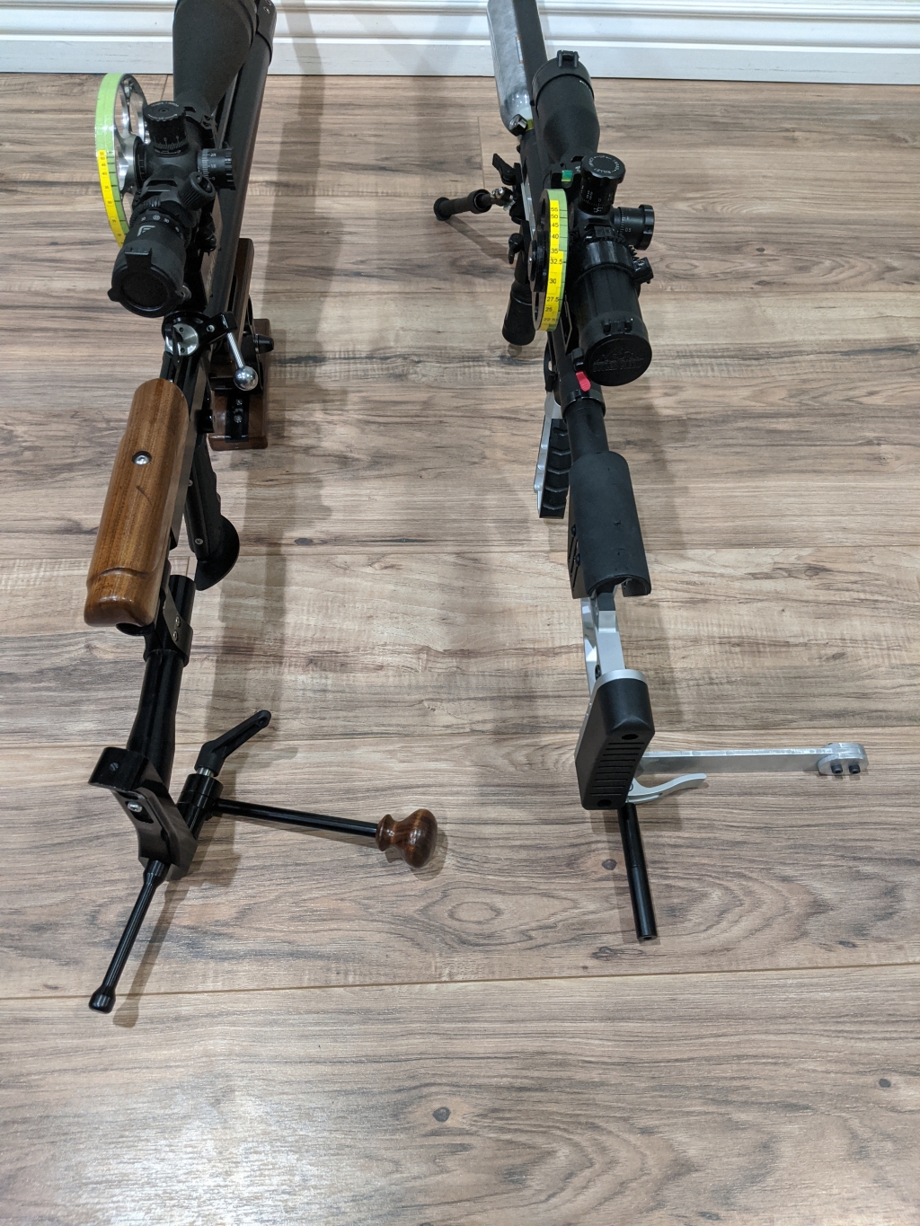

I built a thigh rest for the Raptor. For Open class they are legal and, in my opinion, really help with side to side stability. They essentially swing down from the stored position to….rest on the thigh.

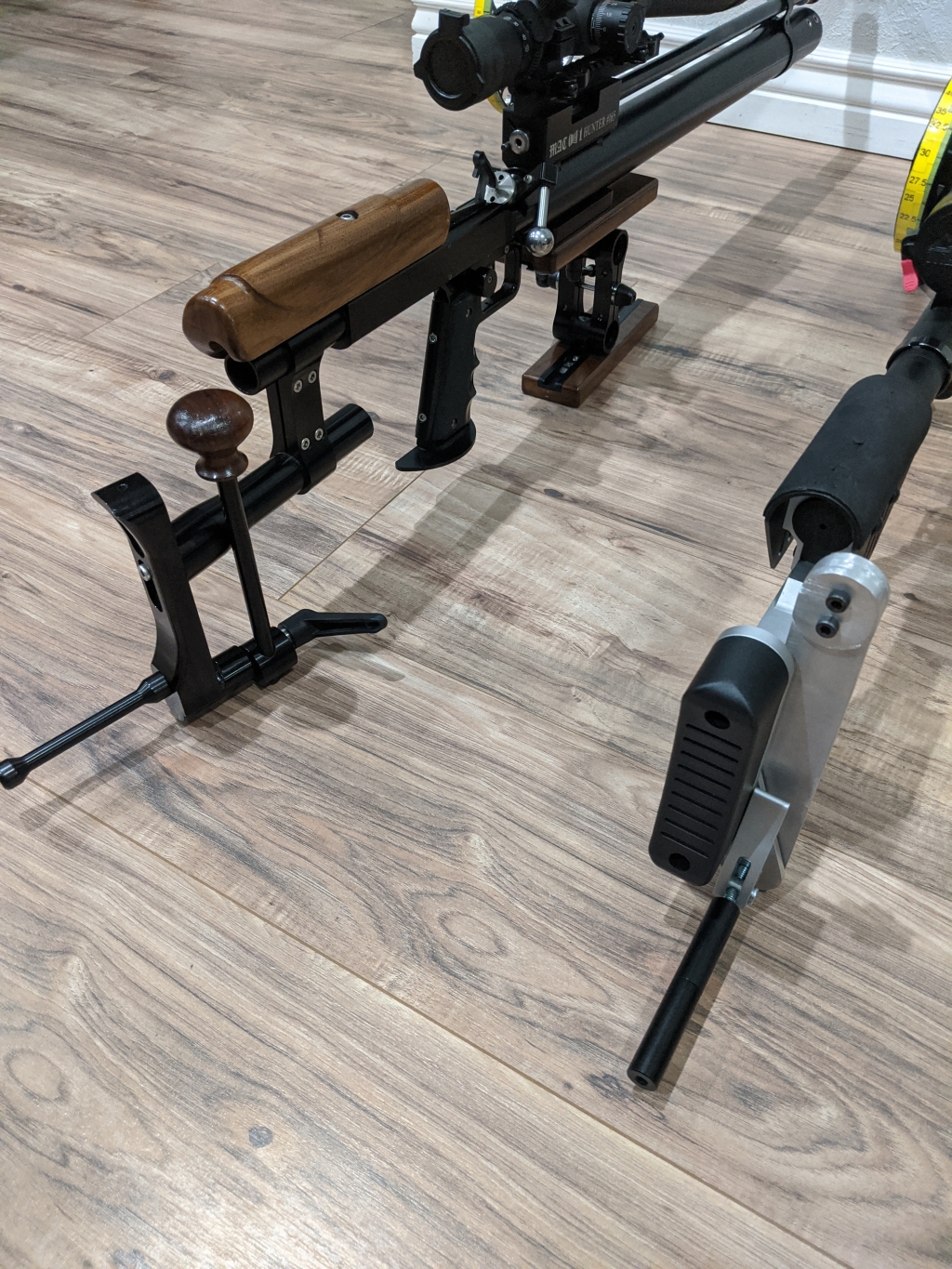

Here's a pic of one for those unfamiliar:
The cam/lever unlocks to swing it down to the thigh, and locks it in position, at either the stored or deployed positions.

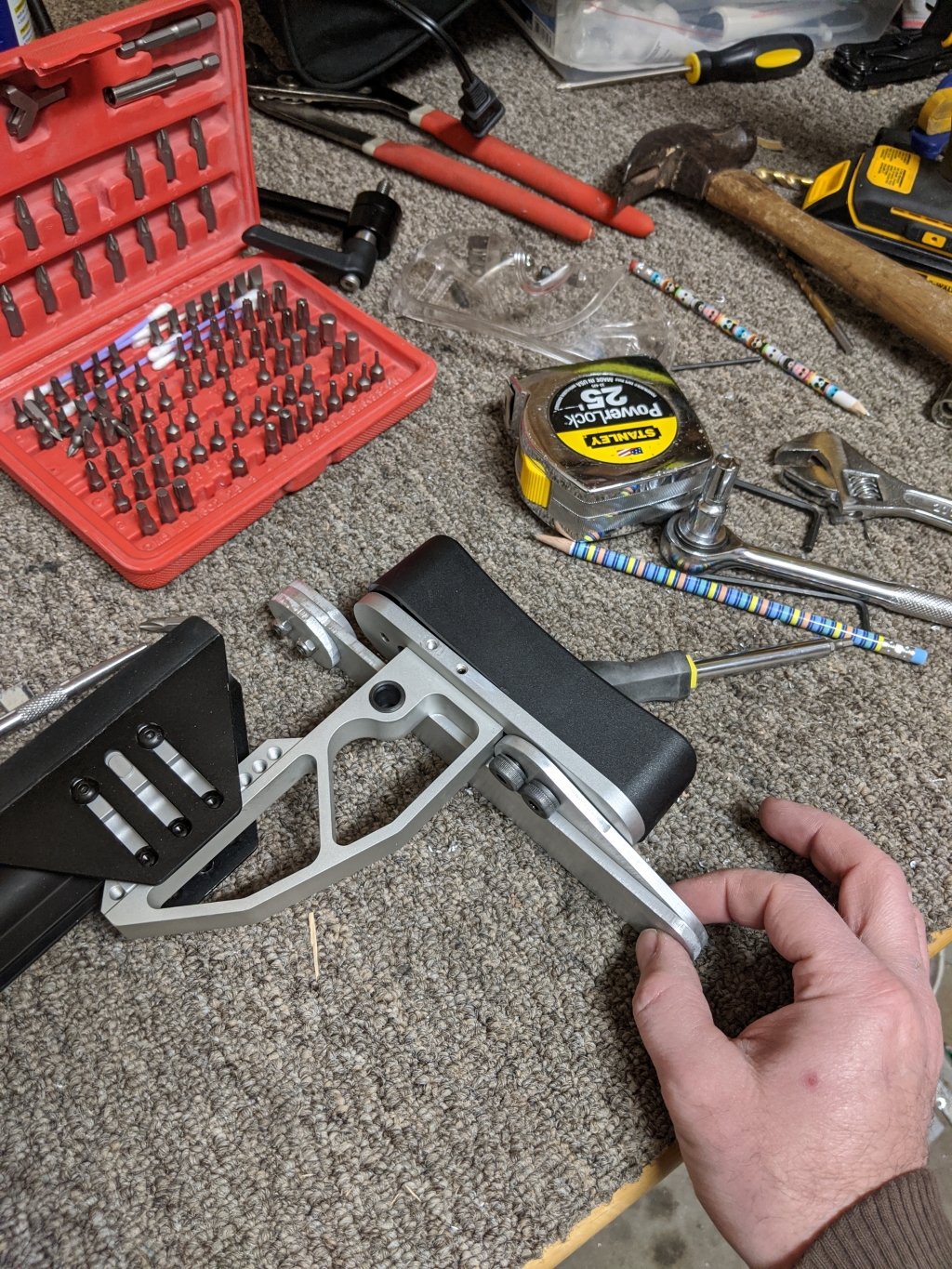

Here's the one I built for the Raptor:
This one is lacking the cam lever (should be here on Monday). It will pivot where I'm am pinching and unlock to swing down and be lockable in the stored or deployed position like the one in the first picture.
Aluminum seemed the obvious choice. Kind of interesting back story to where the aluminum plate came from…..I grew up on a ranch in Oklahoma. For a growing boy, a couple thousand acres was an awesome place the hunt and fish and just roam wherever I wanted. Well we had these signs posted everywhere, keep out, no trespassing, that sort of thing. Well when the ranch sold when I was about 20, the signs were taken down and placed into a big conex (among a bunch of other random stuff) that was then moved here to AZ. I noticed the signs a couple months ago and made a mental note that they were there. When needing some decently thick aluminum plate for the Raptor thigh rest, I went and grabbed a sign. Turns out aluminum can be cut with a jigsaw and shaped with a belt sander. Took longer than necessary with the lack of proper tools but seems like it'll work for the intended use. Kind of cool, in a nostalgic way, to literally have a piece of the ranch on the gun.
