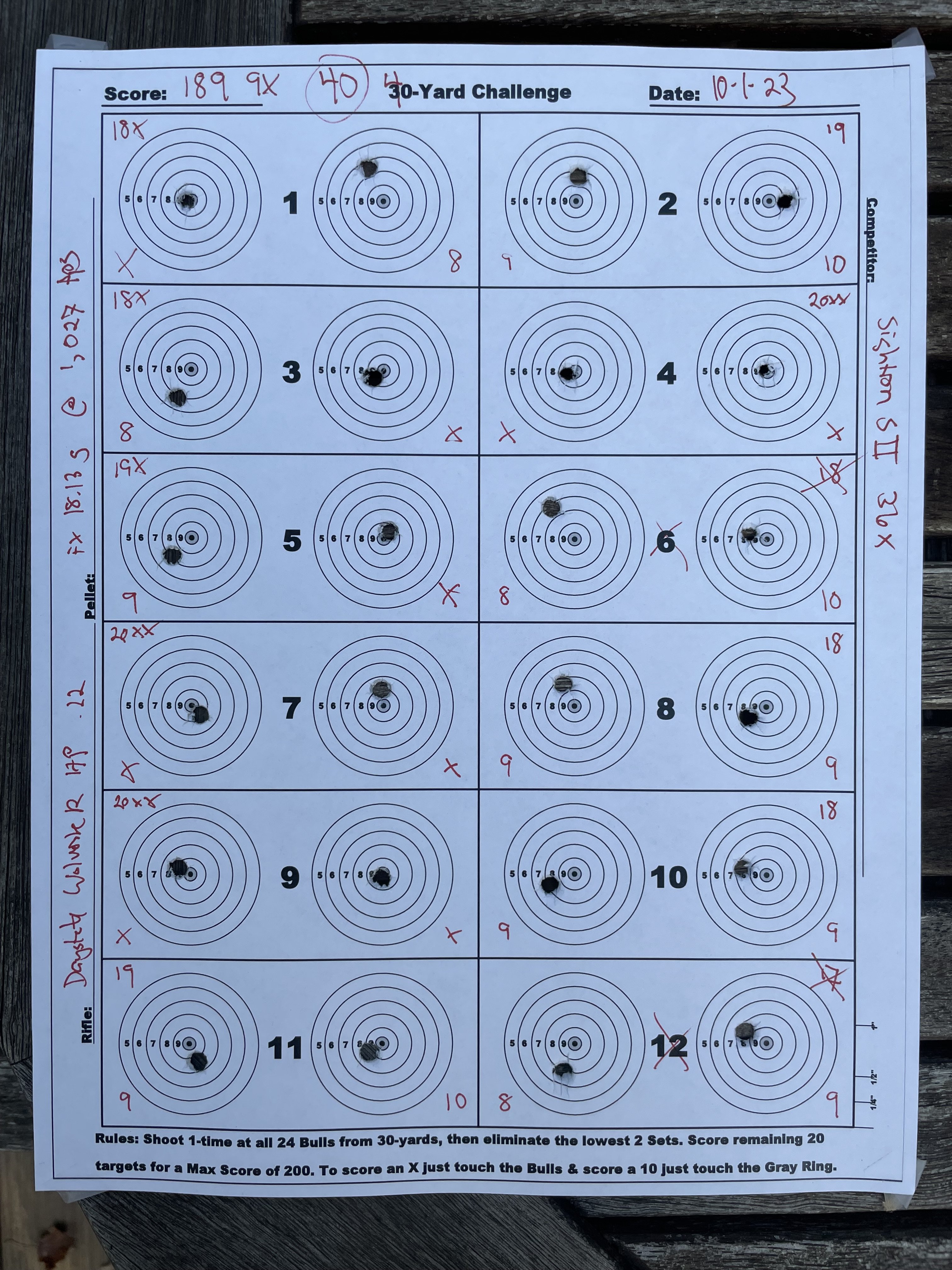

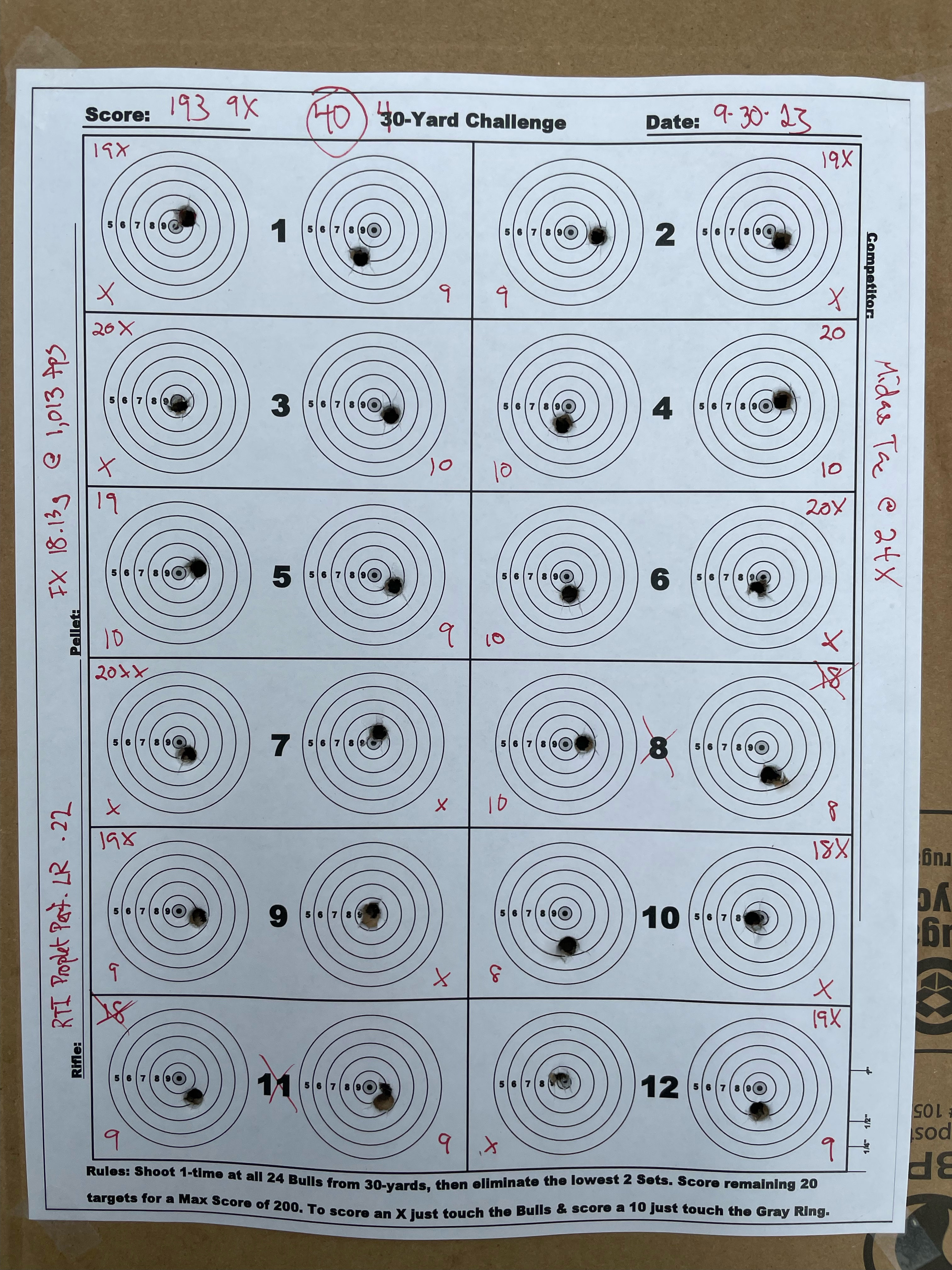

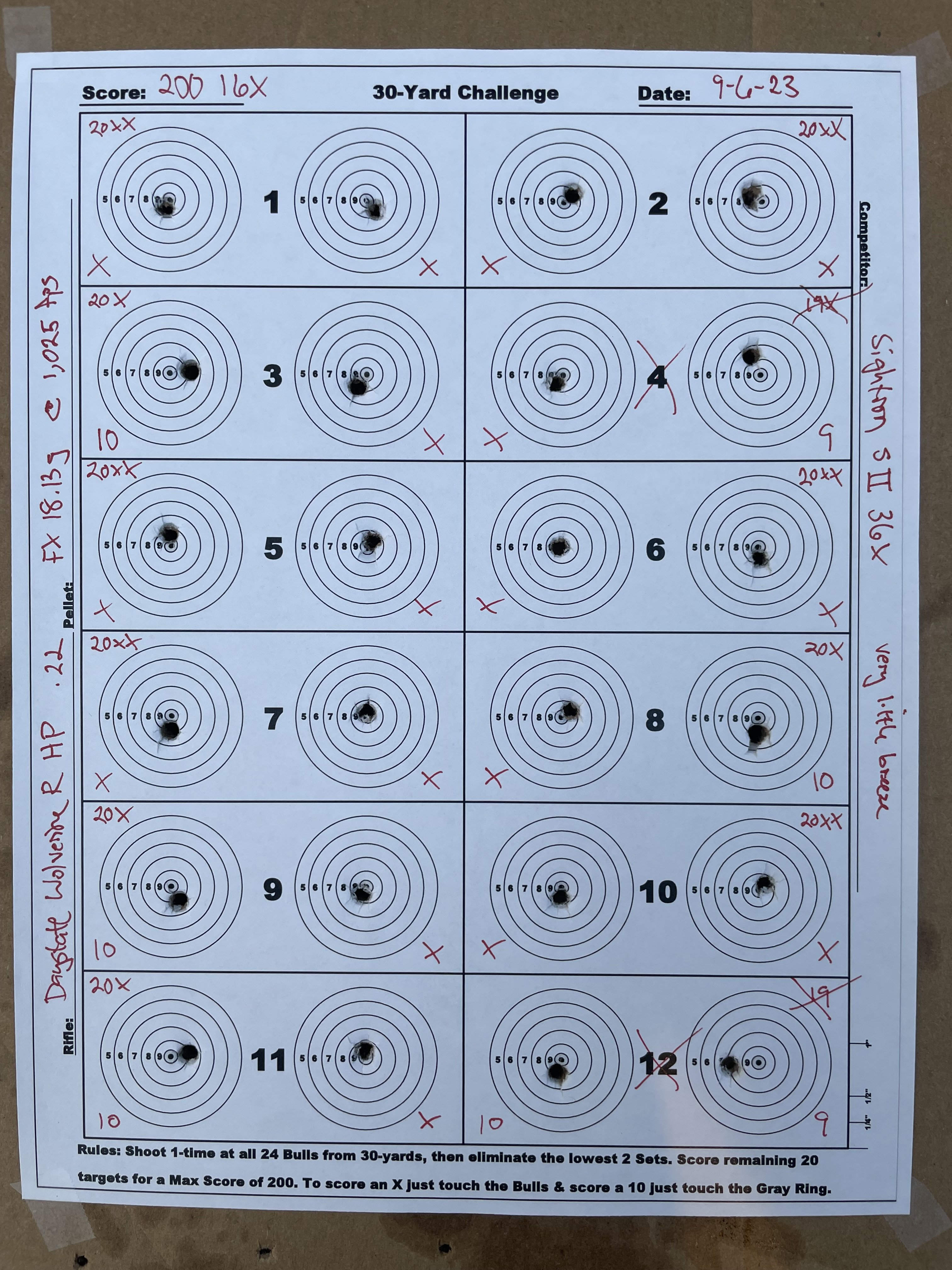

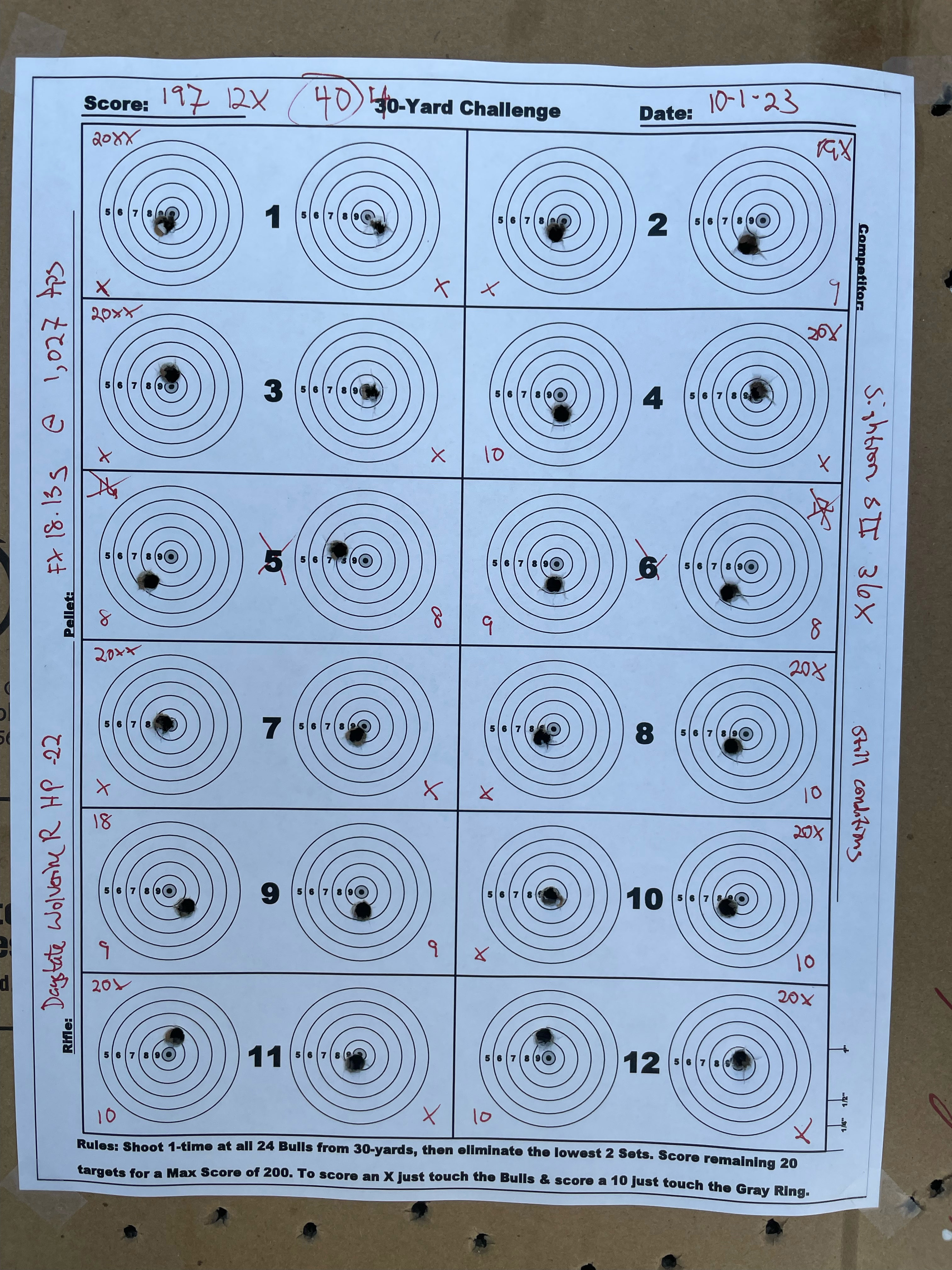

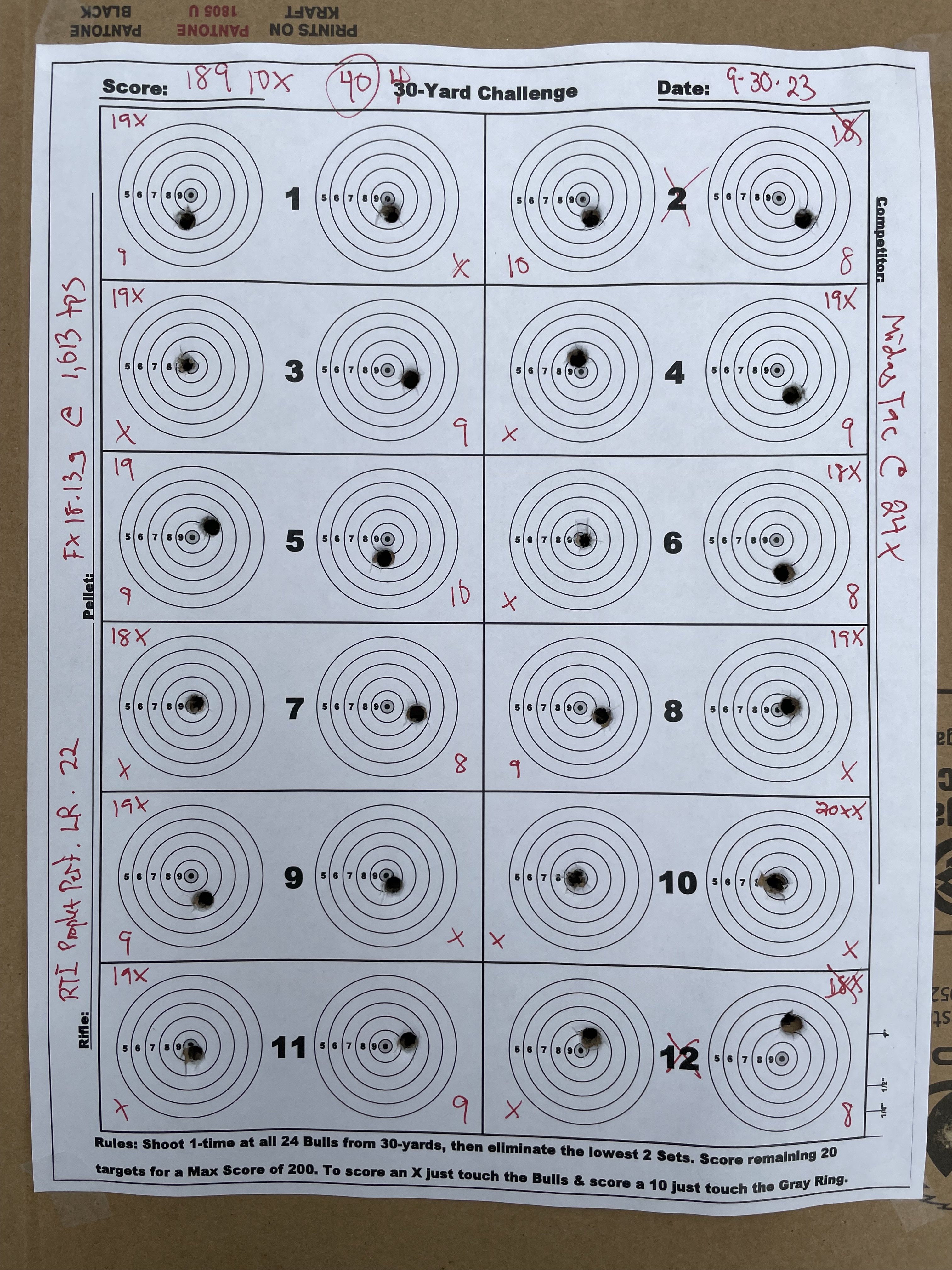

Attached are some results that show two rifles I have that show extreme accuracy with JSB 18.13g at velocities of 1,013 and 1,028 fps.
Daystate Wolverine R HP .22 and RTI Prophet Performance V1 .22 LR. Both rifles have Lothar Walther barrels with polygonal rifling. The Prophet’s barrel also has a slow 32:1 twist rate.
I am surprised myself. I am shooting 30 Yard Challenge cards at 40 yards. These results show scores of 189 to 197. I’ve shot 200 scores with both rifles at 30 Yards. (Edit - one of the attached is a 200 @ 30 yards shooting 1,028fps)
To put these cards in perspective, the X is 2/100” and the 10 ring is .125” in diameter.
So, as far as the 880fps rule, it seems to be a good accuracy guideline, but there are some barrels that will shoot the 18.13s accurately at over 1,000 fps. Freakin Wolverine shooting 197 at 40 yards blew my mind.
-Ed
Hi Ed,
None of the 40yard cards you posted score a 197

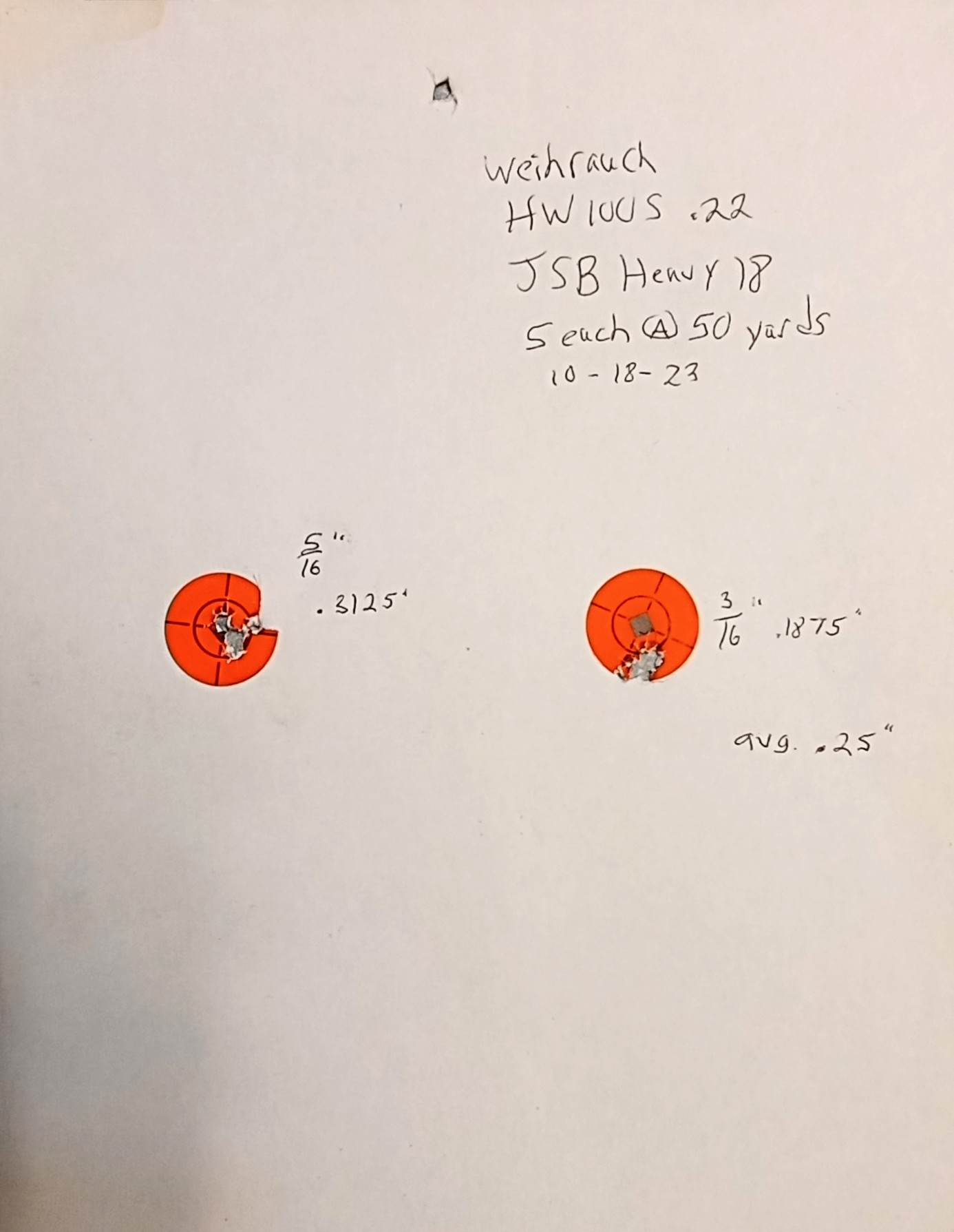

Phil - excellent accuracy at almost 1000 FPS for the 18.1 for the HW100 50J power platform.
I posted some groups on another thread for my HW100 .22 Carbine at 850 FPS at 50Y. Shot eight 5-shot groups with average .61” CTC.
It appears from the responses and information contained in this thread, that at 50 yards and less; there is a fairly large acceptable range of velocity from low 800’s to a bit over 1000 FPS to achieve good accuracy with this pellet.
