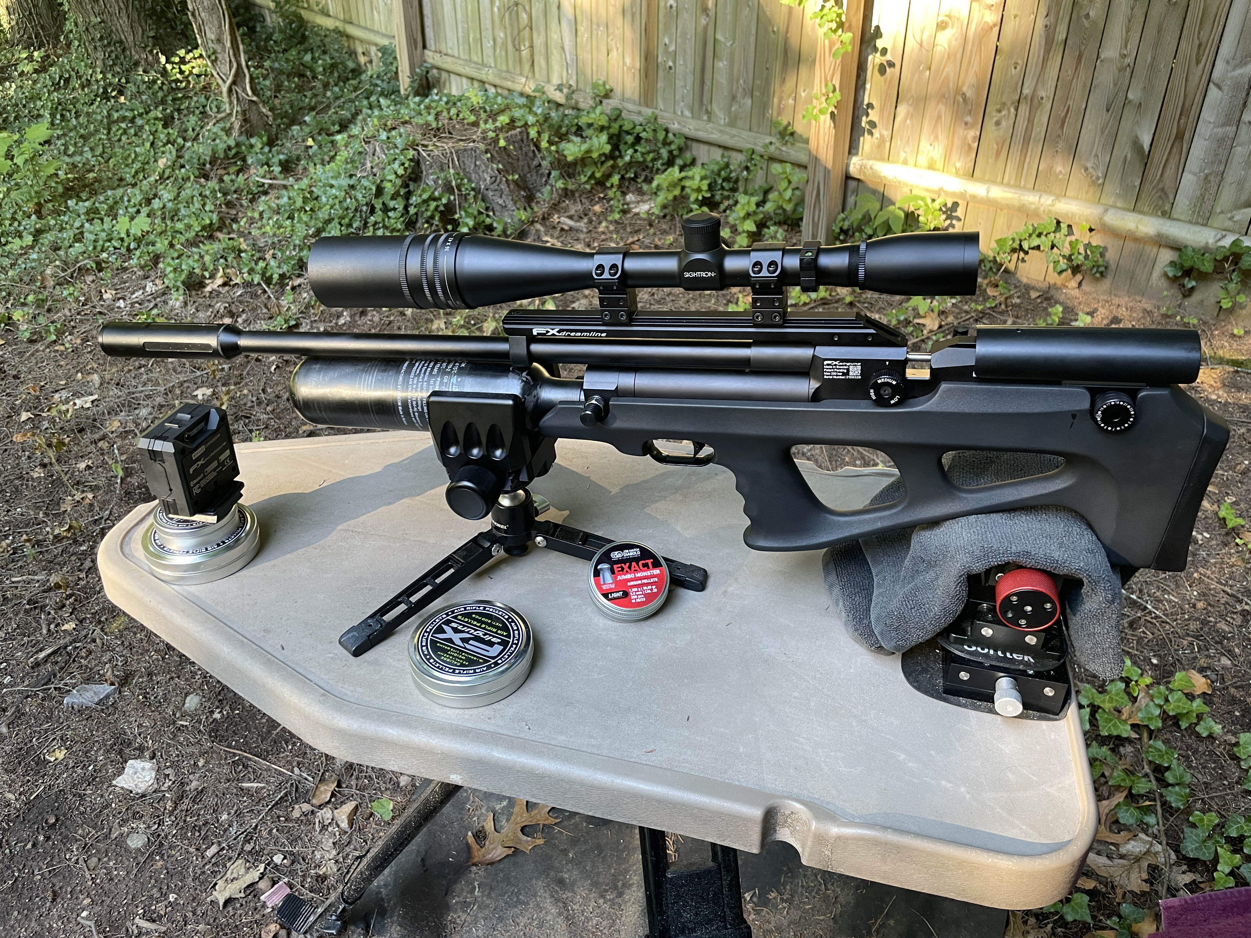

Test bed is this BRK Ghost.
Reg pressure of 150 b/c it’s set up for .22 Monster Grands and I didn’t feel like lowering the reg pressure for this short test of the Lights. Power wheel on MIN. Barrel is an OEM Ghost barrel. 5 groove polygonal rifling in a 1:30 twist rate. Choked and 23inches long.
First order of business was to gather some speeds at the muzzle. 12 shots over the chrono and those 12 are in column A in the screen grab of the spread sheet I’ll share here in a second. Average was 958-959fps, for about 42.5fpe. I had a larger extreme spread for the muzzle speeds than I’d like to see, likely an artifact of having a reg pressure too high for the hammer strike and this particular pellet. Also hotter than I wanted to test them, but didn’t want to drop the reg pressure so forged ahead at this muzzle speed.

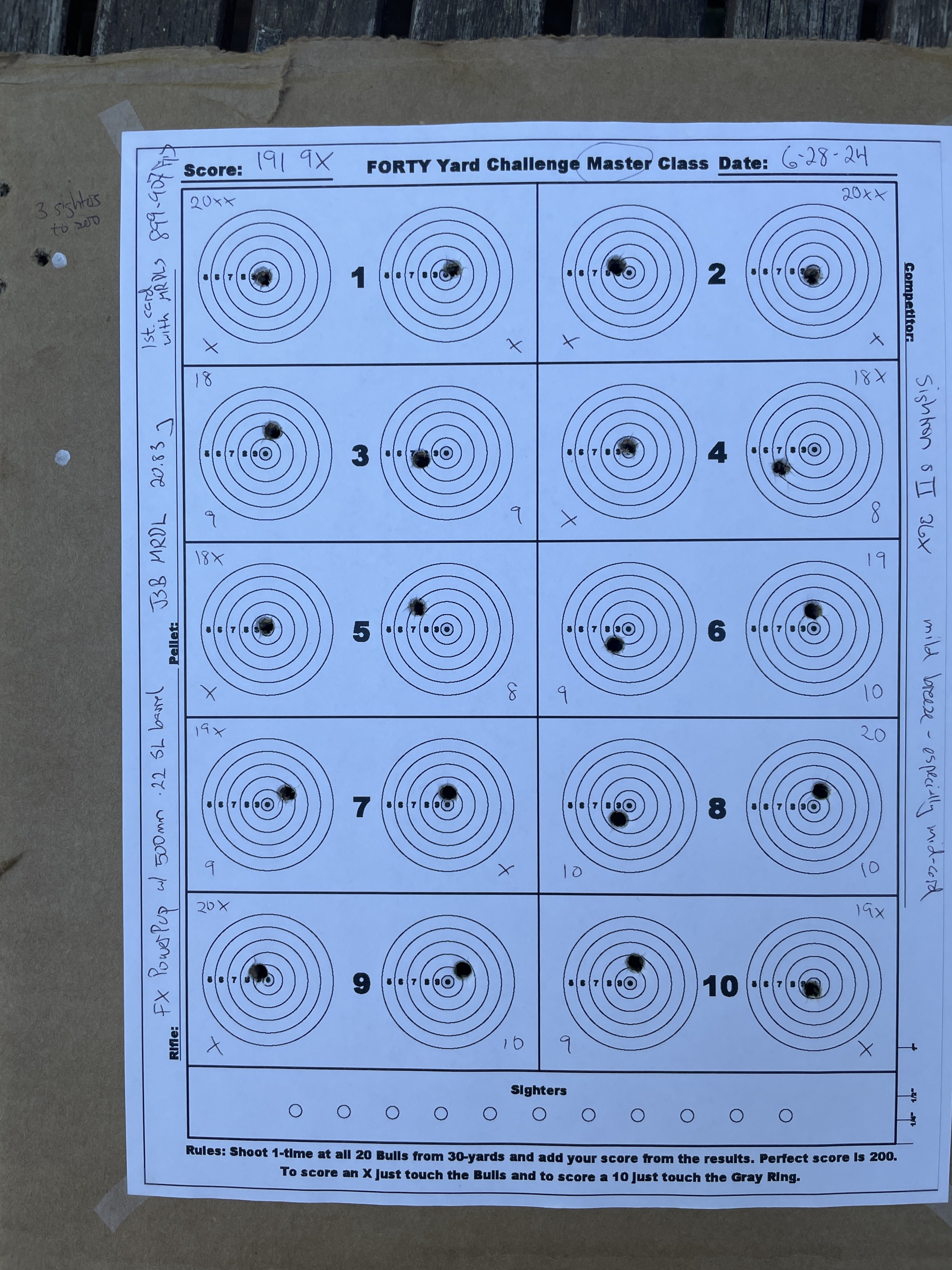

Rifle: FX Power Pup
Barrel: 500mm superlight (from a DL Classic)
Distance: 40 yards (lasered from front of bench)
Target: .125” (1/8”) diameter 10-ring
Pellet: MRDLs at 898-907fps
I have the rifle tuned for 18.13g in this config. I turned power wheel up 5 clicks from 18.13g setting, took 3 quick sighters and shot this card.
Very solid 40-Masters card - especially for the 1st 23 of a new pellet through the barrel.
Obviously, this is the only velocity I’ve tested for the rifle/pellet combo.
They also shot extremely tight at 40 yards from my Taipan Vet 2 at 915-920fps - but I’ve not shot a 40-Masters card with the TV2/MRDL combo yet.
Seems to be an easy pellet to shoot accurately from a rifle tuned to shoot 18.13s well - not a huge adjustment needed for the 20.83s - significantly less adjustment than MRD 25.39s require.

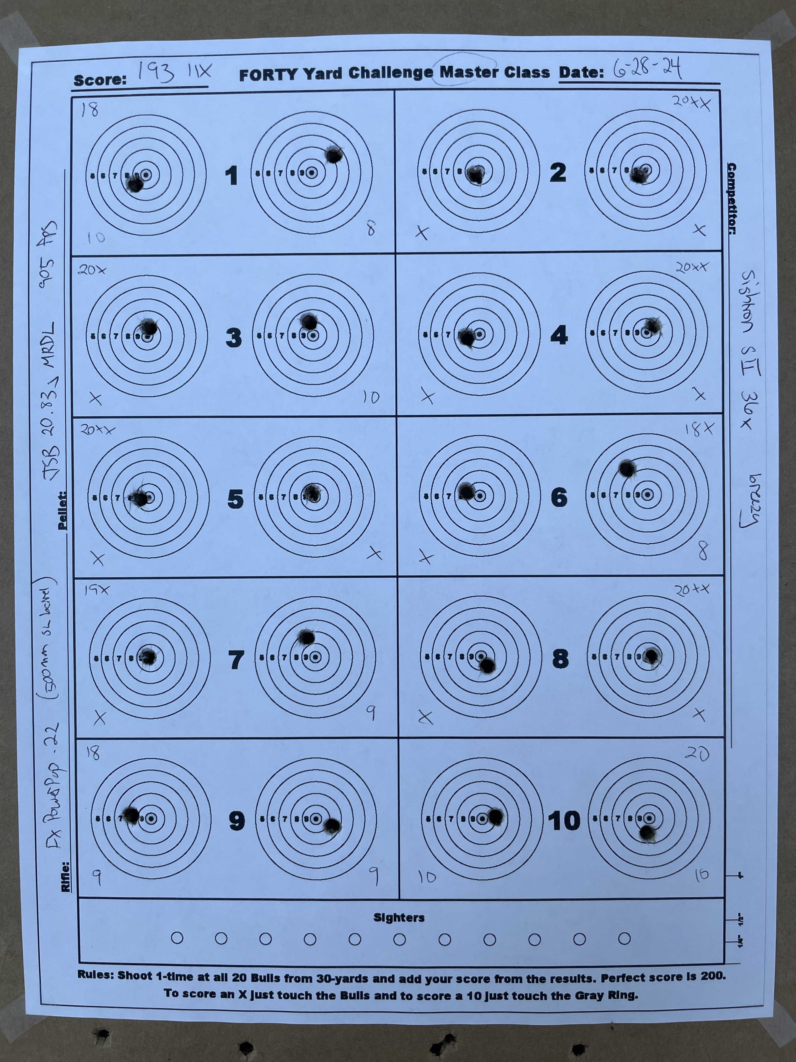

Yep, repeatable. This is the next 20 shots with the 20.83s - straight from the tin - no sighters between the 2 cards… and I missed a couple wind holds on this card - it was breezier than the 1st card.
I think these MRDLs could be a great 40+ yard pellet as an option from the 18.13s - without the huge air requirements of the 25.39g MRDs.

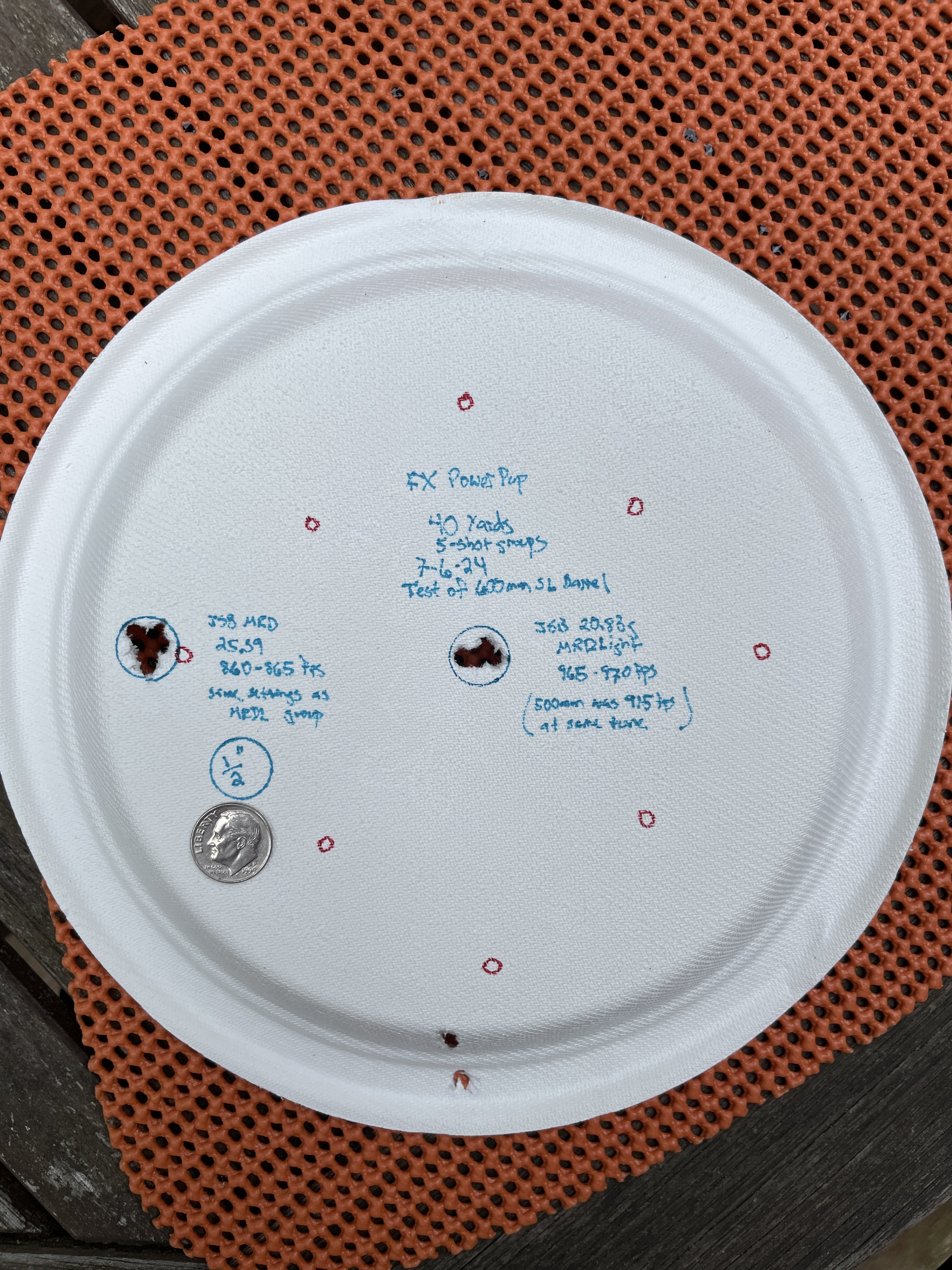

Then a 600mm superlight barrel arrived that I bought off AGN classified.
I swapped 600mm onto the PP and changed nothing (hammer spring or reg).
Took two zero shots and then shot 5-shot group with 20.83g at 40 yards - well under 1/2” edge to edge at 965fps.
Then took another 5-shot group with 25.39g MRDs as a comparison. Group was also under 1/2” edge to edge at 860-865fps.
So Franklink, my initial test at 965fps with the 20.83s is consistent with your experience - they seem to handle this high velocity well.
I’ve since been shooting 40-yard cards with the 20.83s at 910-920 fps (to save a little air). I’ve consistently been over 190, which is great for me.
Summary FX Superlight result with 20.83g:
500mm - 915fps
600mm - 965fps
Great accuracy at both speeds - even in wind that would challenge 18.13g.
