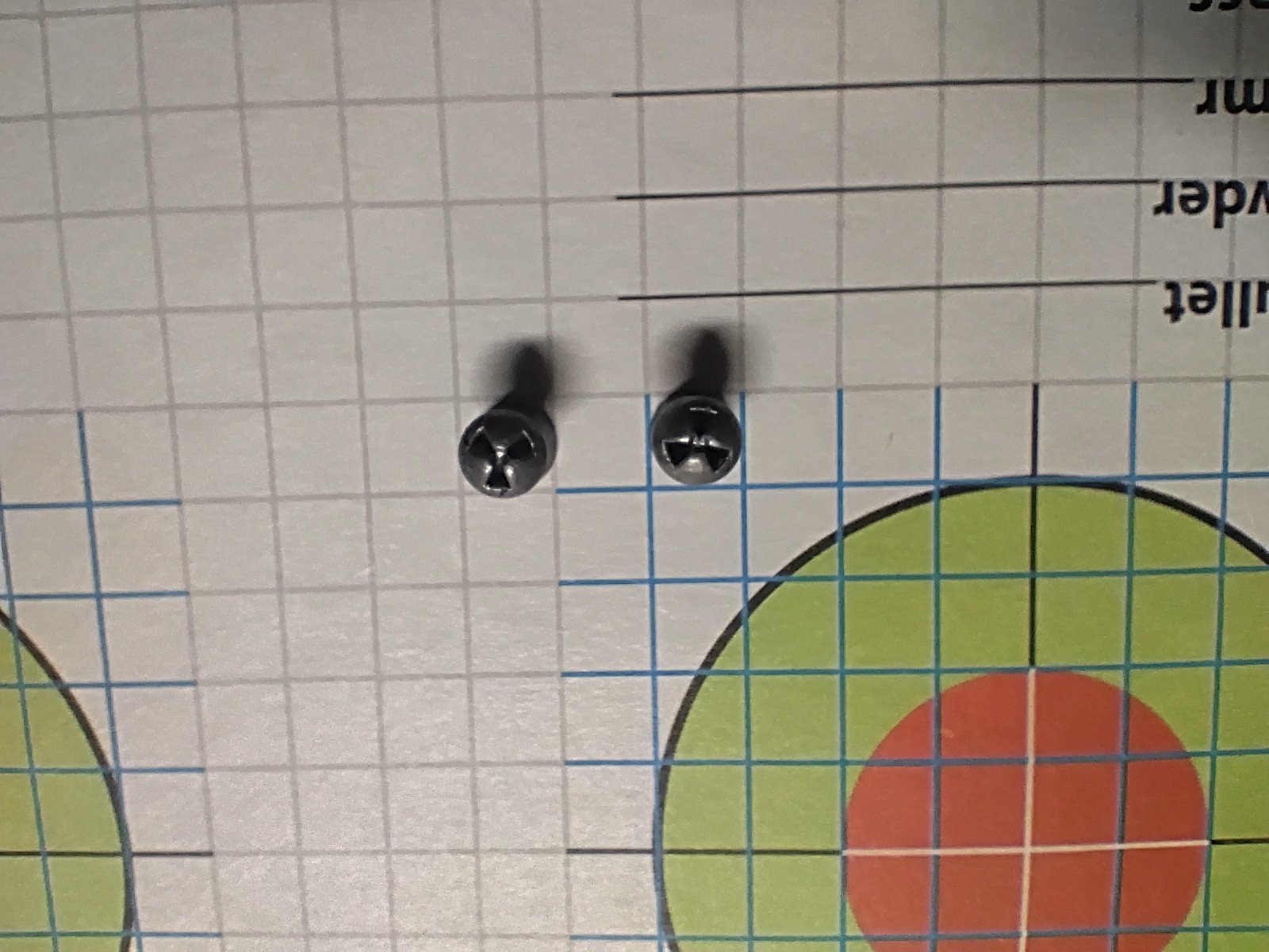

These atomics are ALL OVER THE PLACE. And it's driving me insane. Even as much as 2" at 10y. What in God's name is going on? It's not the gun because it shoots the JSB EXACT JUMBO, JUMBO HEAVY and JTS dead center 16.08s LIGHTS out. what on earth could be going on?
Has anyone else had this experience? I thought they were the exact same thing

Could be the differences in production runs. I have experienced similar results with both the JSB Hades/ FX Atomic in both .22 and .177. Pulling out some calipers for a quick measurement I discovered the Hades & Atomic to be undersized for my rifles.
The issue im having is Hades have shot absolute better than any other pellet in this particular gun. The atomics are acting like there are 4 distinct impact points. Exactly where it should be at 10y e-8.5 w0.0 , E: -12 W L5., E-10 w5 or e -12 w0.0. The worst variation I've ever had before this is with baracuda 15s being .5" slightly left at 25. This is insane.

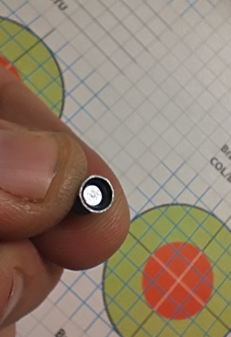

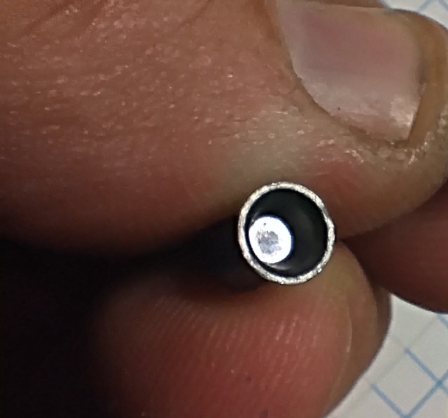

My issue was solved just a few minutes ago. I sort my pellets by Make and weight in a padded organizer. I was shooting this weekend at my friend and hunting partners house. I was outside and he ran in to fill off the compressor. And he knocked the organizer I had brought off the table. He picked them up and saw that there appeared to be 2 different pellets only. So he placed them in their respective spots. So he thought. I had JSB 15.9s, Hades 15.9s separated by higher and lower weight,, and FX atomic, done the same. He had no idea. So. I spent time weighting and could also differentiate by what I assume is the equivalent of the sprue... The marking inside the bottom of the skirt,, the flat part inside. The Hades shared the mark all 22 JSB exacts seem to have. A small slightly grey dot in the center. What I assume are the atomics have a much less distinct "sprue''. I separated.. lo and behold 2 distinct groups.
(Edit: I learned of this today during a phone call while informing him that his younger brother can still come, but will have to take turns with the gun I loan him because I was having accuracy issues with the gun I planned on letting him take on our squirrel hunt this weekend)

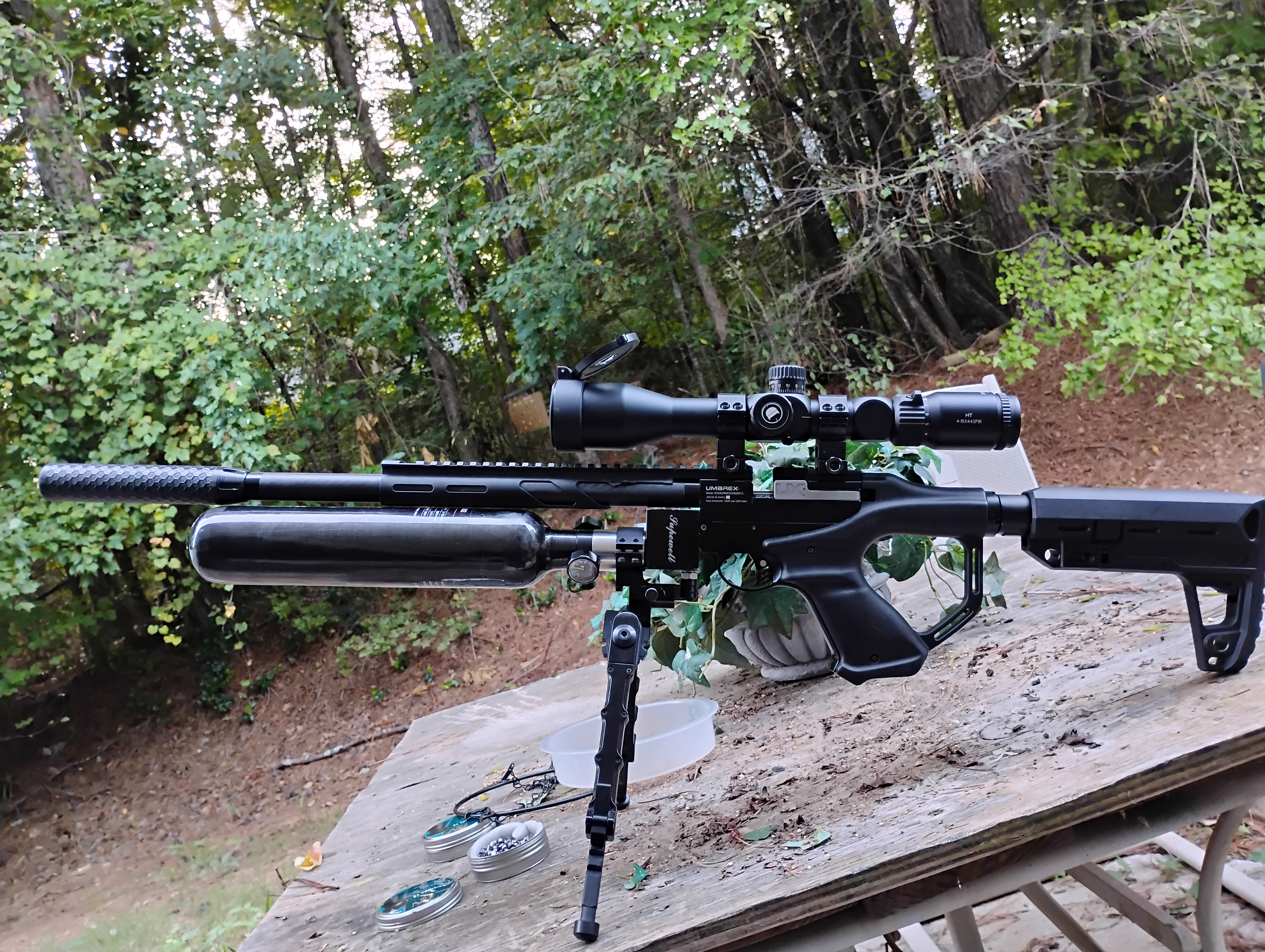

Not finished yet. Still have to decide whether I want to take of this rail again and replace with a dove to pic and back to the cantilever mount. The buckrail pp750 ar grip and stock mod, 1913 mount and folding AK74 triangle paratrooper stock and I will call it done.
