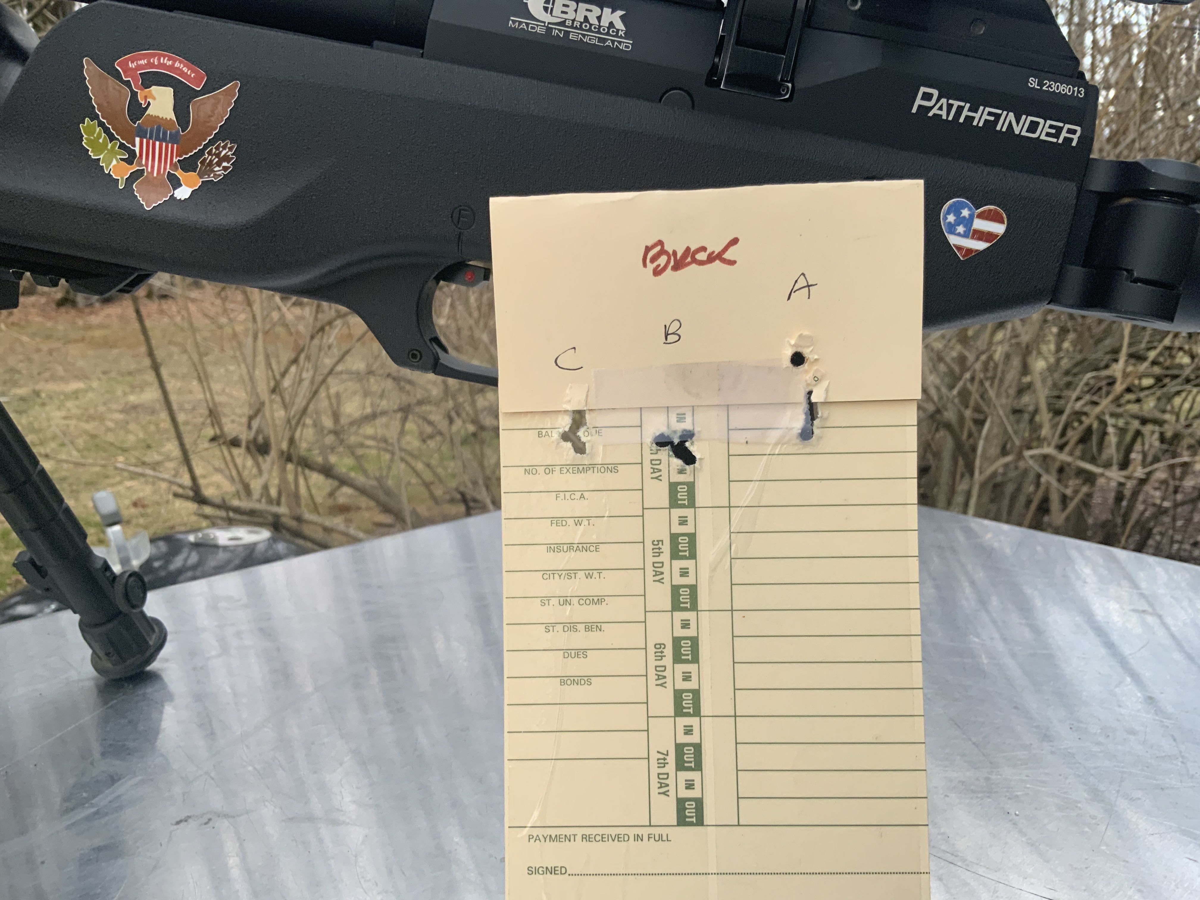

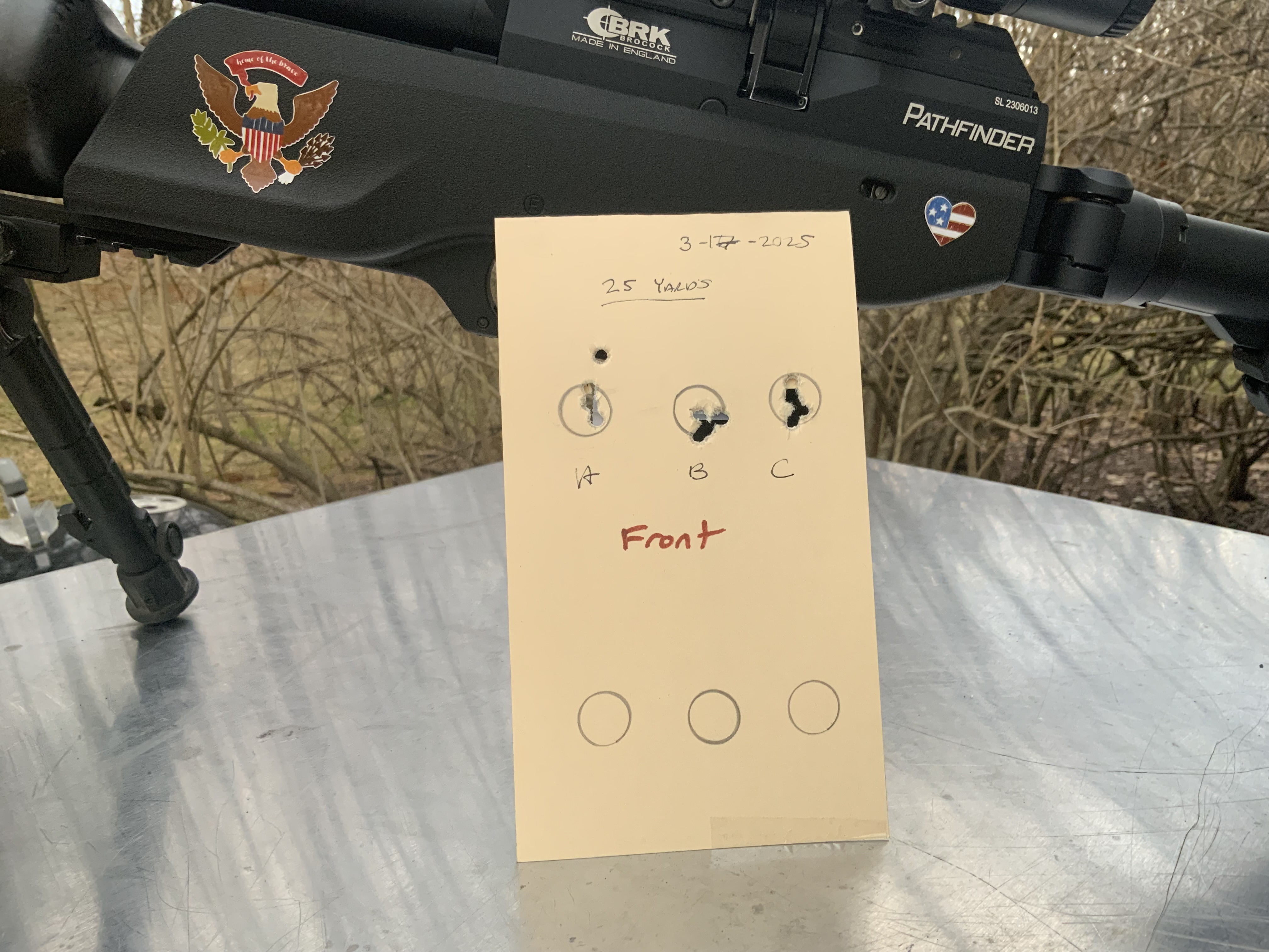

Pathfinder XR .22, three, 5 shot groups, casually and quickly sent after work. Bipod front, shoulder as rear bag. The CPHPs were sent with the TP on low. The JSBs were sent with the TP on high. Wind was at 10 mph, gusting to 25 mph as per my weather app from my left. I took an image of the front and back of the target… On group A the wind got ahold of that last high shot. Groups B and C were shot quickly during lulls in the wind. As you can see these groups equal dead pest at 25 and 50 yards. Particularly when sending with deadly intent…
Group A = CPHPs
Group B = CPHPs
Group C = JSB Exact Jumbo 18s
The following chrono numbers show how closely these two pellets are shooting out of my Pathfinder. Excepting for the higher FPE of the JSBs…
Group A = CPHPs
Group B = CPHPs
