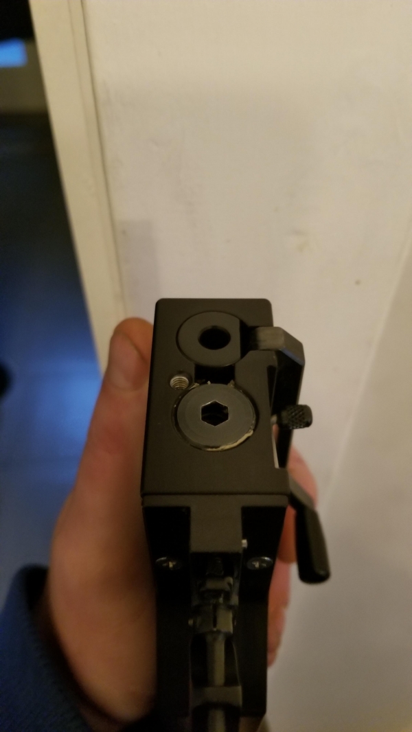

Without a chrony would be tricky to tune it, but i would lower speed by turning the hammer spring adjuster counter clockwise (unscrew) 1 full turn.
Its a 5mm and most are threadlocked from factory and might need heat. You can use this as your power control. It will give you adjustability of power for each reg setting.
That said, if youve never adjusted anything youre probably around 35fpe now with the stock settings. So maybe try a full turn up take some shots then do a full turn down.
If you want more power, you can get the SHP valvepin complete, valve seat and hammer weight from the Royale 500 and increase reg pressure then you should get 40-45fpe. I have a Royale 500 and bought the pellet probe, guide and barrel from a Royale 400 so I can swap caliber I got 45fpe in .22 using the 400's barrel. It's a fantastic platform, very easy to work on and incredibly reliable.
