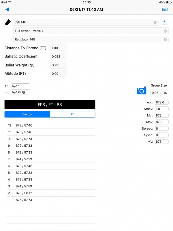

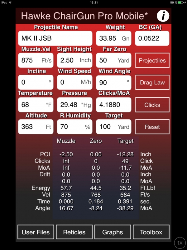

H&N Field Target Trophy 19.5gr - avg. 993 ft./s - shot horrible at 25 yards
EunJin Domed 35.8gr - avg. 800 ft./s - shot into one hole great at 25 yards, but terrible at 50 yards.
H&N Grizzly 31gr - avg. 850 ft./s - shot horrible at 25 yards.
H&N Crow Magnum 26.23gr - avg. 906 ft./s - shot into one hole great at 25 yards, but terrible at 50 yards.
JSB HEAVY 33.95gr - avg. 824 ft./s - shot into one hole great at 25 yards, into one hole great at 50 yards, and into 1/2" super great at 75 yards!
I am sharing the above data from the range today to illustrate my point that we have to shoot lots of different pellets to eventually find out what our gun likes the best. And also that just because our gun may shoot one kind of pellet lights out accurate, it may not shoot others worth a darn. Whether a particular brand of pellets shoot well or not may depend on many factors, so for those of you who want to save yourself a lot of time and money start your testing with the JSB line of pellets first...and you will probably be so thrilled with their performance that you won't have to look any further.
