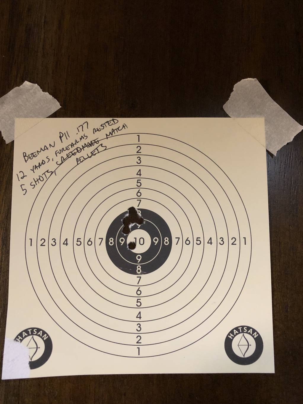

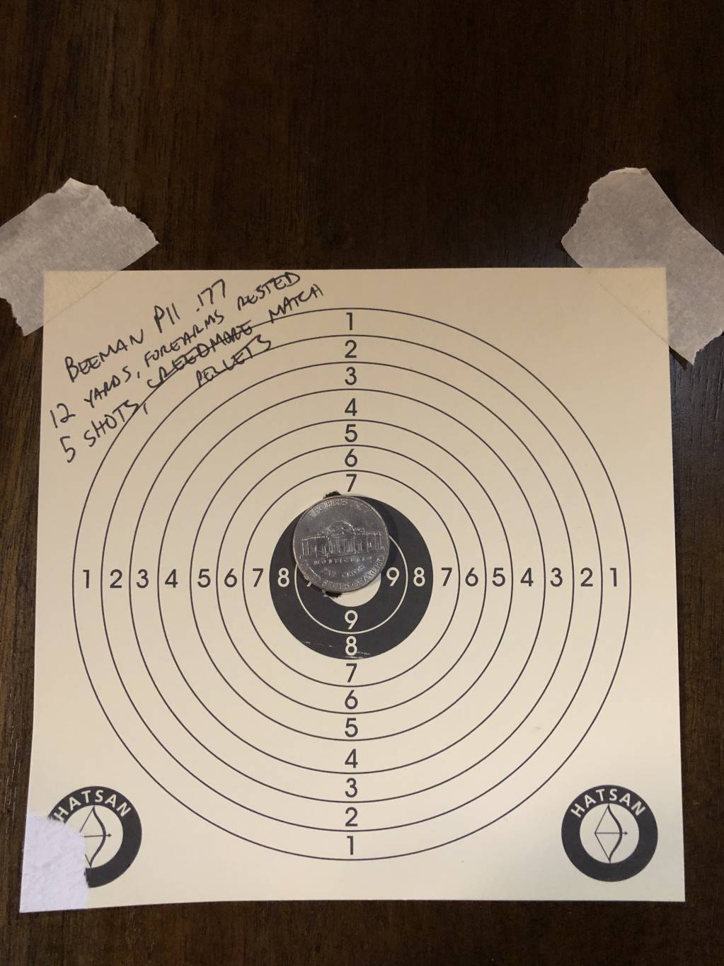

Thanks again bud, appreciate your thoughts on this. Speaking of clean holes, while this target paper isn't the best quality the Creedmore Match Pellets did a decent job.
You are producing as good a group with your creedmores as i can with Finale, or Falcon in my modified LP53 and you must be one of the finest shots of a 45 ....nice shooting and highlights what can be done if one learns to shoot a gun, learns what pellets it likes, and understands its foibles.

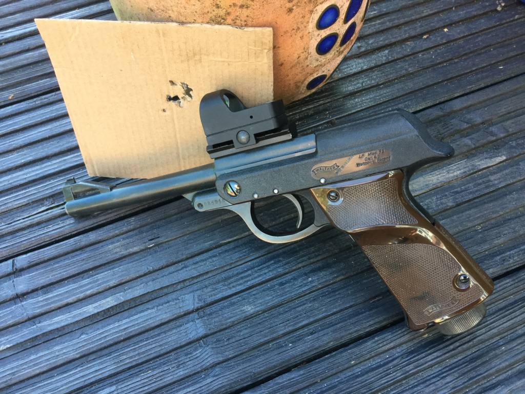

My effort at your 12 metres but not supported, shot with double hand combat grip approx 3/4 inch but first 3 shots went through same hole top right of group. Disappointed with that one at the bottom of the group, my last shot and was tiring. There are 10 shots in that group.
Velocity is 517 fps avg with 7.87 grains. Its dropped several rats.
Steveoo,
Looks like we use similar targets (whatever is available😉). Very tidy shooting, and 12 meters is farther out than my 12 yards. I imagine your pistol balances well in the hand but punished any inconsistencies in the grip pressure/hold technique. Love it😃. The rats would beg to differ.
