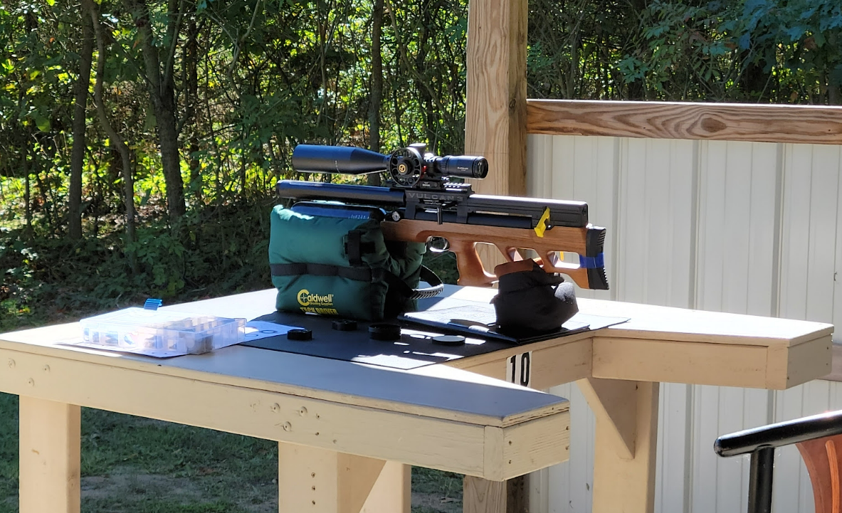

Happy with the FX 13.4's at 860 last weekend:
