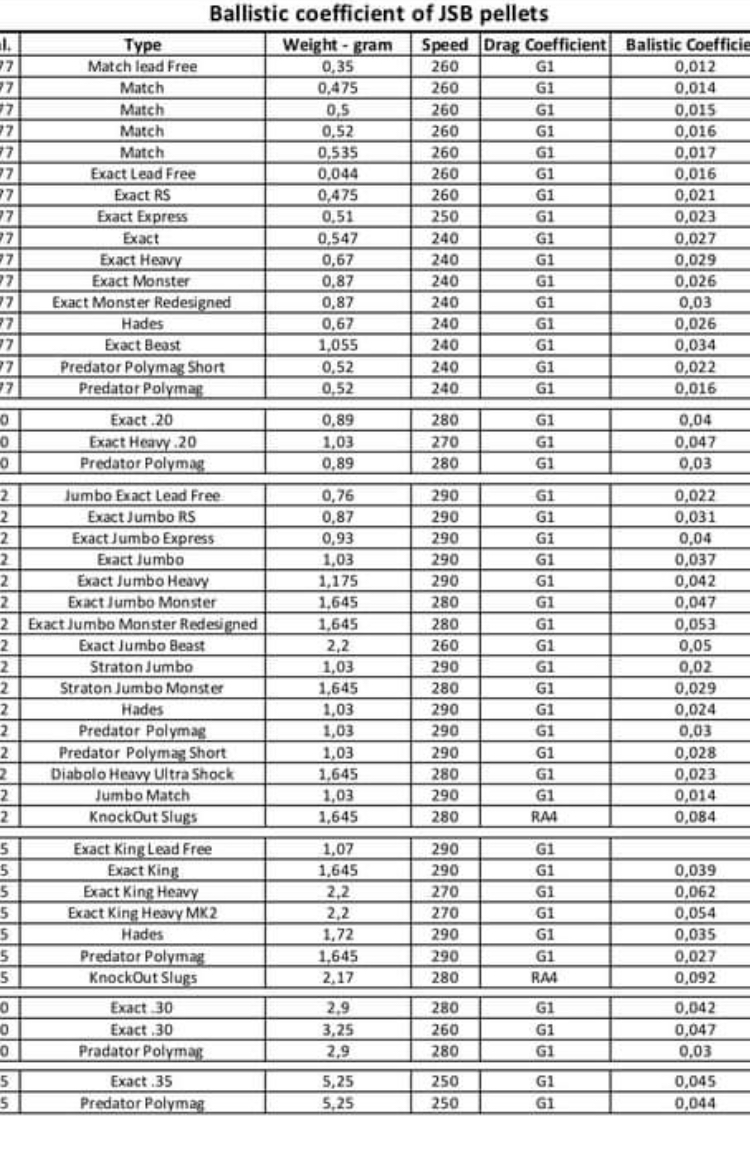

jsb speed versus in flight stability question

Your pellet has its best BC when shot between about 830 - 920
Interesting that none of the .177 shooters have piped in? Esp the hunter field target peeps.
I am seeing a trend here - 860 fps upwards to 910 fps. What this does is give me and others a starting point and that's really what myself and others might be looking for. I am surprised the pellet makers don't share some projected best speeds and favorite barrels by pellet type and weight?
800 to 900 fps generally, no matter the weight. Above 950 most start to have issues, but there have been a few anomilies.

Be careful when looking at the values on the JSB chart. They are using reference drag laws which are not suitable for pellets or slugs. For domed pellets they should be using the GA or GA2 drag laws which are specifically designed for pellets. There are no suitable drag laws for wadcutters or pointed pellets, but again the GA drag laws are probably best. There is a prototype drag law for slugs, but it needs more data and refinement. Most people currently use the G1 drag law for slugs, but it is not good at high speeds, hence the need for multiple BC values at different speeds. The use of the correct reference drag law should result in only small changes in BC at different speeds. Unfortunately, some manufacturers deliberately use the wrong reference drag law to give their projectiles artificially high BC values.
The main problem with the JSB list is that it does not give confidence that they entirely know what they are doing when it comes to external ballistic data and trajectory modelling.
