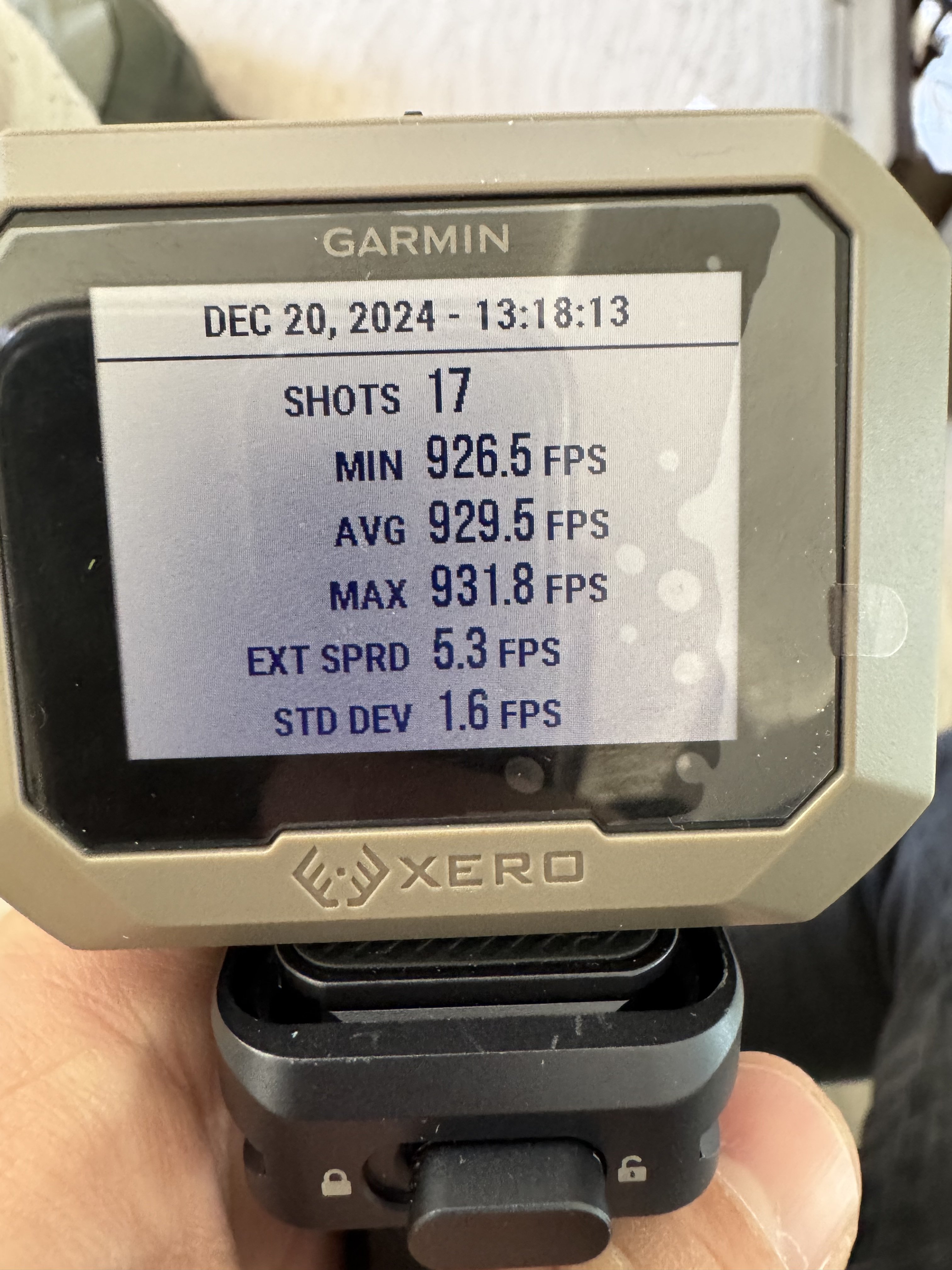

The AEA 45 gr .30 pellets have been amazing for me so far. JSB have been kind of inconsistent. Just shot this string with the AEA 45s today straight out of the tin with no sorting. Forgot to click ok on the chrono, so i missed the first 3 shots, but you get the idea.

My MA2 .30 didn't like AEA 45's at 1st. Did really well on JSB's. However, after several hundred rounds of breaking in the rifle, I decided to try the AEA again. Much to my surprise they are shooting very consistent now. If it stays this consistent, that could save me some money, and I may try the AEA 50's.
