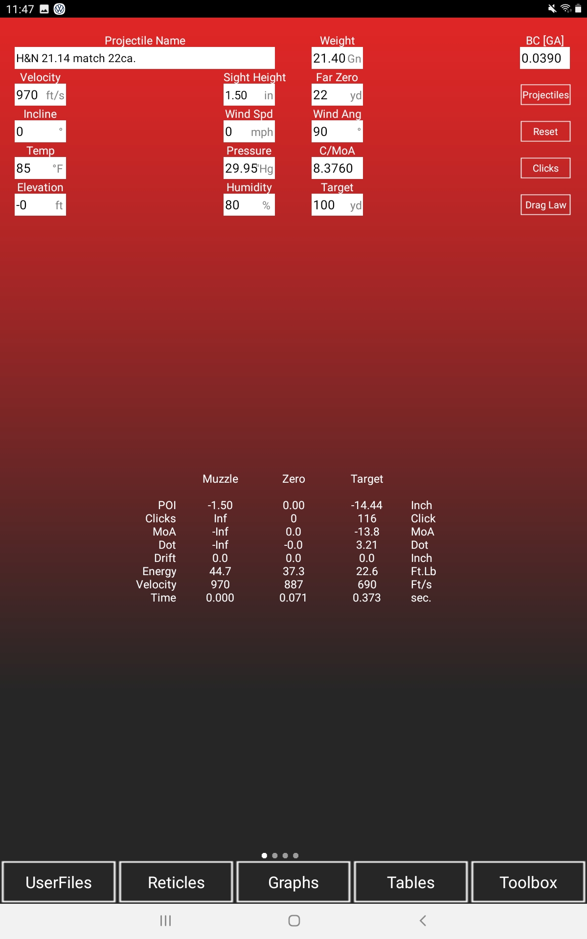

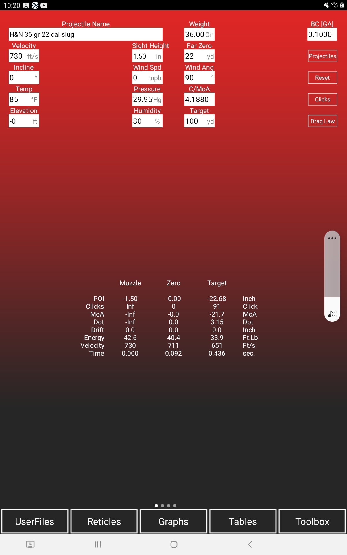

I have my JTS Standard in 22 cal pushing 44 plus ftlbs using H&N match pellets. Also tested 14.3 grain 1050 fps and 14gr H&N sniper light pellets at 1100fps. I tested 36 grain slugs at 730 fps Giving over 30 ftlbs at 100 yards. No need for 25 cal here. I would love to adapt a adjustable pressure regulator to the standard. To boost the slugs speed.
