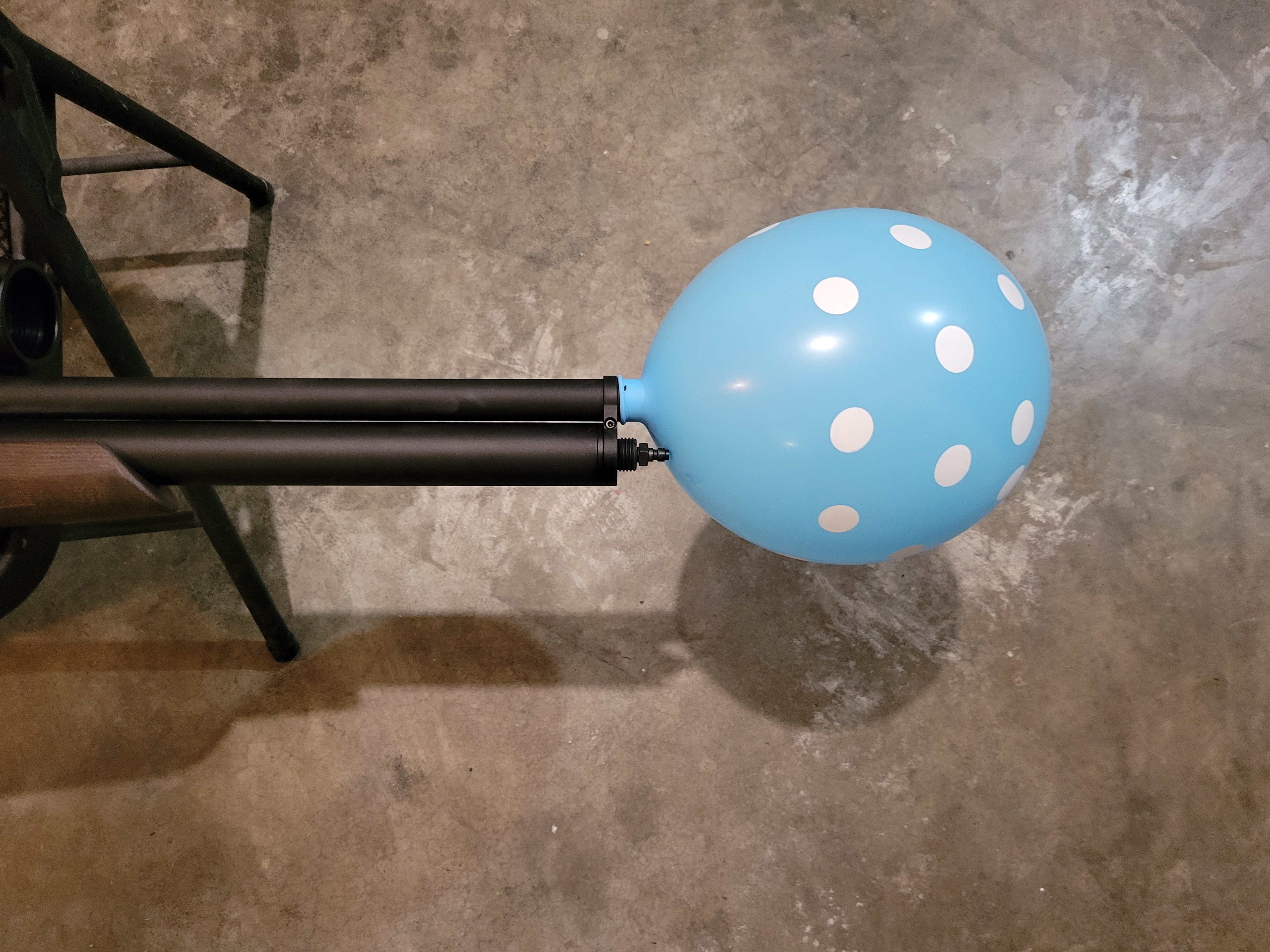

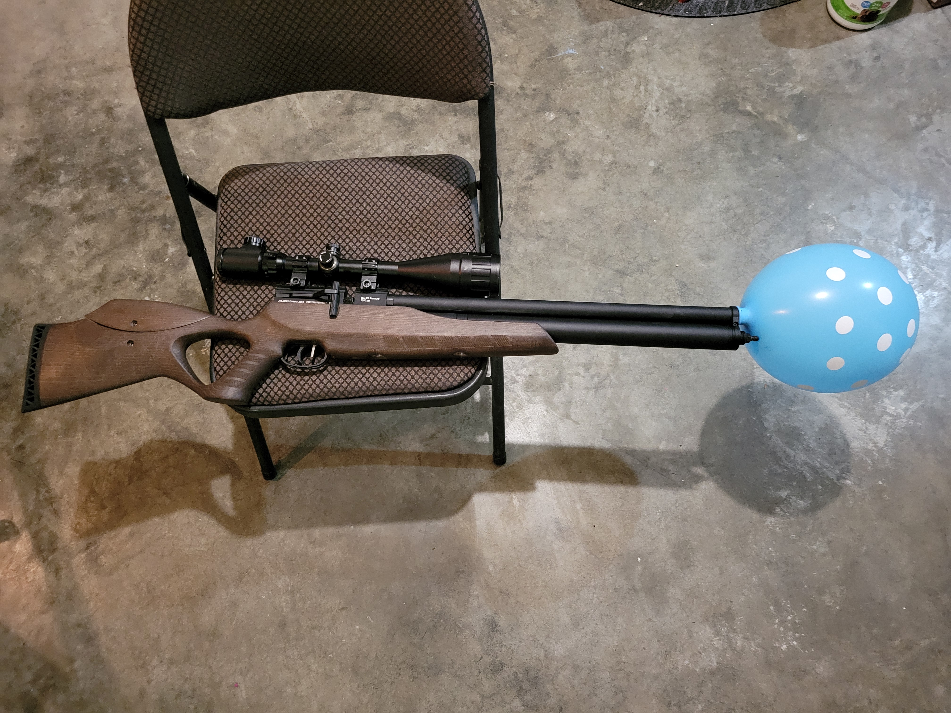

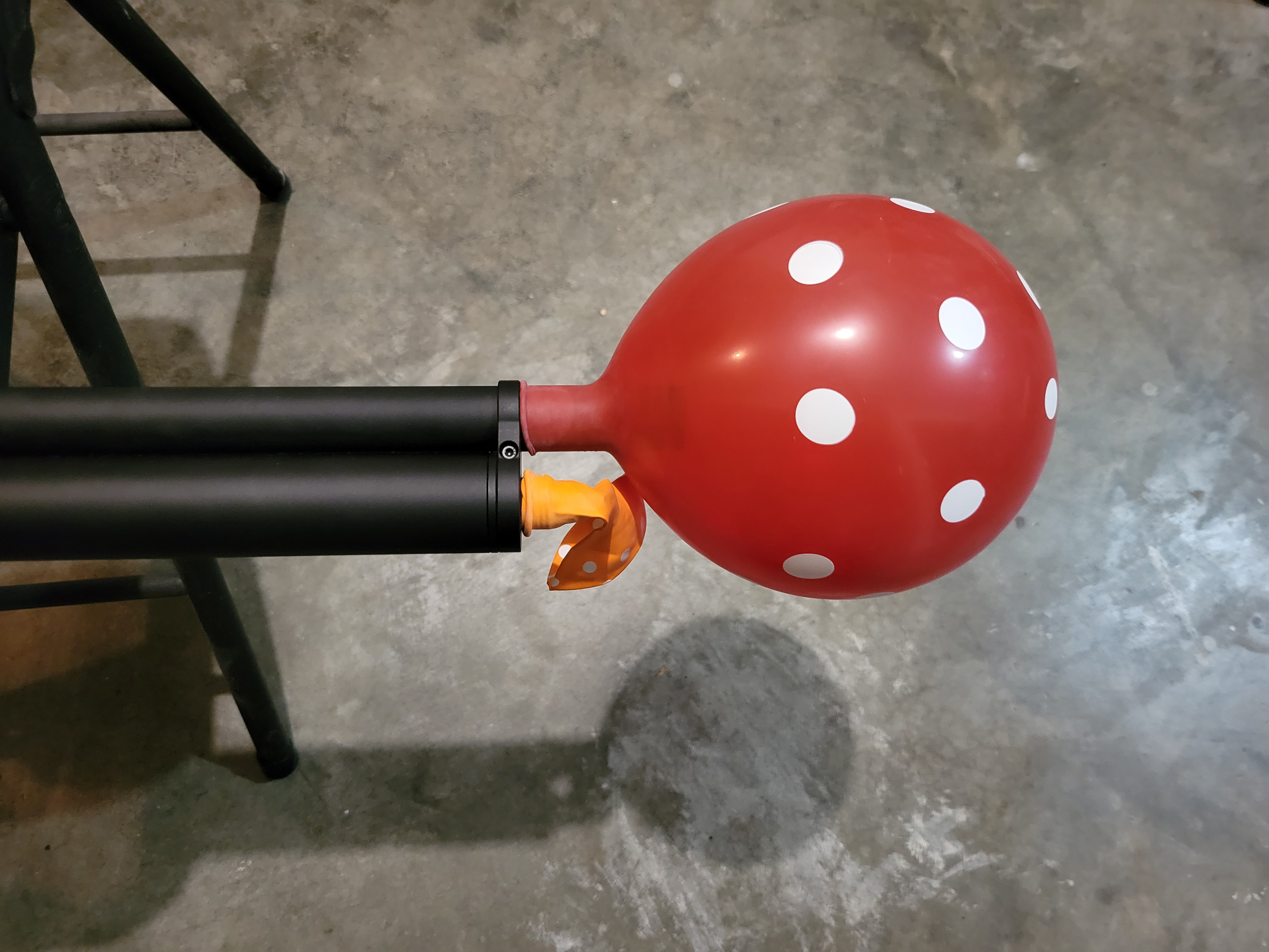

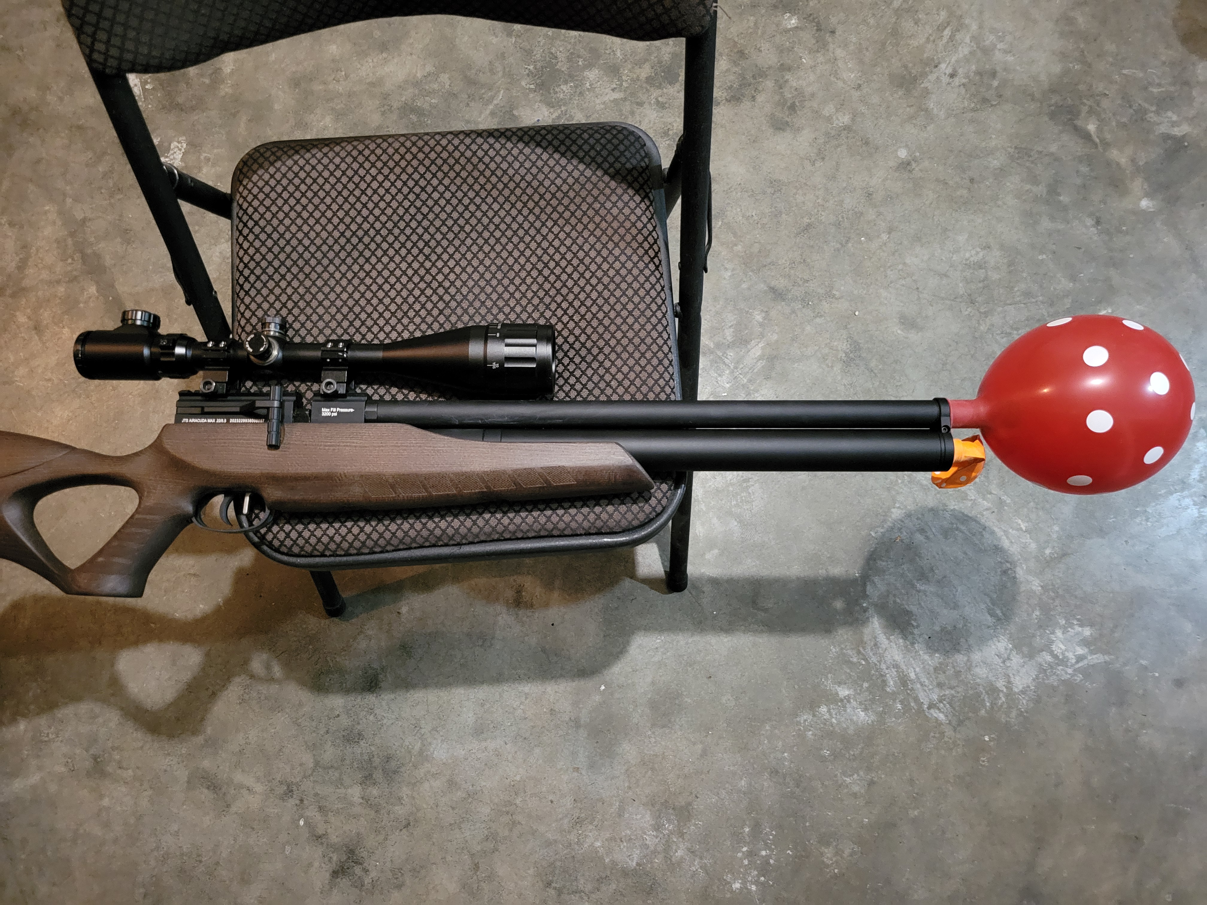

Not even one week old and my JTS Airacuda Max really likes to inflate those balloons.
The proof is in the photos bellow.
For some reason the 100% positive youtube reviews do not show Airacuda's balloon inflating abilities.
Those youtube reviewers don't know what they are missing.

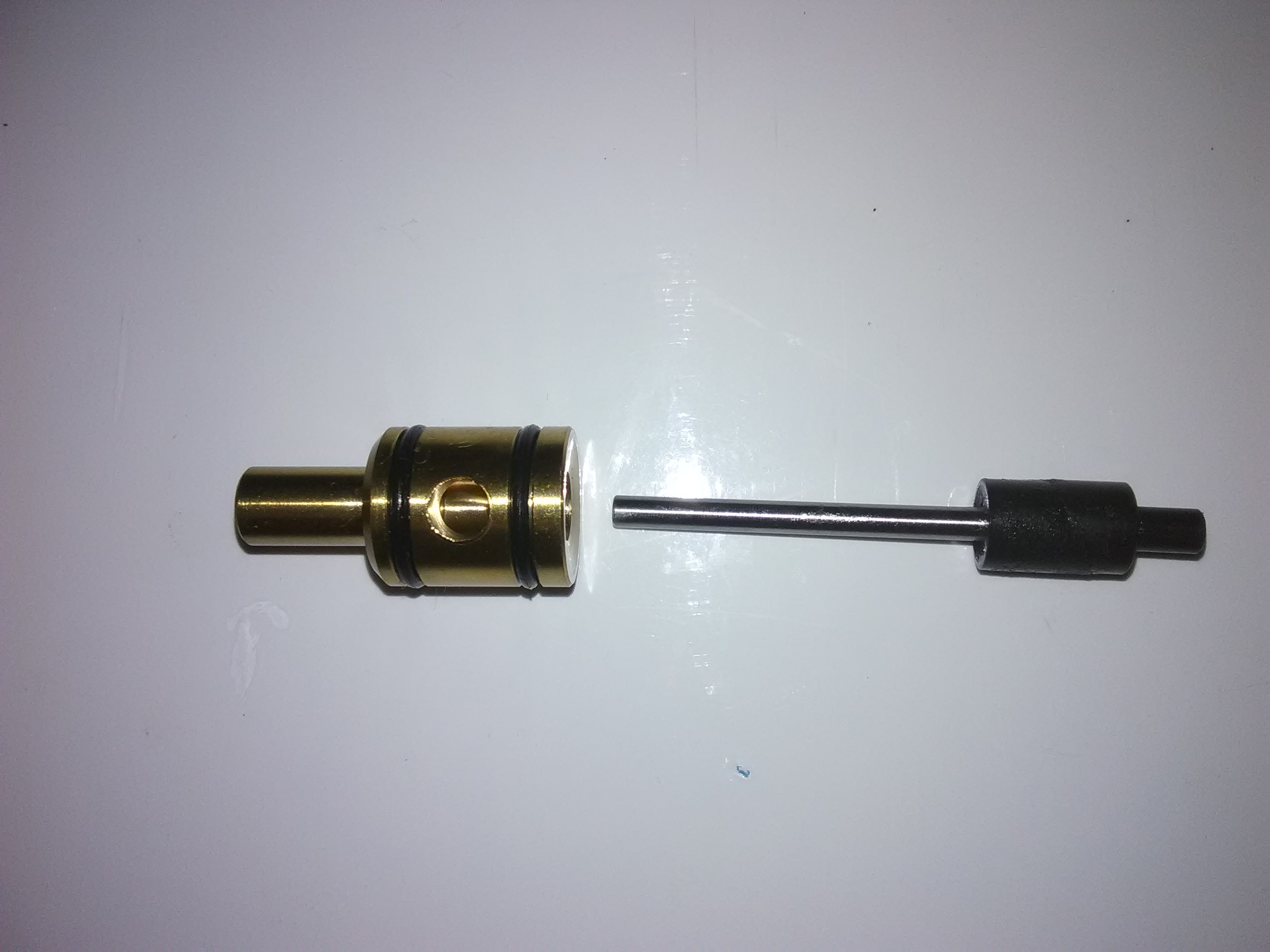

E-mailed [email protected] for two poppets and the brass insert, all no charge, under warranty. Sent brass insert by mistake but let me keep, that's original one in photo, new one in MAX. WM

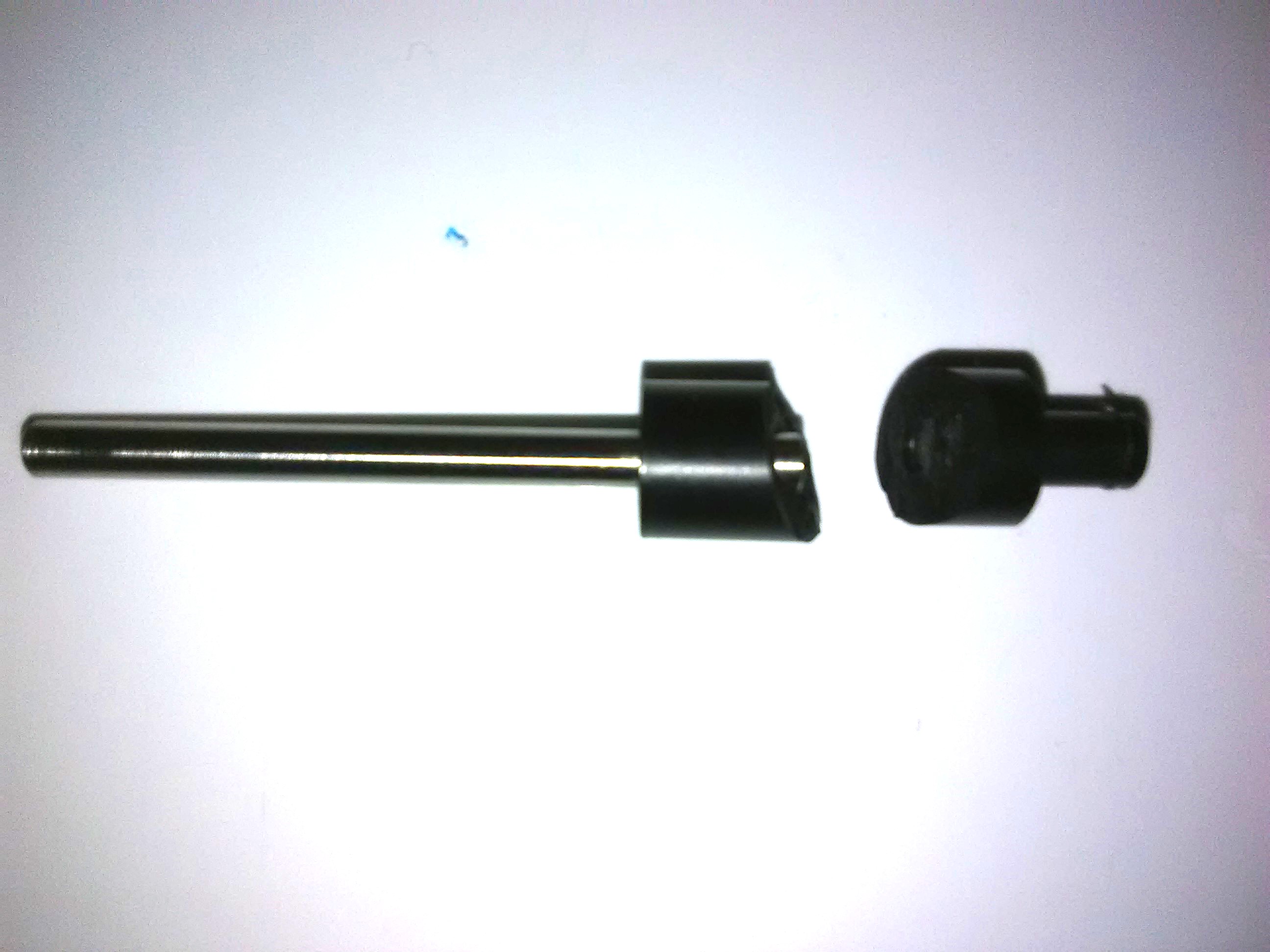

Opposite for me, after broken valve (picture,) reviewed 45Bravo's video, think his was at 18.9 mm. Mine was over 20mm and promptly broke replacement valve when re-installed @ 20mm. Next valve OK with setting around 18mm, IIRC. Nervoustrig mentioned sister platform to Airacuda, Dynamic Air Rifle, had addressed similar self-tightening problem of this spring. I think protruding edge of spring "digs" into plastic valve body, causing movement during use. I've installed thin SS washer over valve knob, between spring and valve body, in case this scenario is accurate. WM

Opposite for me, after broken valve (picture,) reviewed 45Bravo's video, think his was at 18.9 mm. Mine was over 20mm and promptly broke replacement valve when re-installed @ 20mm. Next valve OK with setting around 18mm, IIRC. Nervoustrig mentioned sister platform to Airacuda, Dynamic Air Rifle, had addressed similar self-tightening problem of this spring. I think protruding edge of spring "digs" into plastic valve body, causing movement during use. I've installed thin SS washer over valve knob, between spring and valve body, in case this scenario is accurate. WMView attachment 507725
