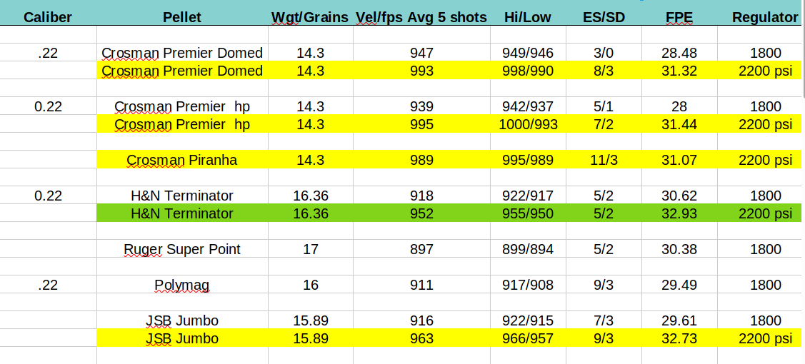

Hello @Mufasa
I am shooting the Airacuda MAX .22 cal and getting 30 solid shots per fill. I am a bit conservative because I only fill to 3,000, not to 3,200, and shoot down to around 2,000. Accuracy is very good within this range.
ThomasT

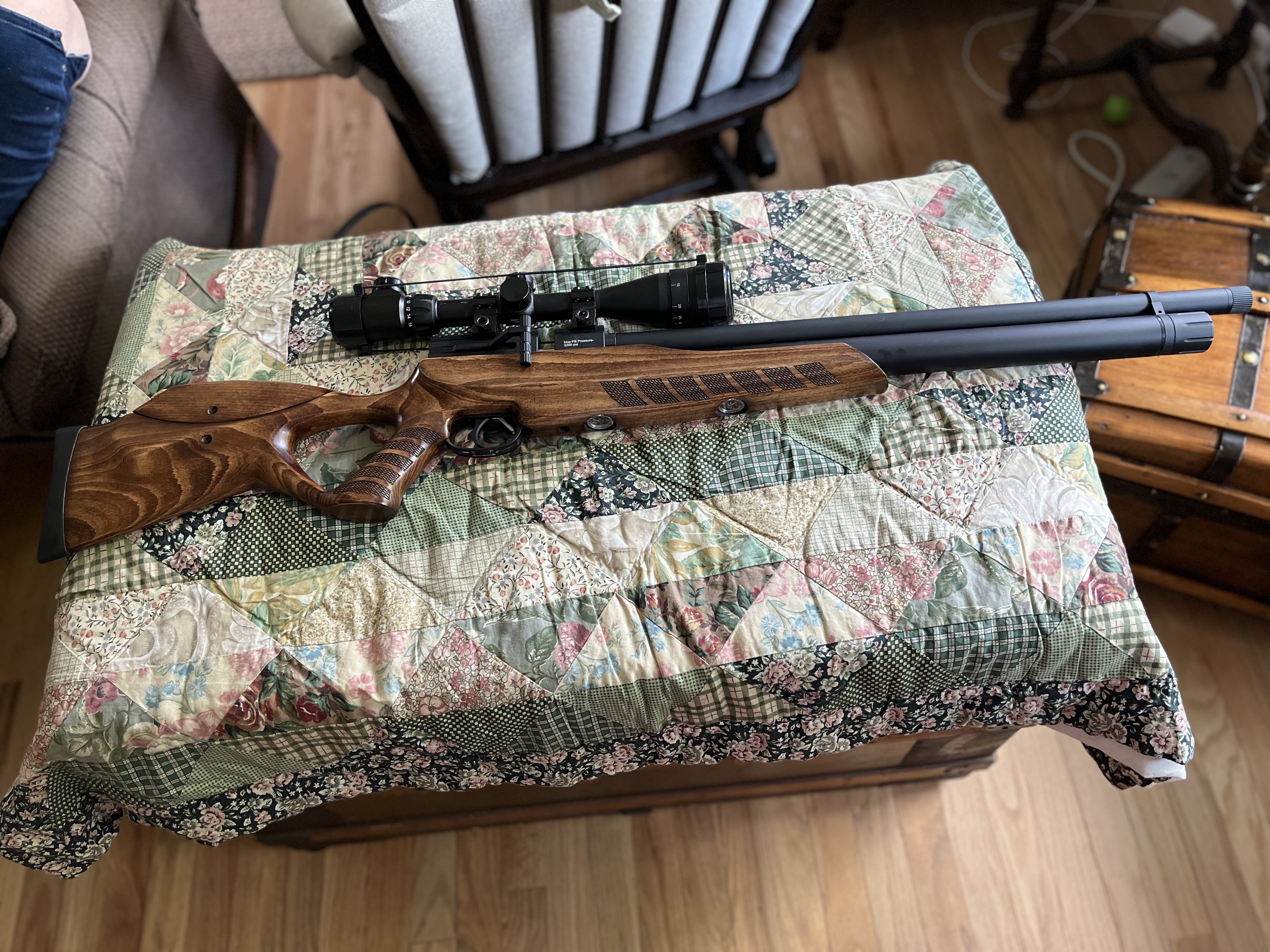

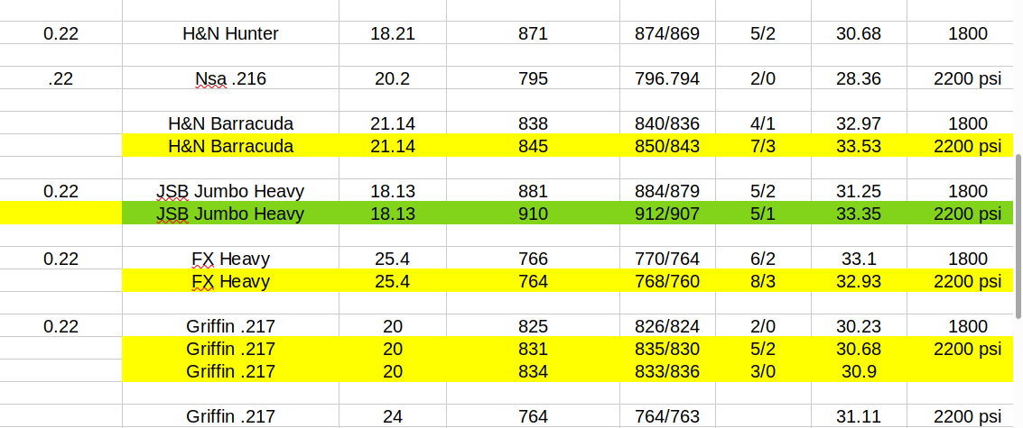

My .22 max

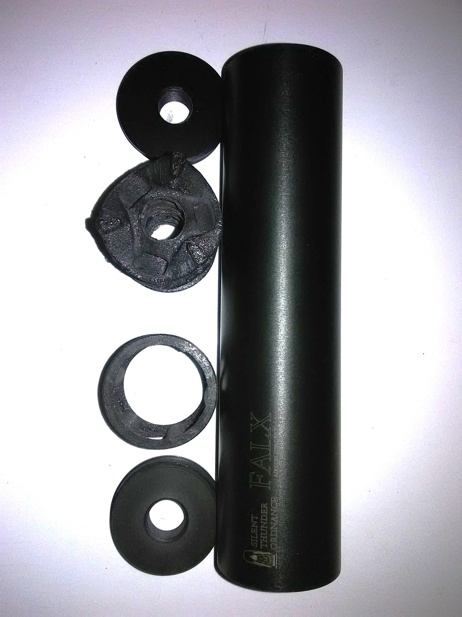

Combining least out-of-round shroud end with $50 DonnyFL adapter, found consistent accuracy, at the cost of sound moderation. Photo depicts only moderation success not affecting accuracy. Seven-inch .30 (STO) FALX shell, with plastic internal section, drilled to .50, from 4" (STO) PUGIO .30 moderator, with M14 (1/2" opening) exit end cap replacing OEM .30 one. Initial testing positive for good sound moderation with accuracy. Still jumping thru hoops to correct MAX failings, after more than a year of ownership, looks like, at least, this chapter is ending. WM

No argument here, victim of poor assembly AND generic problems. Completed second round of testing on pictured moderator, looks like accuracy and sound problems are resolved. Contacted Terminador Industries about considering a synthetic stock for the MAX, just like they've done for Avenger and Gauntlet, no response yet. Would be worth it to trim a few pounds and address the stock bolt issue. WM
