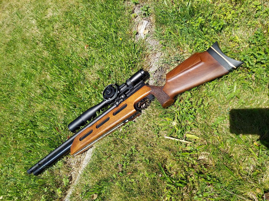

BOTH my Airacuda's ( STD .22 and a MAX .22 ) received a fair amount of massaging to get the best Accuracy & Operation from them.
If able to use Facebook ? this work was well documented as well on the GTA forum.
As they sit today in there highly altered state 🤪
They both shoot exceptionally well ... Out of the box not so much :cautious:

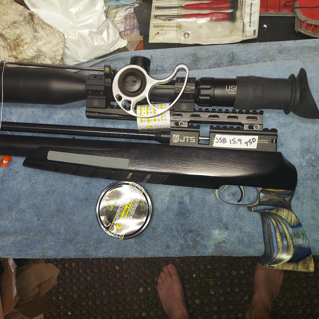

Well, I get right at 40 shots before acurracy is gone. 3200 psi does pretty good. I had pellet clipping at first, but I aligned the stack in the shroud,tightened it and now it’s a tack driver.
You said tack driver so what is it grouping like and at what distance? I also have a max 22 cal. I'm hoping to improve my groups also.
At 30 yds it pellet on pellet. One ragged hole. At 50 yds it’s about 1/4 in group.haven’t stretched it out farther. Don’t have the room..Grass.
