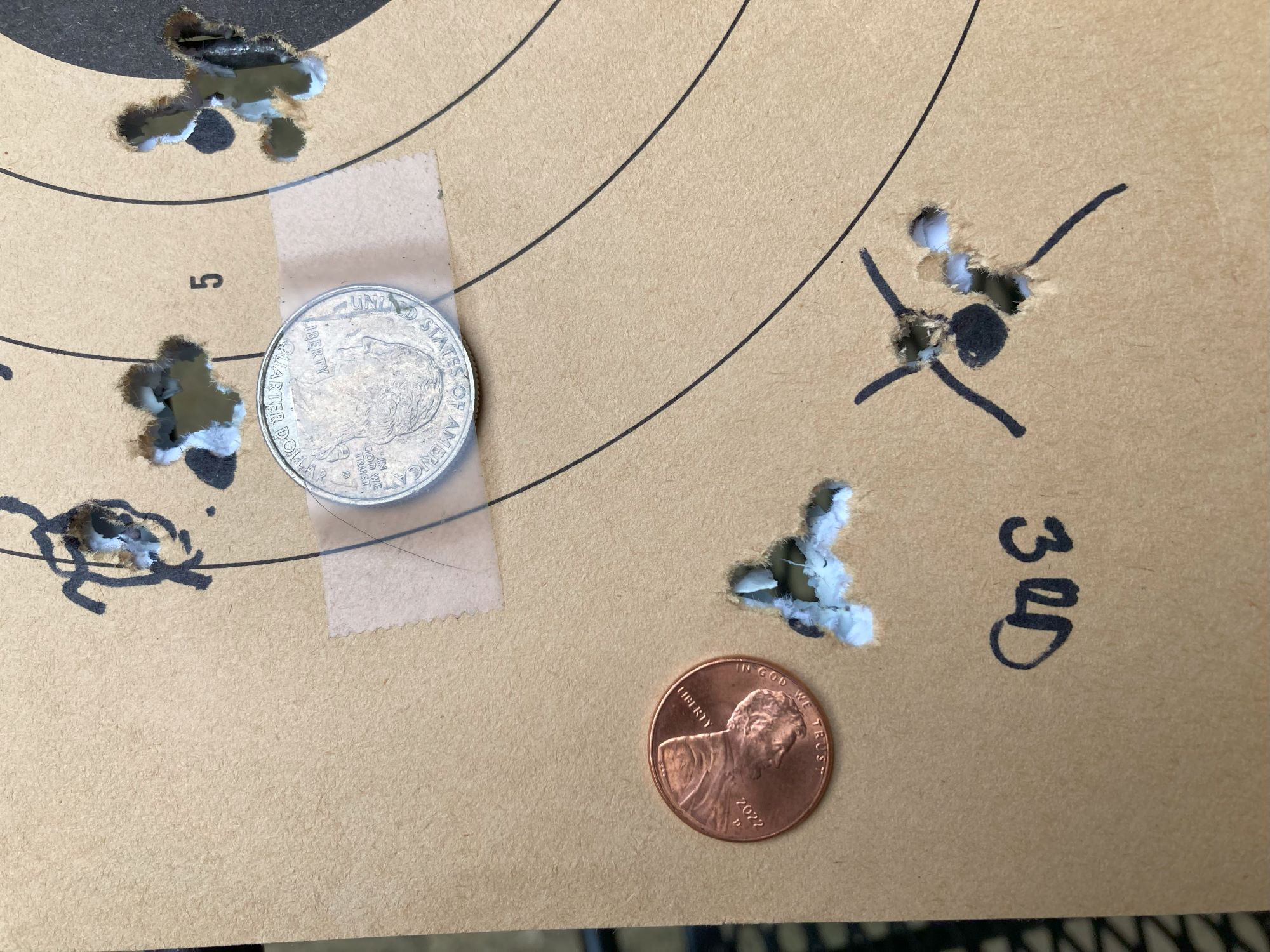

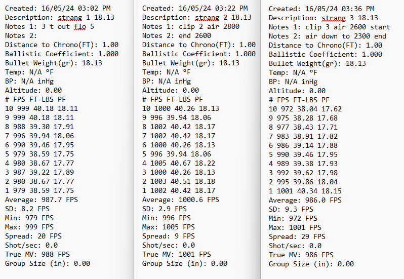

Broke out Chrony today to see what my new “Strangler” would give me. I used the already on hand 18.13 JSB that my Talon SS hated. Hammer full 3 turns out with flow on 5 wide open.
Only did three clips for this “hunting curve” All 30 inside a penny but don’t think squirrel would care? Target shows clip 1 and clip 3 only. Shots pulled in clip 3 trying to follow black marker aim point. I did three separate chrony logs to break down the non regulated shot spread.

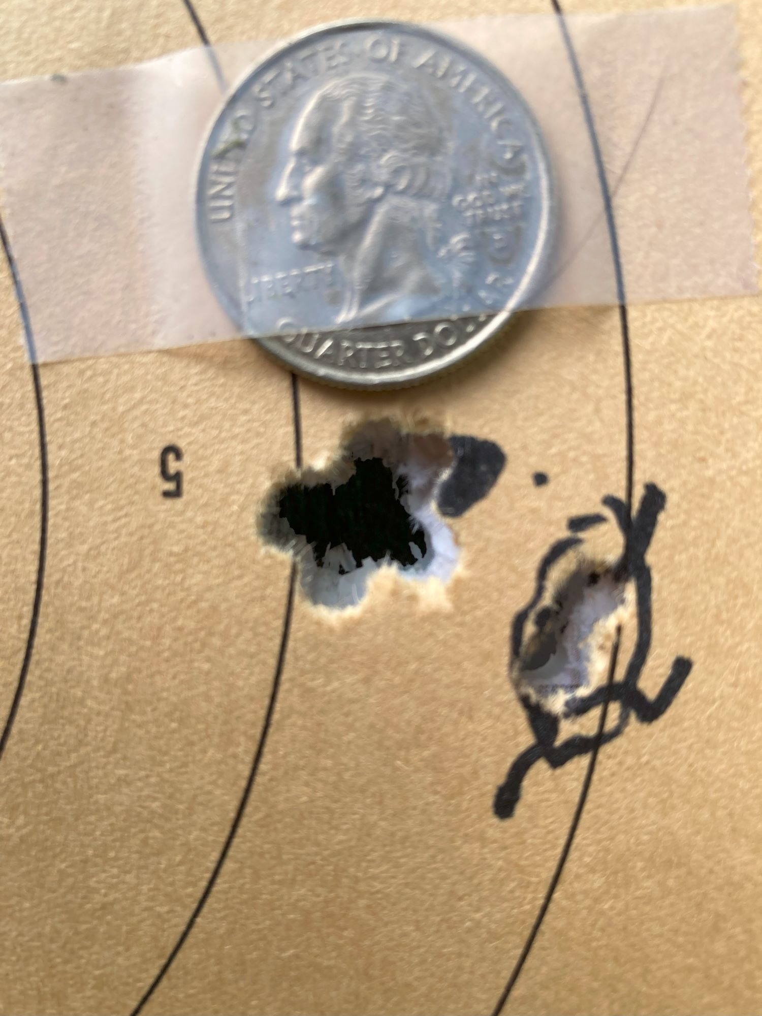

I found out today, that My JTS doesn't like the Cheap Pellets! LOL One ragged hole with the 18.1 JTS Domes, but the Crosman Priemer's and the Daisy Pellets look like a Shotgun pattern. Speed made no difference.
Should have stated ... Crosman DOMES, not the cheapo Tin HP's. Tho my STD is an early pre production 1st release demo rifle.

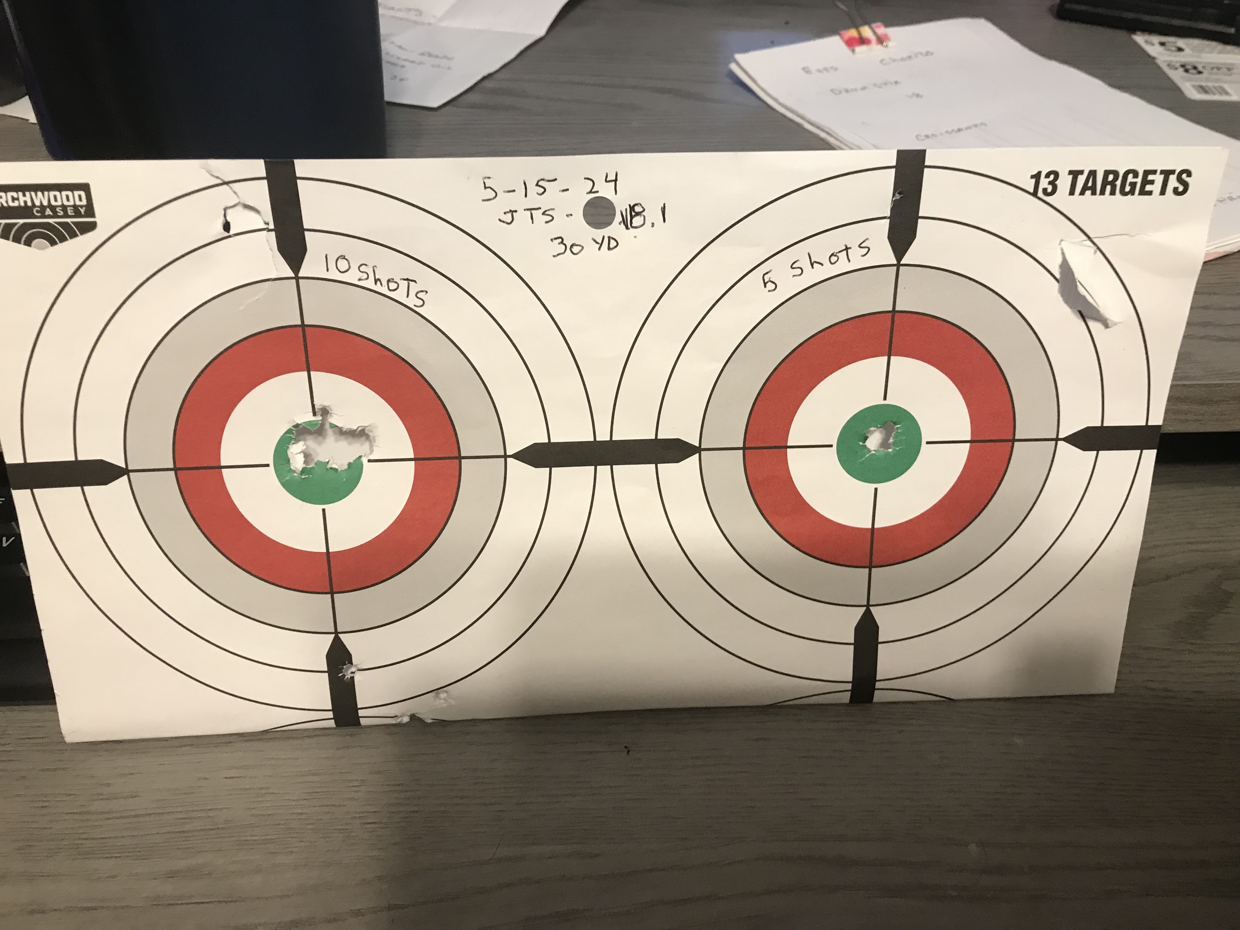

I am not one of those great shooters like many here are, but here is 10 shots on the left and 5 shots on the right. Both at 30 yards. I have done Nothing to the rifle except install My scope. I hope it stays this good! Lol

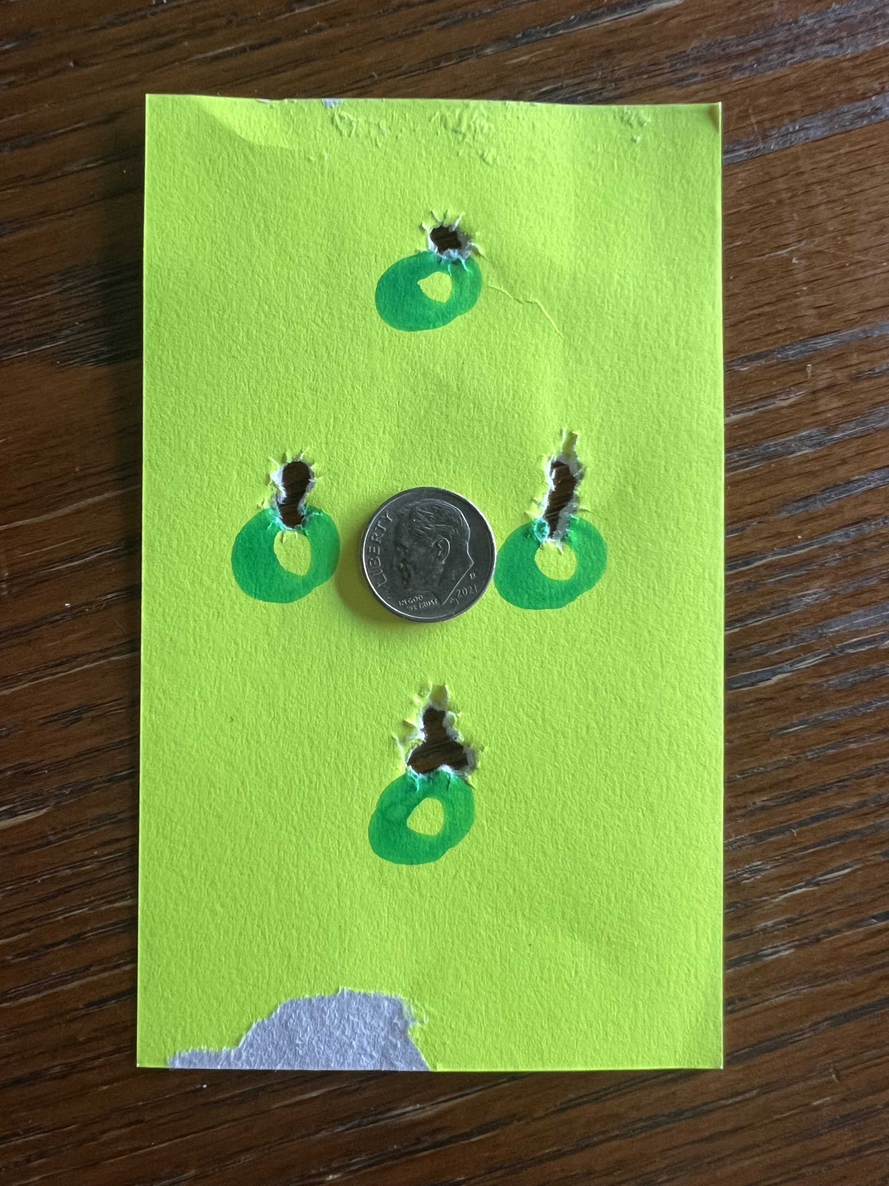

Here’s 4 consecutive 5 shot groups at 20 yards (down my hallway) with the 14.3 at setting 3.

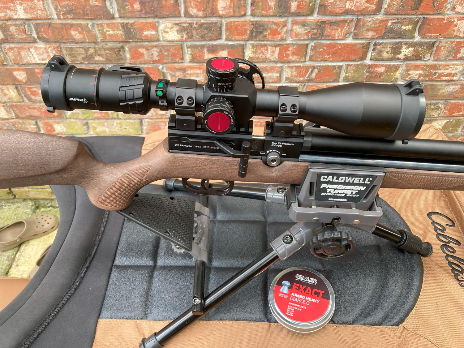

Had a blast yesterday. Sort of a pun. I started with 2”spiners at 58 yards, got bored, then put 5 shots into 6” red circle on Carlos’s splatter target at 100 yards. I’m still zeroed at the 58 yard mark, got lazy so placed scope horizontal even with top of square target just to see for first ranging shot; which was 9 o’clock near middle 4 inches outside of the 6” red circle. Leveled scope then started printing inside circle, with my new 18 gr.JTS. I’m hitting about 995- 1000 fps at muzzle with my same settings on my posted chrony readings. Curious what velocity and FPE would be at 100 yards? Lol, Carlos loves gadgets..got to talk him into a radar chrony.
No wind, very warm and muggy on Carlos’s new homestead in southern Mississippi. Next month will bring crow sized targets. No real crows but very old 600 lb alligator pulled previous week after Carlos called Picayune Mississippi game warden. .22 pellets would have pissed gator off?
Carlos was racing to get his new $800, with stamp, Switchback silencer attached to his CZ .22 bolt action with big Vortex scope. Got to teach my $320 rifle a lesson over his near $2k worth of silencer, scope, rifle and box of sub-sonic ammo. Normal high speed ammo sounds like Star Wars!
