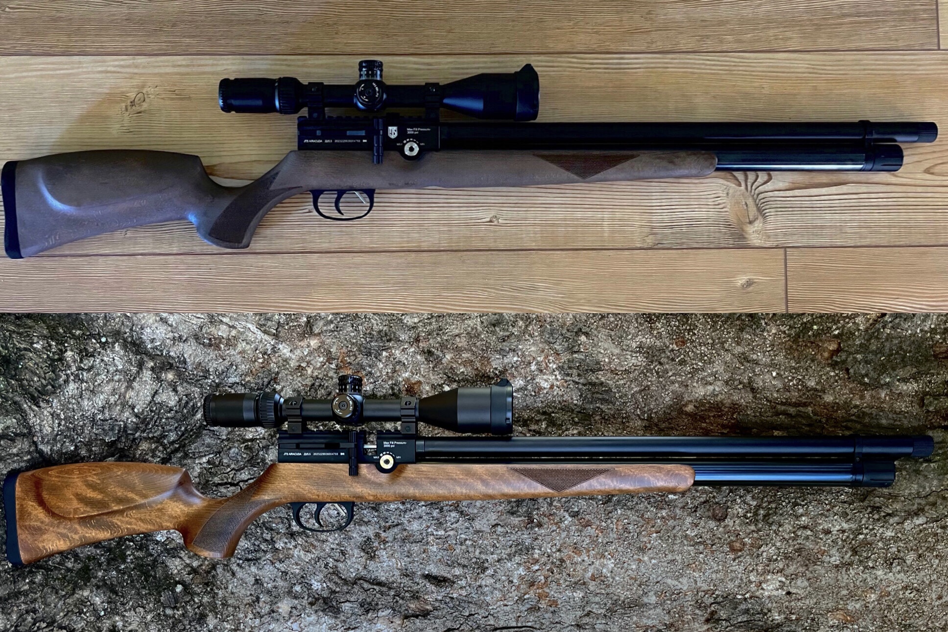

Got mine a few weeks ago. 22 caliber. Very accurate. The scope in the picture went back. Trying a Hawkes 3-9 now. One dime at 45 yards with Dead Center 18.1. Not as good with 14.3 CPHP. May order an Arken. Adds another 1/2 pound. It came with a horrible stock color but I could see nice figure in the Beechwood stock. Simple refinish. Before and after.
Got mine a few weeks ago. 22 caliber. Very accurate. The scope in the picture went back. Trying a Hawkes 3-9 now. One dime at 45 yards with Dead Center 18.1. Not as good with 14.3 CPHP. May order an Arken. Adds another 1/2 pound. It came with a horrible stock color but I could see nice figure in the Beechwood stock. Simple refinish. Before and after.View attachment 490996
I like that stock color on the refinish! Mine does not have near as much grain to it, and it still has tooling marks on the bottom of the stock. Good job!
so what was your simple refinish? how did you do it? looks great!:)
Thanks.
Strip the muddy factory spray stain off with a paint and varnish remover. Use Lacquer Thinner to clean off the residue. After the wood is thoroughly dry, use synthetic wool to lower the raised grain. Caution: Do not over do it. Beechwood is very hard and easy to close the grain so it will not accept stain. Stain, then a couple coats of spray lacquer. After the finish is dry, lightly rub it out with oooo steel wool.
