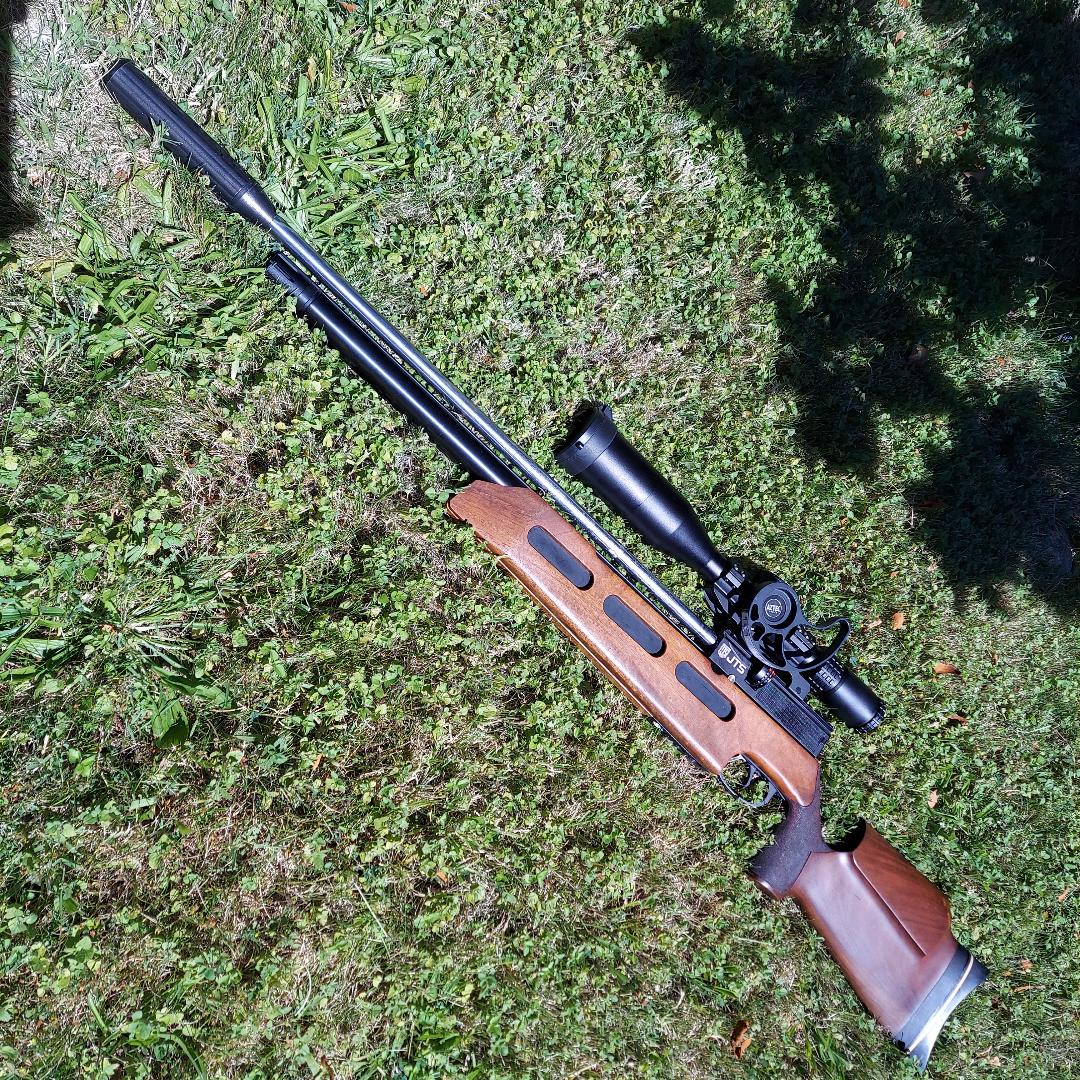

I have placed a regulator into my early "Test rifle" .22 cal Airacuda standard. That along with a Custom SSG hammer anti-bounce.
Now it makes a solid @45 regulated shots on a tune delivering @ 32 fpe.
Few months ago updated the barrel to a 24" changing nothing in tune settings, power jumped to @ 36 fpe with the same 45 shot count.
LOVE this rifle !!!
Yea not a factory stock either .. so admitting it's not stock any longer 🥴
LOVE this rifle !!!

I like the free floating barrel! Glad to see the receiver up to snuff. The scary part gets to IF you need a moderator for around house, I ended up trying adapters and moderators that cost as much as my $230 Gauntlet. I ended up using 3D cones with the shroud. Lol, I like your way much better!
