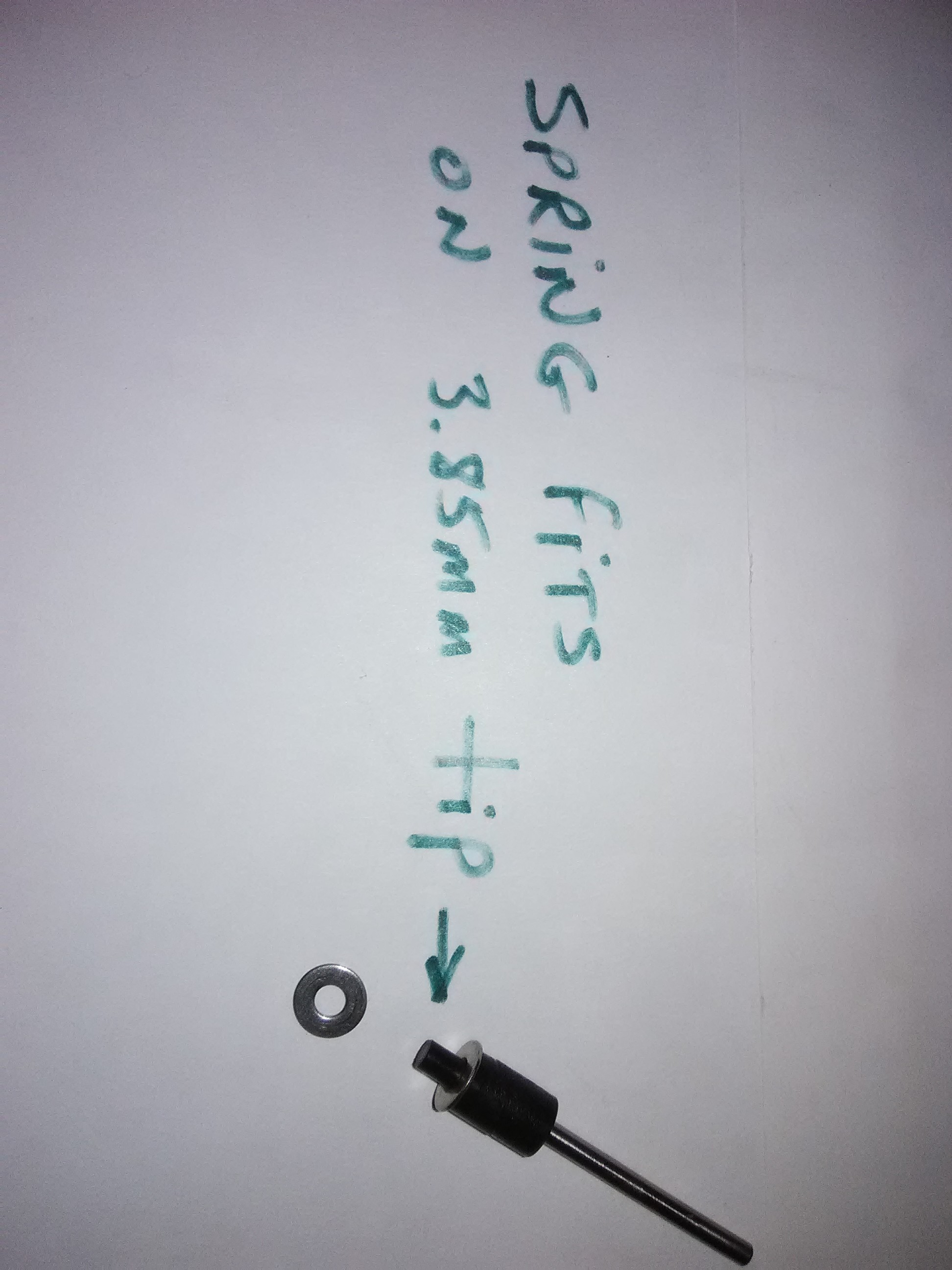

Here's my shot-in-the-dark attempt to address "self-tightening" of valve spring surmising the sharp edge of spring is digging into plastic. SS washer is installed and spare one for visual reference. So far, no movement in valve spring cap thread depth with washer installed. WM
