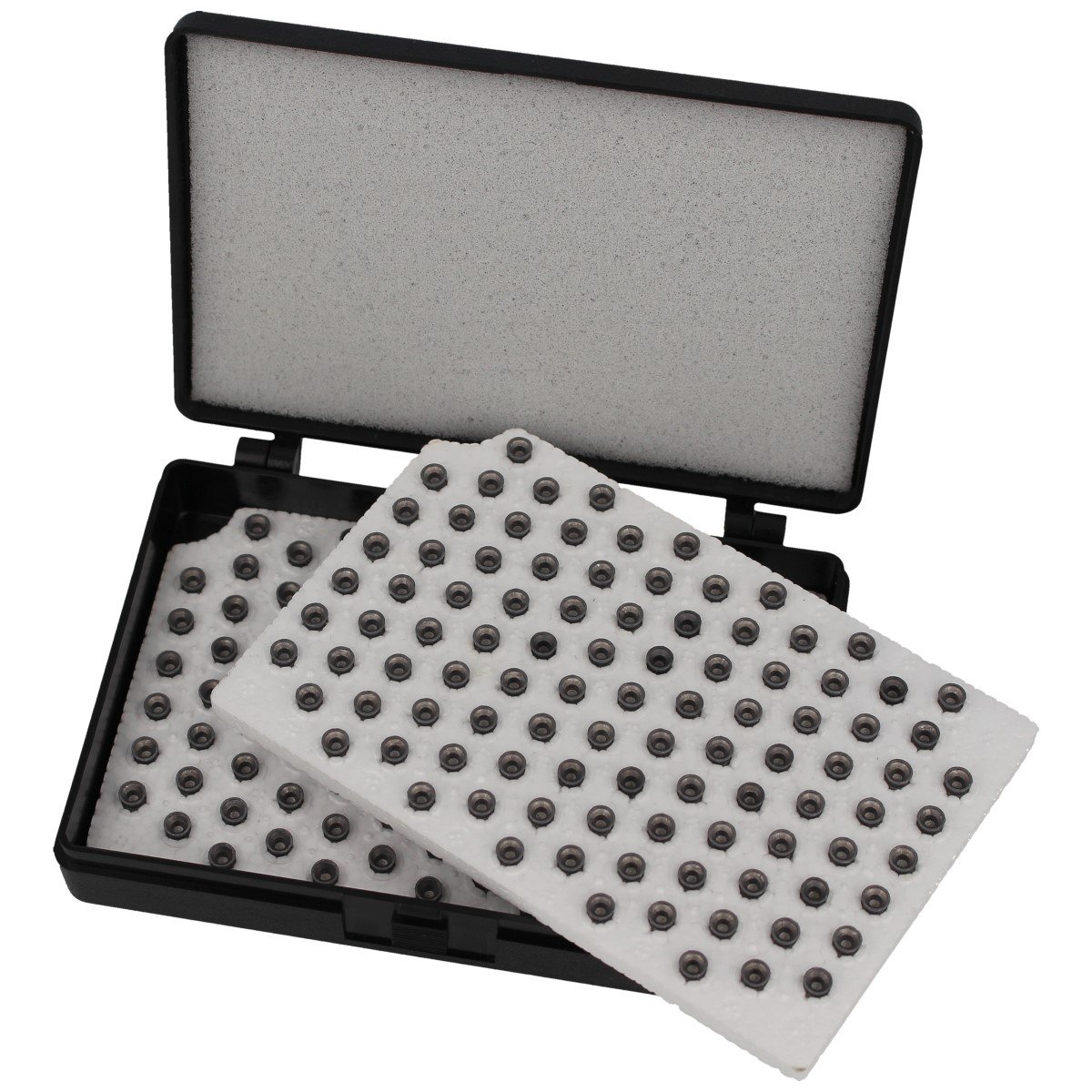

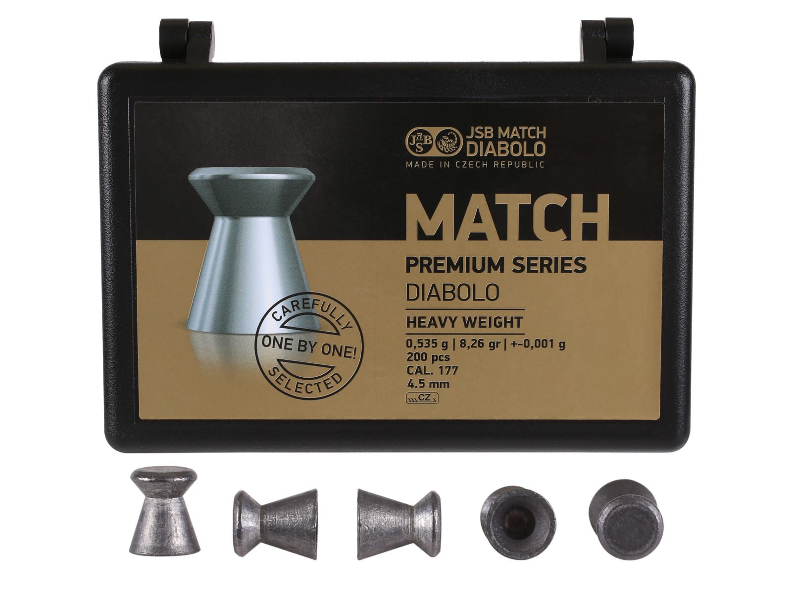

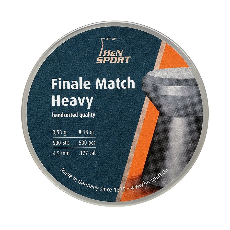

🤦🏻‍♂️ Shame on our pellet manufacturers who can't get their pellet manufacturing right....
How hard can it be....
🤷🏻‍♂️ ...to dedicate one machine to the one .22 pellet every competition shooter seems to be asking for (MRD) —
🤷🏻‍♂️ ...and require close quality control and hand selection of that one production line —
🤷🏻‍♂️ ...and charge 50% more?
➠ Most of us obsessing with precision would just say "Ouch!" — and whip out our credit card. 🤷🏻‍♂️
𖣠 If the .177 wadcutter punchers get to buy "handsorted quality" — why not the .22 domes slingers?
𖣠 If the 10 meter ring shooters get "carefully selected one by one" — why not the 100 yard ring shooters?
🔶 I'm just making constructive suggestions (and yes, I'm also in complaining mode, sorry, I'll switch that off now).
I don't like to pay more. But if someone would guarantee consistency — I'm willing to spring the $$.
