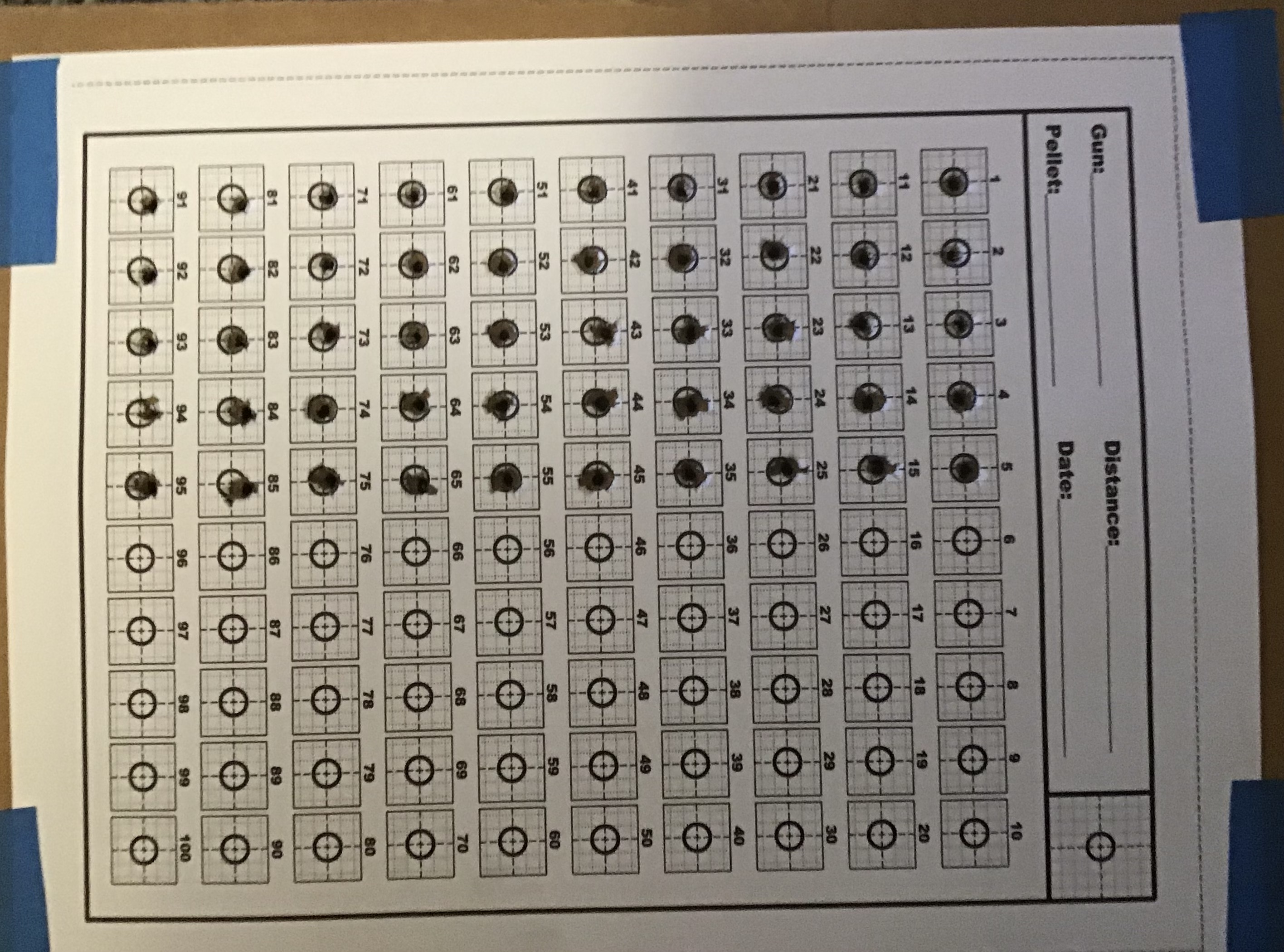

The 22.07’s JTS were very consistent in my Epoch
did a consistency test at home…10m
Hope to get out and try them at distance
