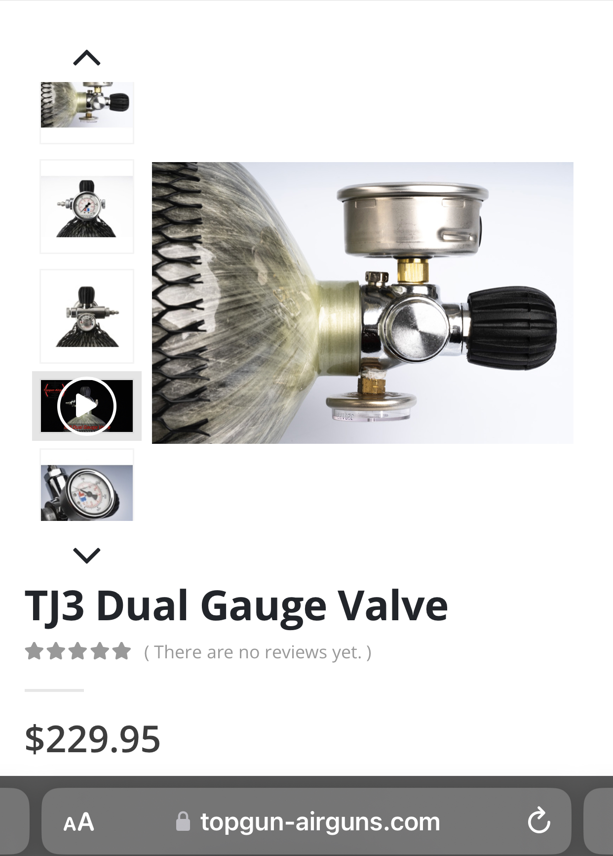

@JEFROX I have a tank with a Jubilee valve and I’ve had it for a couple of years. I recommend a different type of valve if it doesn’t already come with your tank. If you’re paying extra select something that many airgunners have used and speak highly of as to the materials, ease of use, fit and finish. I particularly would pay attention to what folks say about the feel of the valve knob tiring and ease of controlling the flow of air. Here is a weak point of the Jubilee valve. If I were in your shoes I’d consider this Joe B. valve from TopGun Airguns for $230. I haven’t used it but I’ve read enough good things on AGN to invest in one. It has two gauges, one for internal tank pressure and another for fill line pressure.

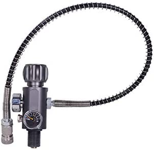

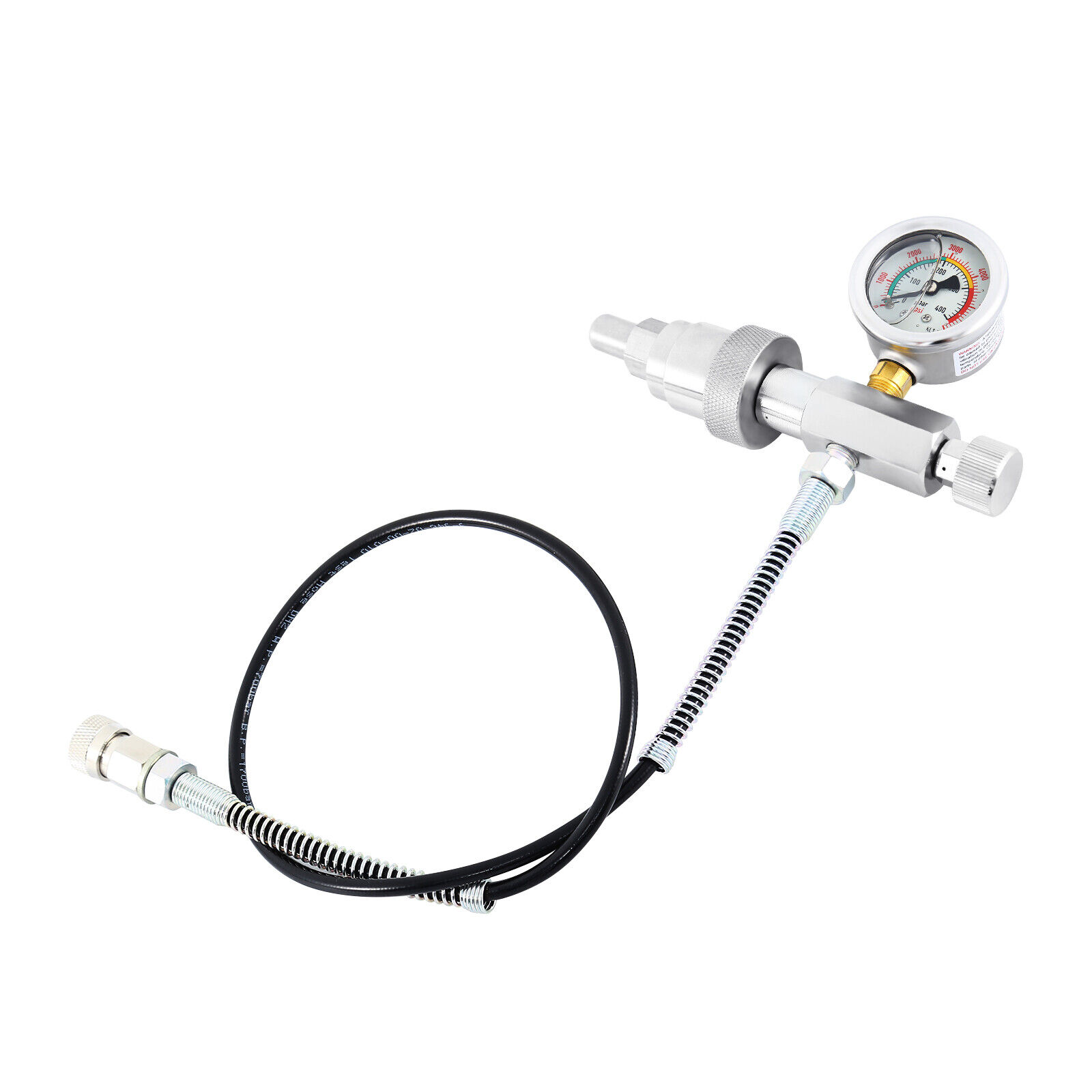

  • A Hand Tightening Fill Station
    I bought one like this one and it is working well. You don't need to have a wrench to install or remove it. You might want a longer hose, but they are quite inexpensive and extra hoses are nice to have around.

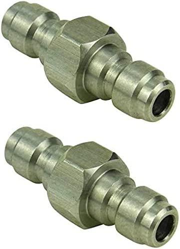

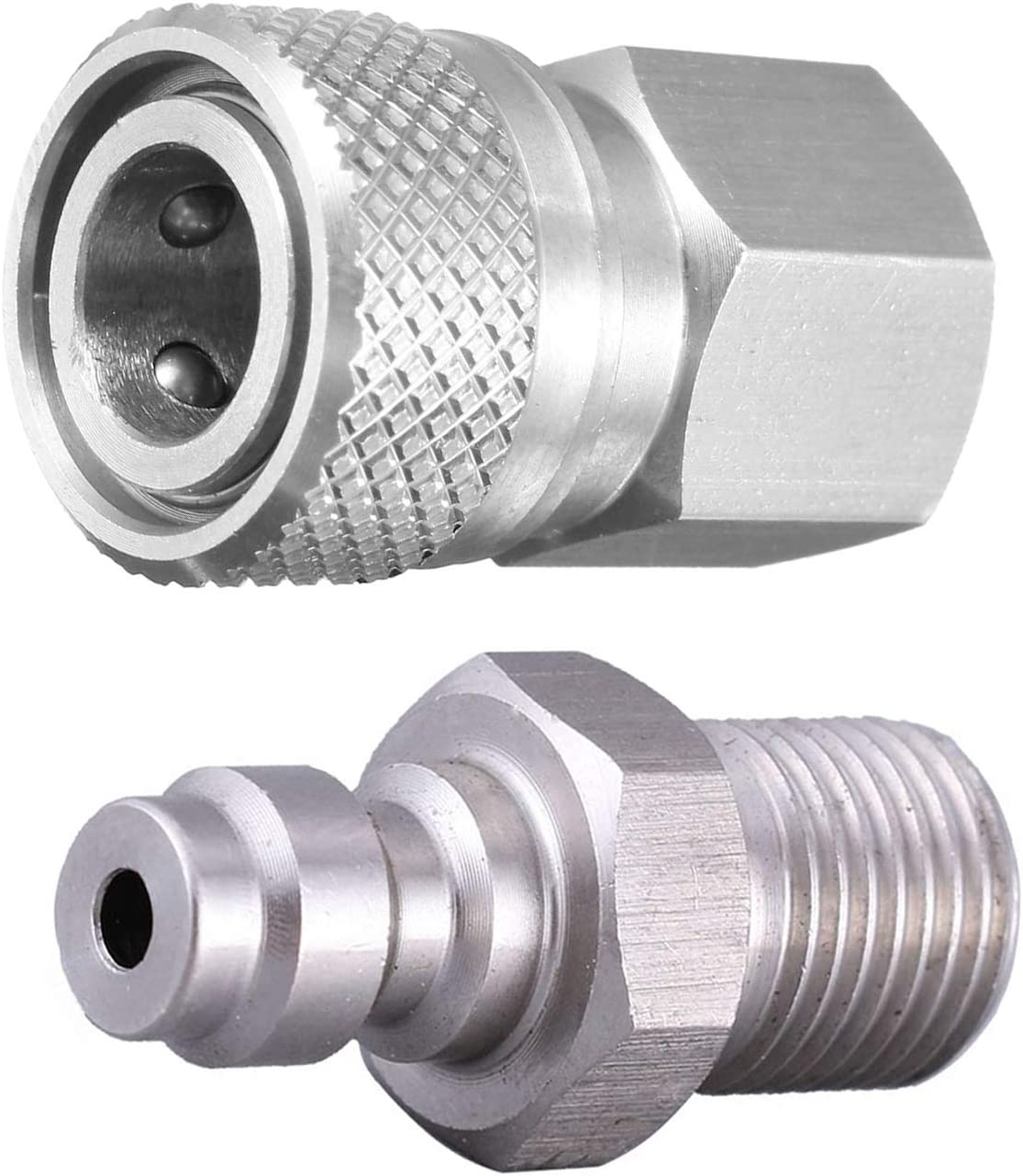

    I replaced the threaded on hose with a threaded in male 1/8 quick connect on the valve assembly and a female quick connect added to the other end of the hose, so the hose can be easily removed for transporting the tank in a bag. All my hoses now have female connectors on both ends and my tanks have male quick connects, so everything swaps out easily. A few male to male connectors made of stainless steel allow easy extension / adapting using more than one hose.

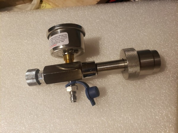

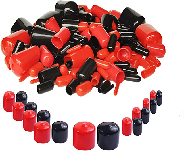

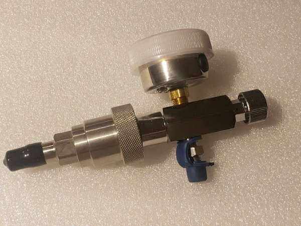

    I added a protective cap for the gauge, tank side of the fill station and the male quick connect to keep out debris when carrying it in the tank backpack / bag. The cover for the gauge is the cap from a large bottle of Ocean Spray fruit juice. I removed most of the threads on the inside until it popped on and off easily but didn't fall off. See photos below.
I bought the 74 cf tank from Joe B. The valve and tank are very nice but the smaller tank pressure gauge is way off. I called Top Gun and they said they would send a replacement gauge but they never did. So I bought another liquid filled gauge like on the other side of that valve. It of course is bigger but no big deal. Valve works good though.

Thanks for the replies! I bought a used Joe B. fill station, eight years ago from another forum, that I could use with the SCBA tank. I took a break from the hobby before I had a chance to buy a tank so I’m just using this now.
Also in the process of converting the hose to QD.

@Geezerhood Where’d you buy the black protective caps? Do you have a link? Using the juice bottle cap for a cover is creative. That’s the blue one right?
The black cap is from a multiple size vinyl cap purchase and the blue one is a 1/8 male QC fill port cap with a tether, that is made for the fill port on your airgun - available in several colors. The white cap that covers the glass on the gauge came from the large Ocean Spray juice bottle.
