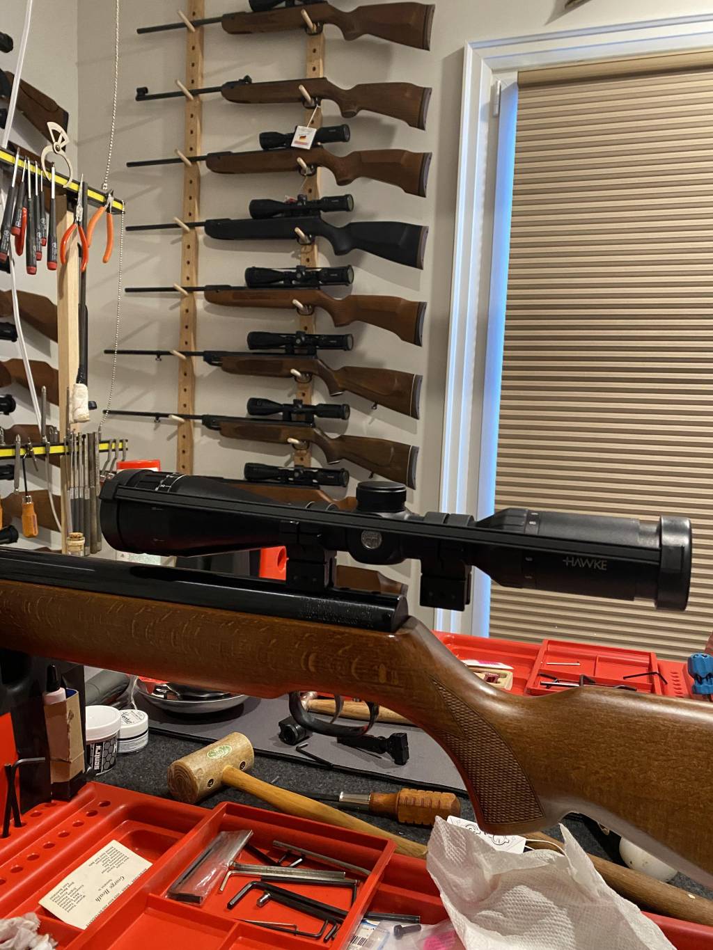

I took a HW80 .177 to initiate and set the sights on scope. Sighted in about 6 shots. Take a shot then make an adjustment,then another on and on. I’m sitting on a Stable Table just pumping away, not catching on my cheek position changed dramatically.
 BKL mounts and they were tight. Guess not tight enough. 95% of the time I use stop pins. Lesson learned. 30-40 rounds. Crow

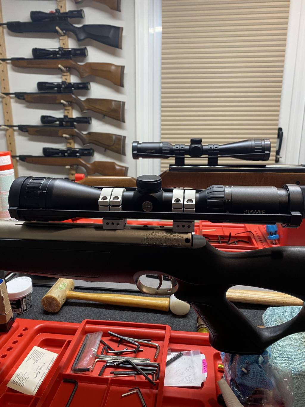

Almost filled my diaper. I wasn’t far off. When I got the rifle order in Jan. I got 6-7 sets of BKL. Read here nothing negative. Here’s a 97 doing the same thing, not as severe.
 Every rifle I have had stop pins up to the BKL’s. I’ll replace them. Live and learn. Crow

Oh ya! The perfect word choice. Hard to believe it moved that much that quick. I’ll be at AGS in about a hour and a half, hopefully he will have some stronger scope mounts. Crow
