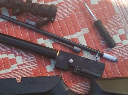

Can tuning the hammer spring (like giving it more tension using an o-ring) of a pcp airgun increase the velocity?

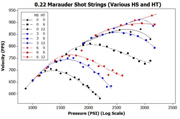

Yes or No, depending on the gun. If you are already tuned for a declining string (max FPS on first shot ie Korean Cliff) then the answer is likely no, if you are regulated and tuned on the lower side of the "knee" then Yes. If you are unregulated a bit more preload (via adding any type of spacer) and an increase in fill pressure will result in a higher average FPS."dlancerx"Can tuning the hammer spring (like giving it more tension using an o-ring) of a pcp airgun increase the velocity?
It's an Indian made pcp, the first of its kind, Precihole PX100 Achilles. As mentioned on their website, it's an auto-regulated pcp."shutik"Generally compressing hammer spring more will increase pellet velocity up to certain point, after which it will waste air and not increase velocity. I am not convinced o-ring will work.
It all depends on the gun and it's current "tune".
