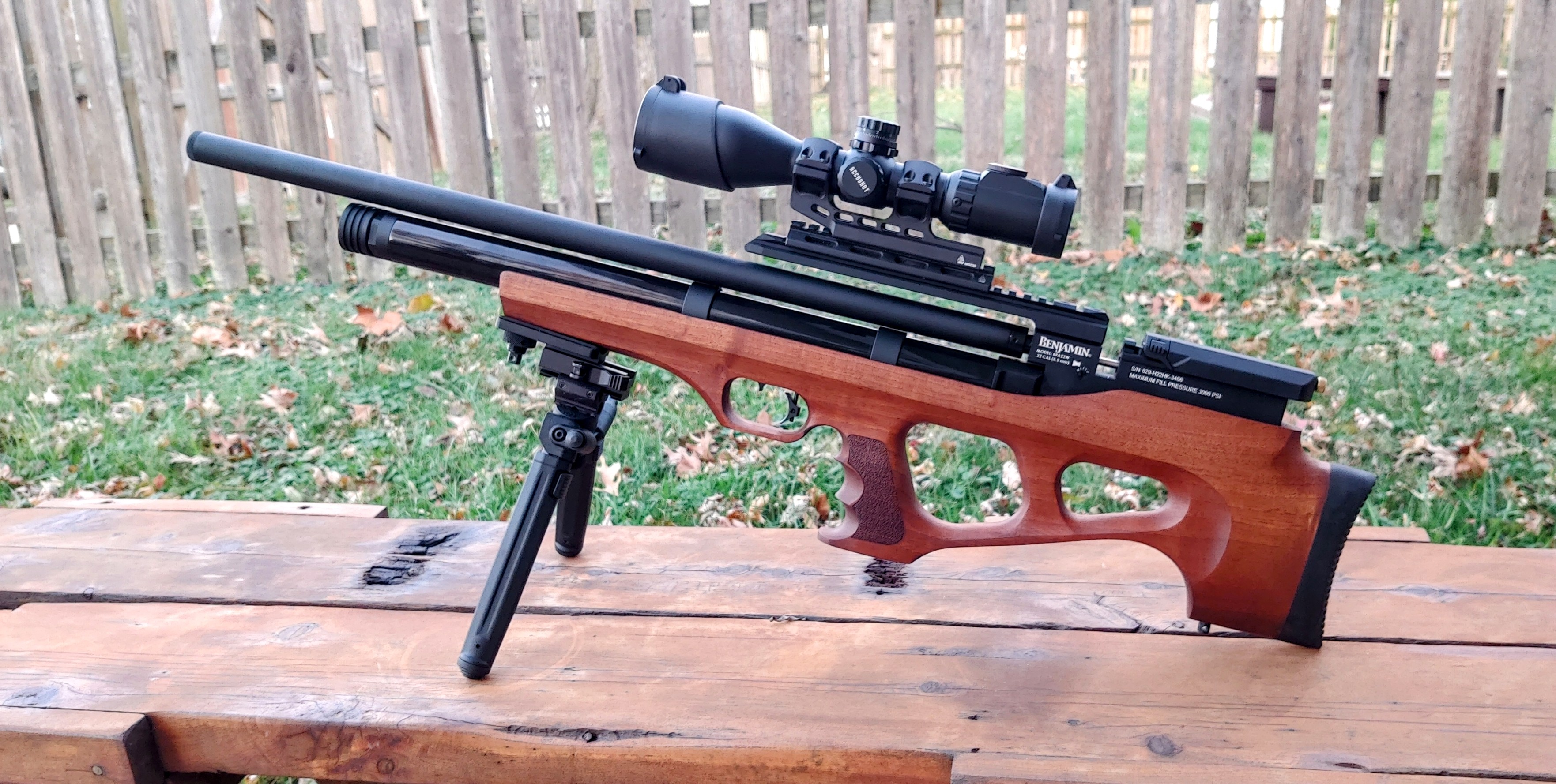

I got my springs from Crosman, and cut one. After bending the end back flat, I ended up at 2.65, close enough I guess. I still have a couple to experiment with.
I went to the range, and it was shooting JSB 8.4 in the 875-890 range with the power adjuster in the middle, and the hammer adjuster backed all the way out. I turned the power adjuster one mark hotter, and started shooting in the 950 range. That power adjuster is sensitive. I guess I need to try and figure a balance between the hammer spring preload, and the power adjuster.
The gun is accurate for a first test. I tried some old boxed Premiers, a couple of JSBs, and some Kodiaks. Oddly the Kodiaks wouldn't cycle, so I couldn't test them. Trigger is also pretty nice. It seems that when you take up the slack from the first stage, it doesn't run into a bump for the second stage, just fires when you get so far. Might need a little adjustment, or more familiarization. Pretty light pull. I didn't do a full shot string. Also,I was shooting from a bench, and was rather surprised how comfortable it was. I had no issues with the bullpup configuration, or scope placement.
I also had my Brocock Bantam bottlegun with me for comparison. Bantam is much louder, with a heavier trigger pull. Accuracy is pretty close, with the Brocock edging the Akela, but it was first test with the Akela. Both do best with JSB pellets, no surprise there.
I did find a couple mags on Amazon. Thanks to the poster above who mentioned it.
Overall, I am really surprised that the Akela is as nice as it is. Fit and finish isn't on par with the high end guns, but considering the retail price it was way less than half their price, it looks pretty good, and seems like a workhorse. Then you consider I paid $169 for it, and it's a ridiculous value.
