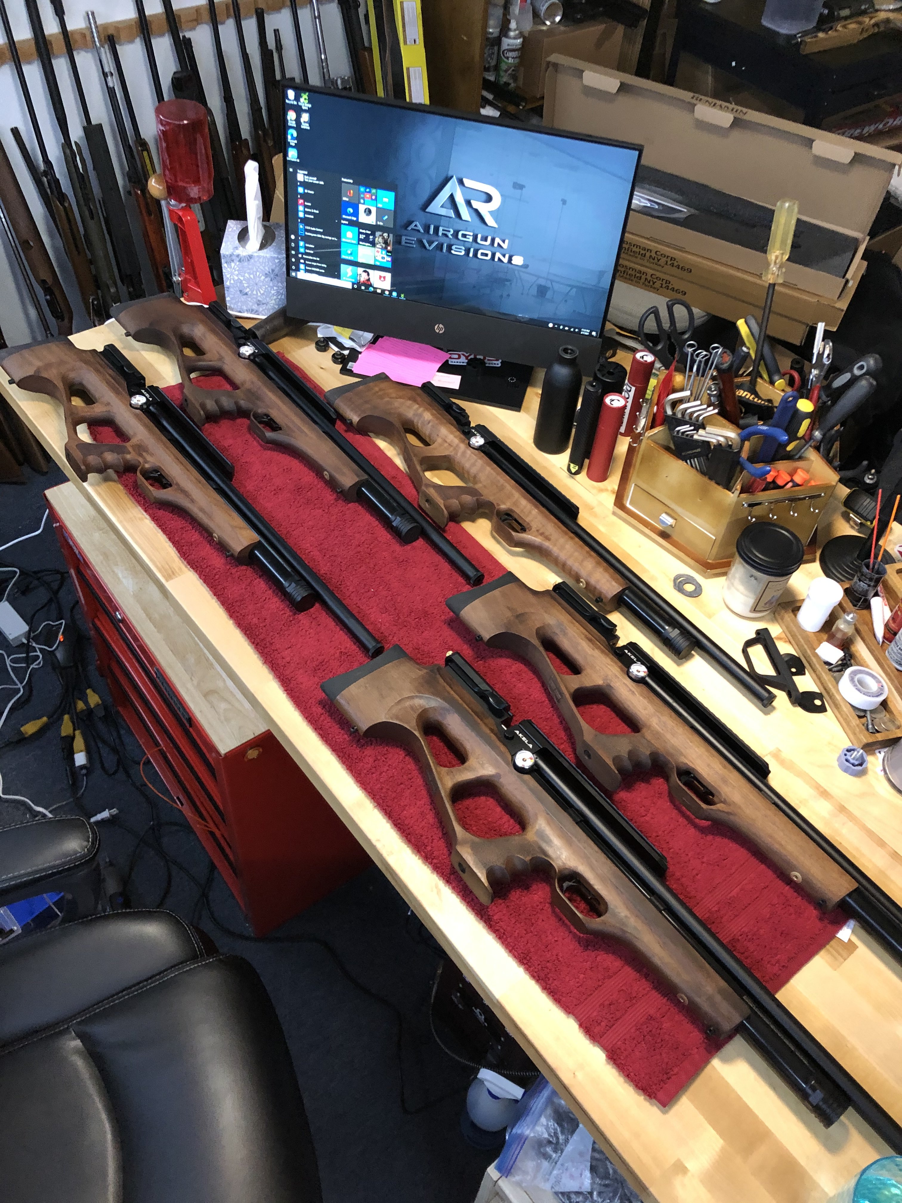

Yes unfortunately for now the available.177 Akela’s are out of stock. I did sell quite a lot of them. There are many many more .177 Akela’s waiting here at Airgun Revisions.
I won’t release any more until I acquire an inventory of mags. We are working on overstocking them so customers who purchased guns in the past can get additional ones. If obtaining new ones from Reximex becomes an issue we might look into contracting an established mag maker like DARKO.
All the best, Rich
