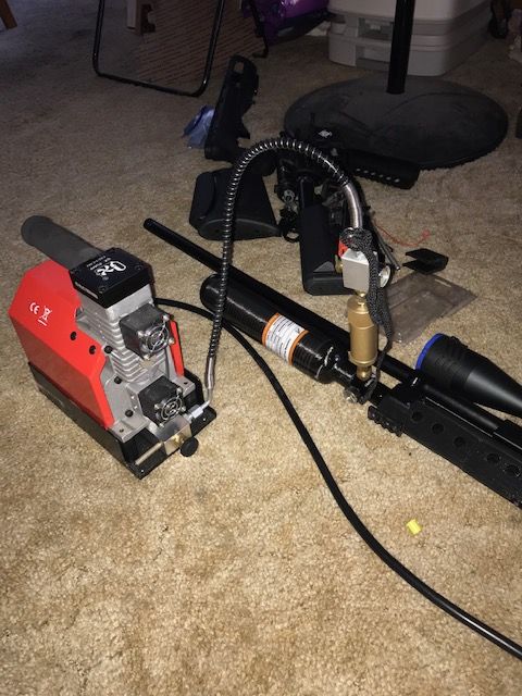

Bought it on Amazon last week, came today, opened the box, un packed, looked it over, hooked up the power converter and installed the Handle/ pre-filter, no oil, no water needed, pre-lubed from factory with grease, fired it up with test plug, shut it off at 300 bar, no problems, this is a manual shut off version, added a oil/ water separator and fill probe, filled my Uragan 5.3 liter bottle from 100 bar to 250 bar in 10 minutes, it works and it's fairly quiet, kinda funky sounding, but it works, I'm going to do a proper break in on it with short runs and long cool offs till it's ready, it's just going to be used for topping off the rifles,
