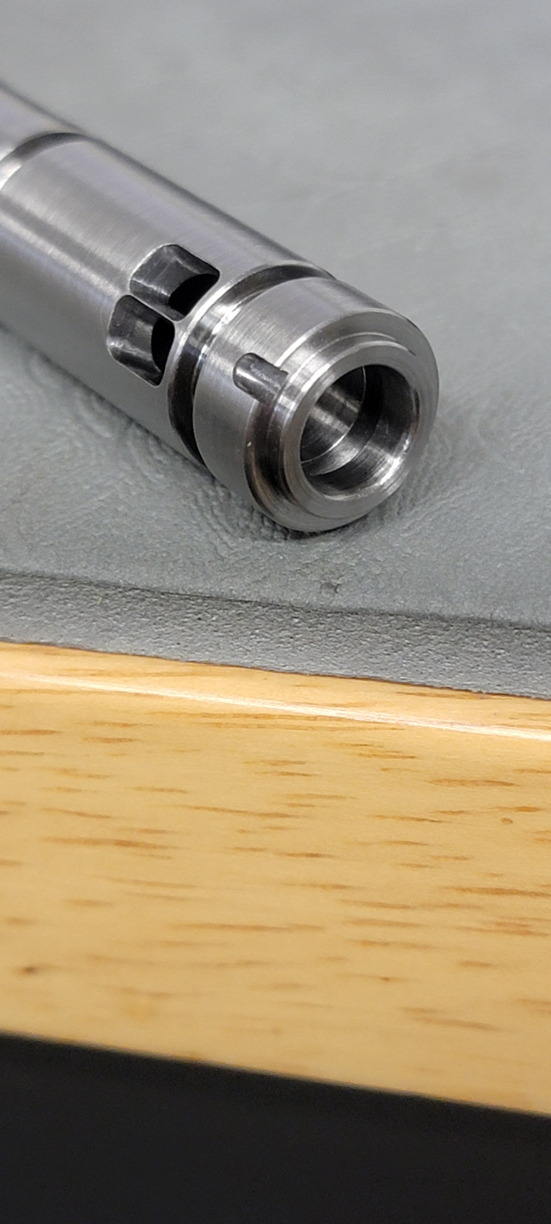

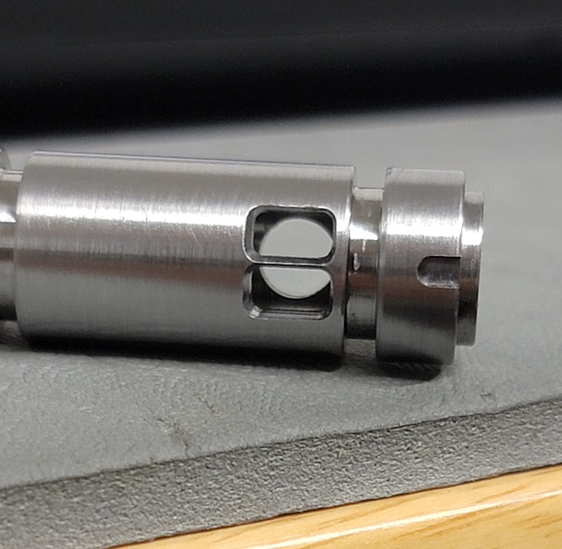

Just finished machining .30cal TJ's for FX Impact.
I had a gentleman contact me for a .30cal TJ'S barrel for his impact. He had a bit of a twist for this one though. He wants 2 ports. One for pellets and another for slugs. He wants to rotate the barrel 180 deg and change projectiles. Sounds interesting, so I turned it and set it up in the 4axis CNC. Slug port is 100% of bore area and pellet port is 75%. I do believe that It will breath. I'll try and post some pics.

If you have the equipment, it is a lot less expensive. Most of the expense is in a proper set-up. getting the "chamber" true to the bore is a real task and consumes a lot of time. I've made a turning jig that allows me to do this pretty efficiently. Many think that is as simple as getting things concentric. You can often times get away with that and many do but to true the blank to the bore concentrically and longitudinally is a trick.
Depending upon desired features and length, they can run north of $300. They require a lot more work than a marauder barrel. Although, I'm working on a m-rod design that will be less complex to make and allow for barrel indexing. Time to test is the issue. never enough time.
The one in the pic has a carbon fiber sleeve epoxied over it.
