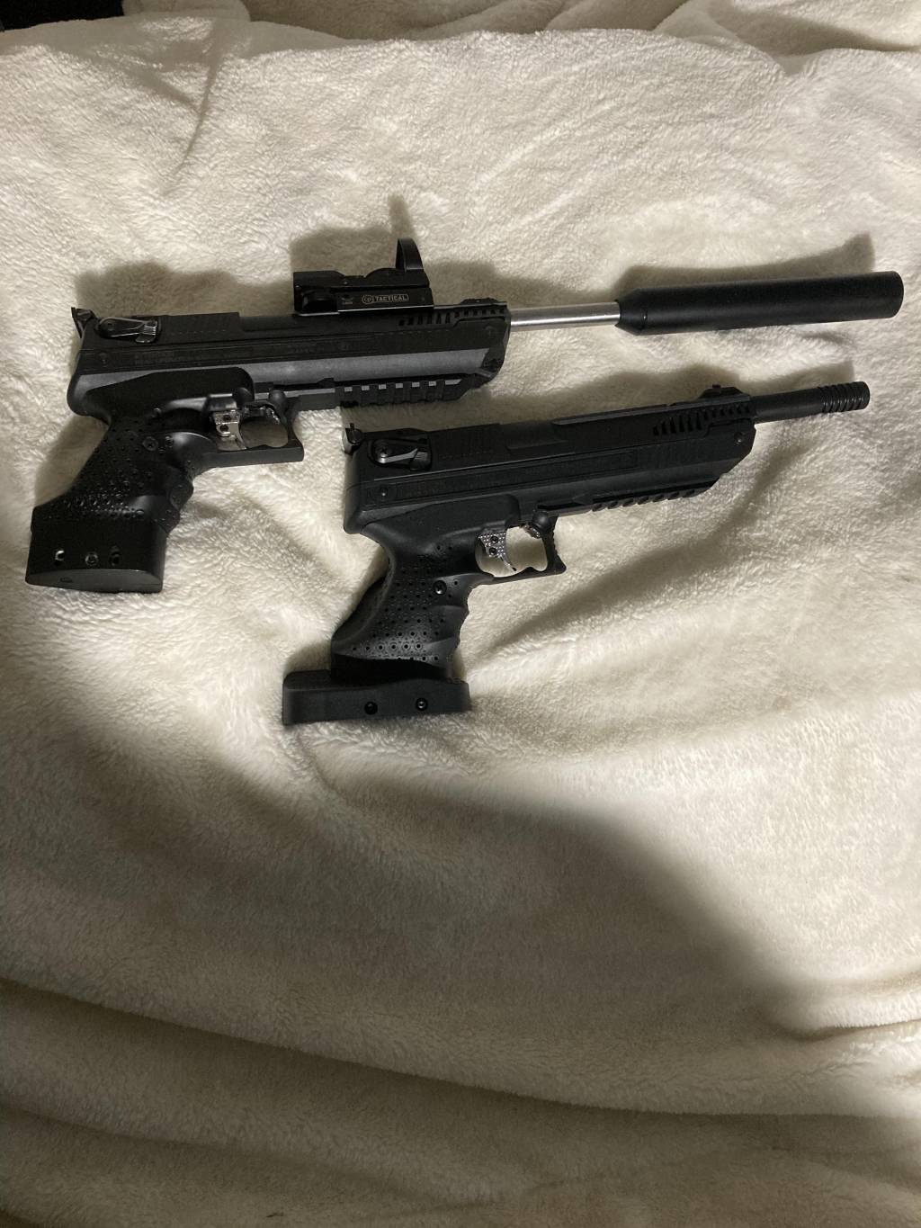

Glad you like it boscoebrea, they are definitely amazing little pistols aren’t they. I liked the .177 so much that I got the .22 lol. I like the palm pad on the .22 because it helps me with off hand practice. On the .177 I took it off to make it easier to shoot off of bags with a scope.
The .177 has an aftermarket barrel that used to be available from a guy in the UK, unfortunately he’s not in business anymore. It makes a little more power because of length, and accuracy is great. Plus with the silencer it’s ridiculously quiet. Enjoy the pistol!
