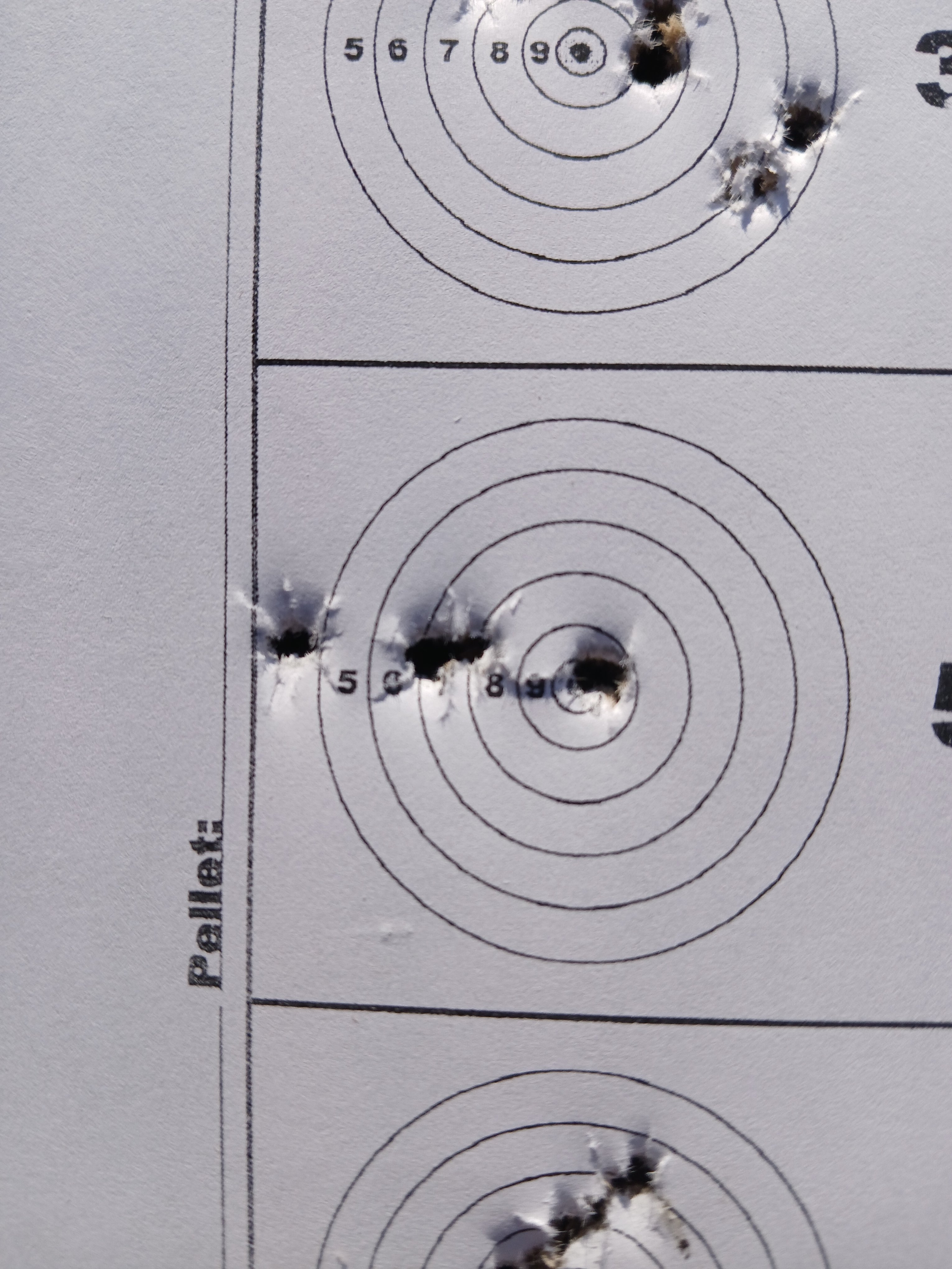

Let me first set the table... I've been a long-time outdoorsman with a 23 yr military career behind me and have been a "powder gun" shooter for most of my life. In "powder guns," I can pull one out of the box, give them a good cleaning, set up the gun(s), site in, and then count on them to HIT what I am aiming at, with the FIRST shot...EVERY TIME. None of these guns are considered "high end." I have 4 Ruger 10/22 rifles in various configurations, none costing more than $500, and each will put 10 shots in a single ragged hole at 50 yards, with whatever ammo that's compatible. All of my center-fire rifles will do the same, but at 100yds+.
Due to health issues related to my military career, I am 100% disabled and can no longer hunt, but to still be able to "shoot", I turned to "Airguns.".... I started with a few different "Springers". And I still can't understand why those types of "airguns" are even made/sold... unless you just want to solve problems each time you shoot them.
After that, I dipped my toe into the .22 PCP gun ocean... The first was a Marauder, then a Gauntlet 2, then a Notos, a Niksan Ozark, and most recently a Barra 1100z Gen 2.. It took a lot of modification to the Marauder to get "relative accuracy" out of it. I could never get the Gauntlet 2 even close to being "accurate", no matter what I did to it, and thus I no longer even shoot that gun...... money wasted. The Niksan Ozark was an impulse buy and a total waste of money. (plus a very bad experience with the seller) The 1100z was returned under a warranty issue (a new one is currently on its way to me), which leaves the Notos...the least expensive of the lot, and is the ONLY gun out of them all that will consistently put 7 shots (mag capacity is 7) in a single ragged hole at 25yrds, with any pellet I feed it. If this is possible in a sub $275 gun, why is it not demanded/expected in EVERY PCP gun costing more than $1K?
Preferring traditional style guns, the FX DRS recently caught my eye, so I watched videos from Pyramid, and Gateway to Airguns. In the Pyramid video, the host was "wowed" with a 3/8" group off a benchrest. In the Gateway to airguns video, the host louded "accuracy" of the gun, but out of 4 groups....only one was a single "ragged hole" off sandbags. Other groups were "scattered", which makes me question consistency. After checking, I was very disappointed to find that the DRS, in the least expensive version, is a $1k gun.
So, having said all of that, I've read time and again... You have to pay for accuracy in PCP guns. My question is...just how much must an individual pay for a traditional style PCP to get CONSISTENT ACCURACY OUT OF THE BOX without having to test endless pellets and/or make modifications to the gun?? OR does anything like that even exist in the PCP world??
What do I want? As described in the first paragraph, a gun that once "set up" will give me confidence in its accuracy each and every time it's shot... but moreso a gun that I can trust to be accurate on the fist shot... because in most pest/varmint/small game hunting situations, that first shot is the only one I will get.
So far, the Notos is the only PCP I've shot that gives me relative confidence in first shot accuracy, and it's the least money out of all the PCPs I own. However, its downfall is power. I've literally watched pellets bounce off squirrels when the shots were beyond about 35 yards.
