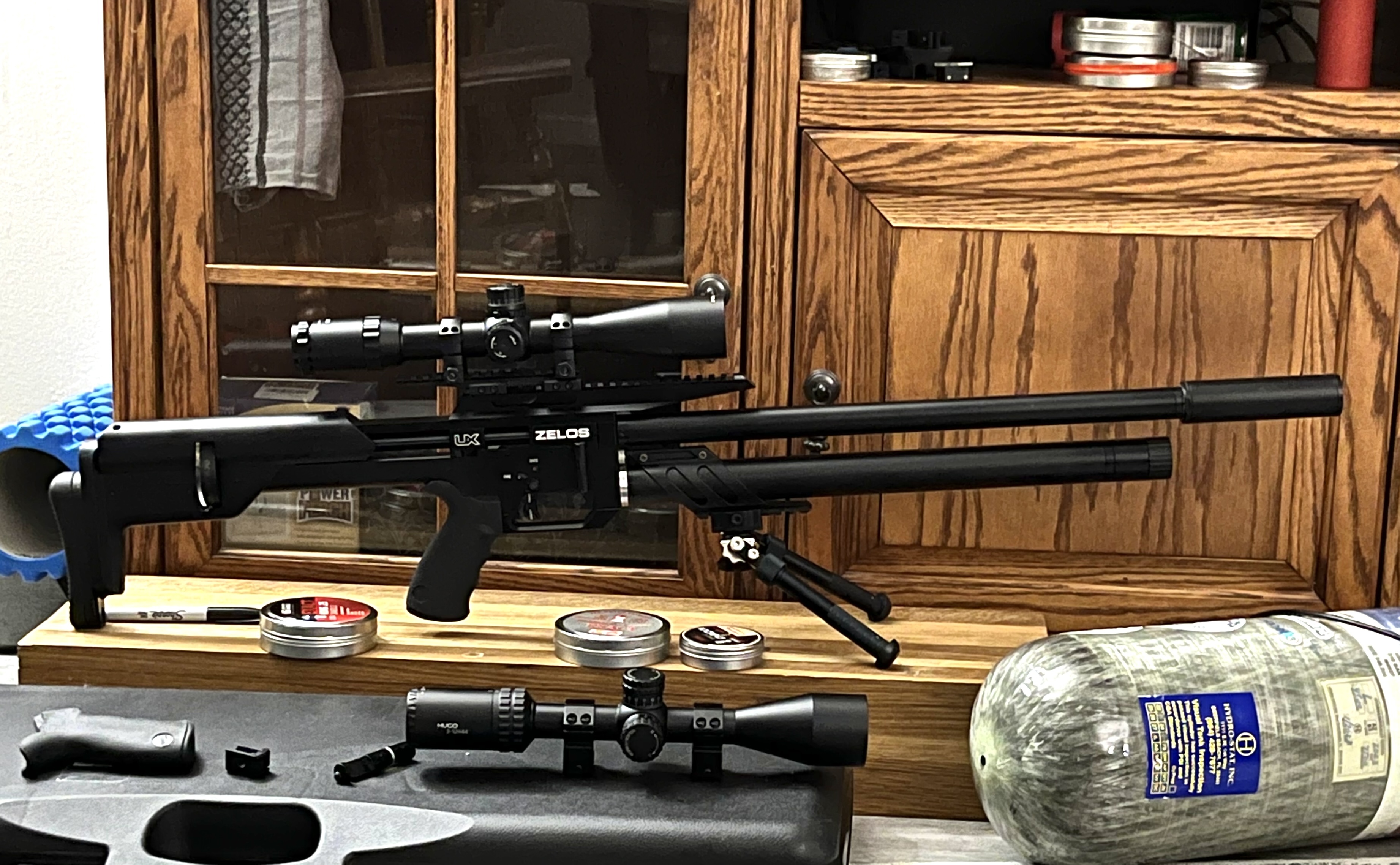

I've looked and looked at the Zelos... and I just can't like it. Brings far too many skeletons outta the closet for me. ;)

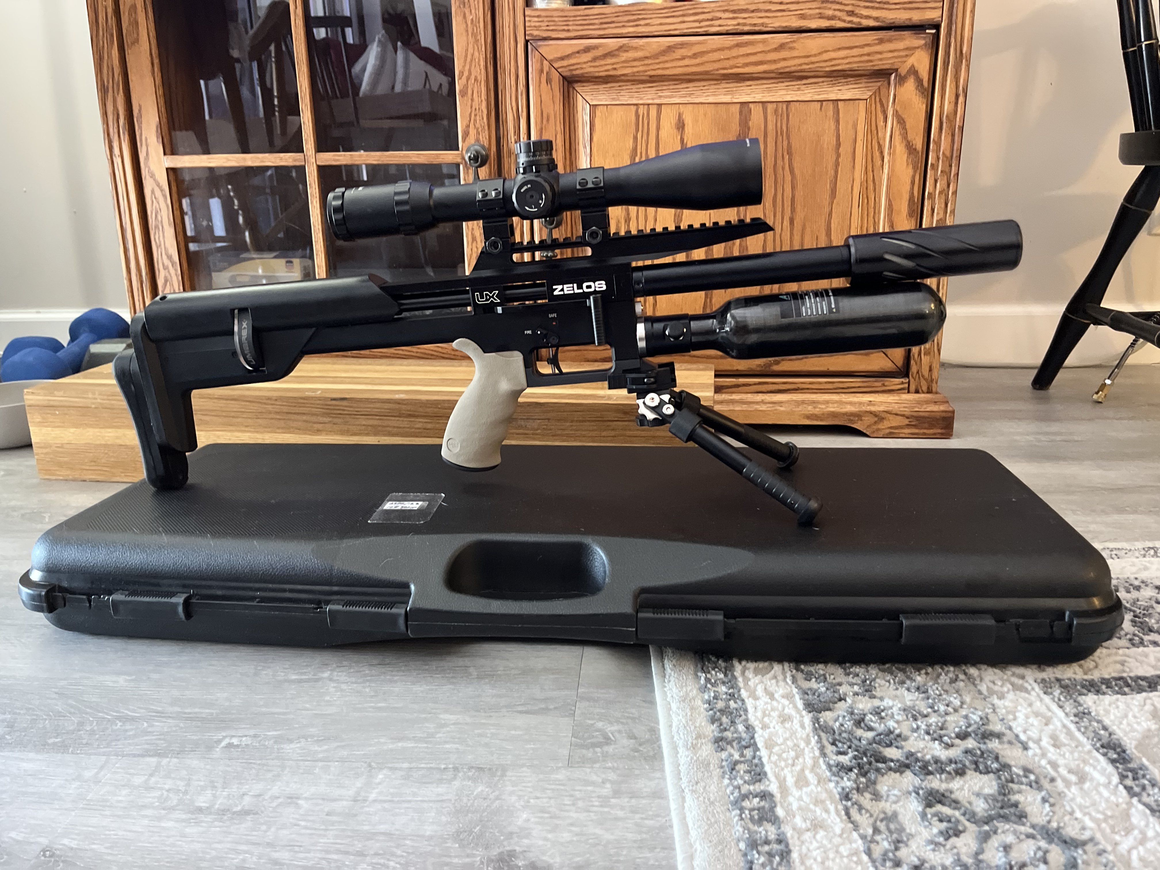

I think the zelos would look much better if they put a bottle on it.. it looks like it was designed for a bottle and they took a shortcut and put a tube on it.
