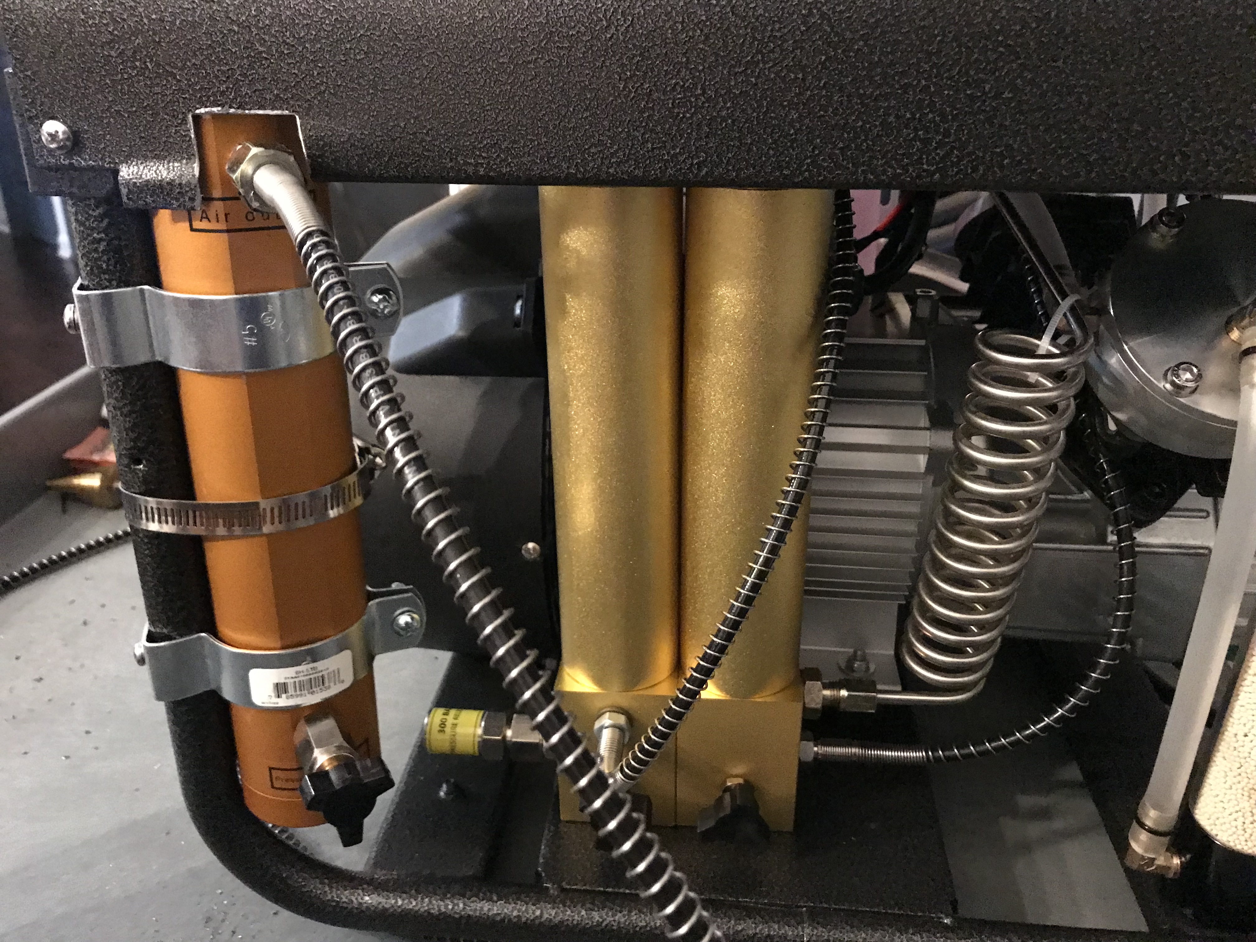

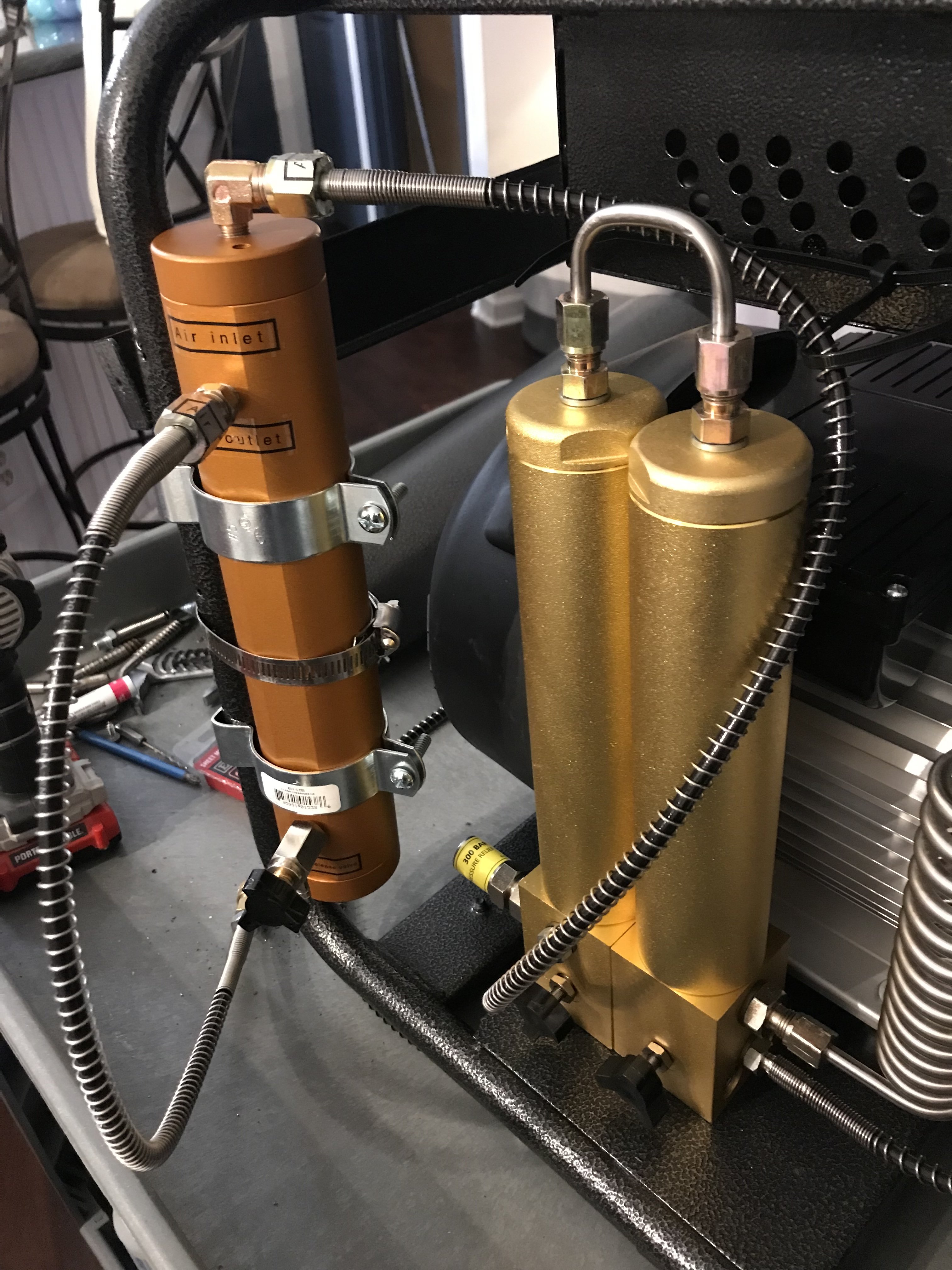

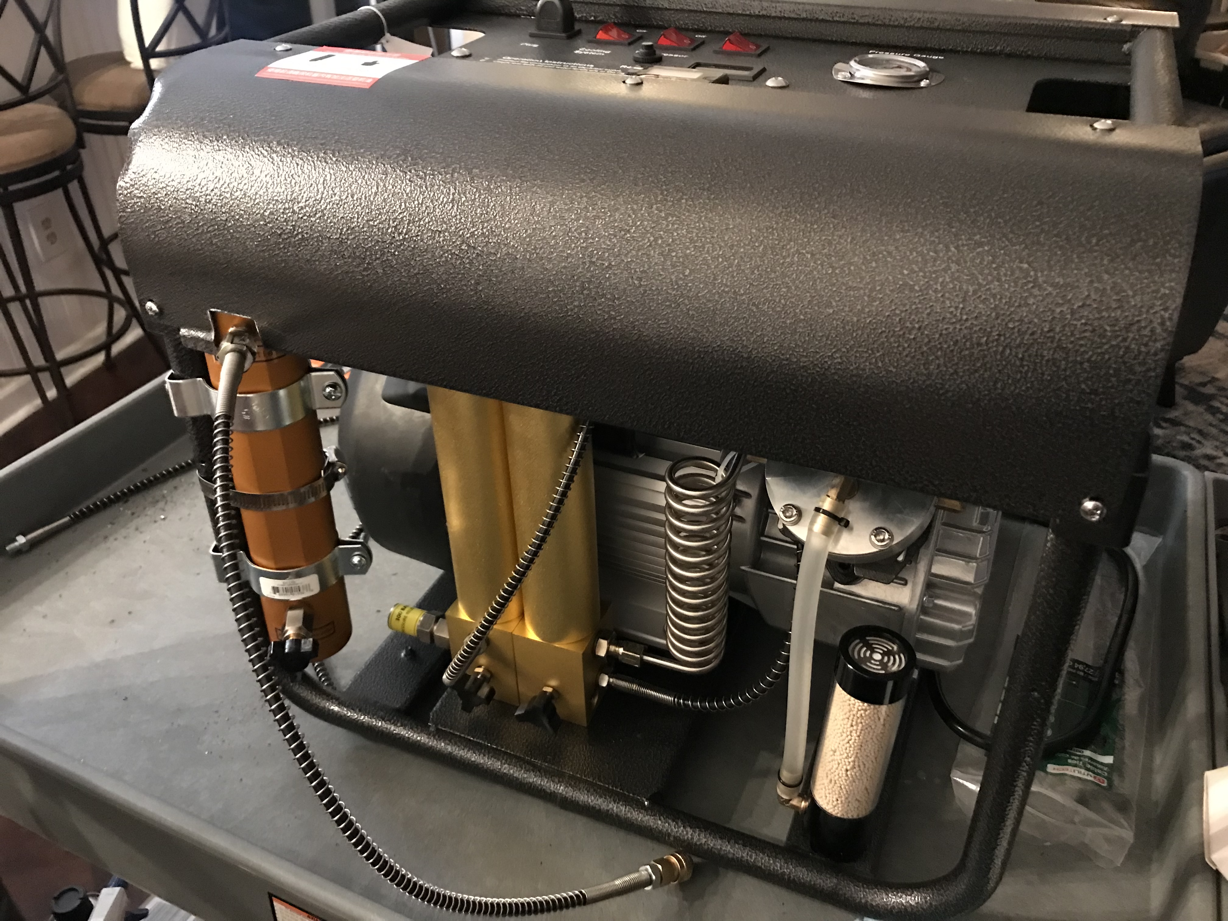

I wanted to share a couple photos of the extra filter I have installed on my 032. I ended up finding the clamps at Home Depot and then added a hose clamp to keep the filter a bit tighter to the frame. I did have to cut piece of the cover to allow it to fit over the filter. Tuxing sent me a new u-shaped tube that goes from filter to filter at the top since the original leaked. The replacement had to be de-burred and reshaped a bit but now it has no leak.

Very nice sir. I too needed a new prebent tube as original was overbent, not good for these compression type fittings. The extra filter you added...what brand is this and is it a water separator? That's got to add a little more time to get to pressure.
We're you getting water or moisture out of your line and felt the need for the added filter tower? I bleed the towers frequently and get a white moisture substance or water and oil out of them but nothing has accumulated on the hose end fitting when unplugged from the gun or tank. If we see it there we have a problem.
Yes it seems to add just a bit more time to get the system to pressure but nothing concerning. The filter is a water/oil separator purchased on Amazon. It's a Toauto brand. https://smile.amazon.com/gp/product/B077SX5G9V/ref=ppx_yo_dt_b_search_asin_title?ie=UTF8&psc=1

When I first received the compressor the u-shaped tube connecting the two filters leaked really bad. While waiting on replacement parts I had the other water/oil separator on hand and connected it to the first tower filter so I could at least use the compressor and break it in and leak test. After that I figured I'd keep it in place to add a bit more filtration to the system. Is it overkill? Maybe but if helps dry the air into the tank or gun it's cool with me. It's not too humid here at this time of the year but in the summer it may help even more.

Just a thought. With this separator you might be better served if this was the 1st unit to receive the compressed air from the coiled tube then on to the Tuxing twin. Would require some metric fittings but can be done.
My unit fills guns then autoshutoff. I then use the drain on the Tuxing 1st unit. Some spit/sputter as the system decompressed. 2nd unit air drain is always very dry. Take care.
