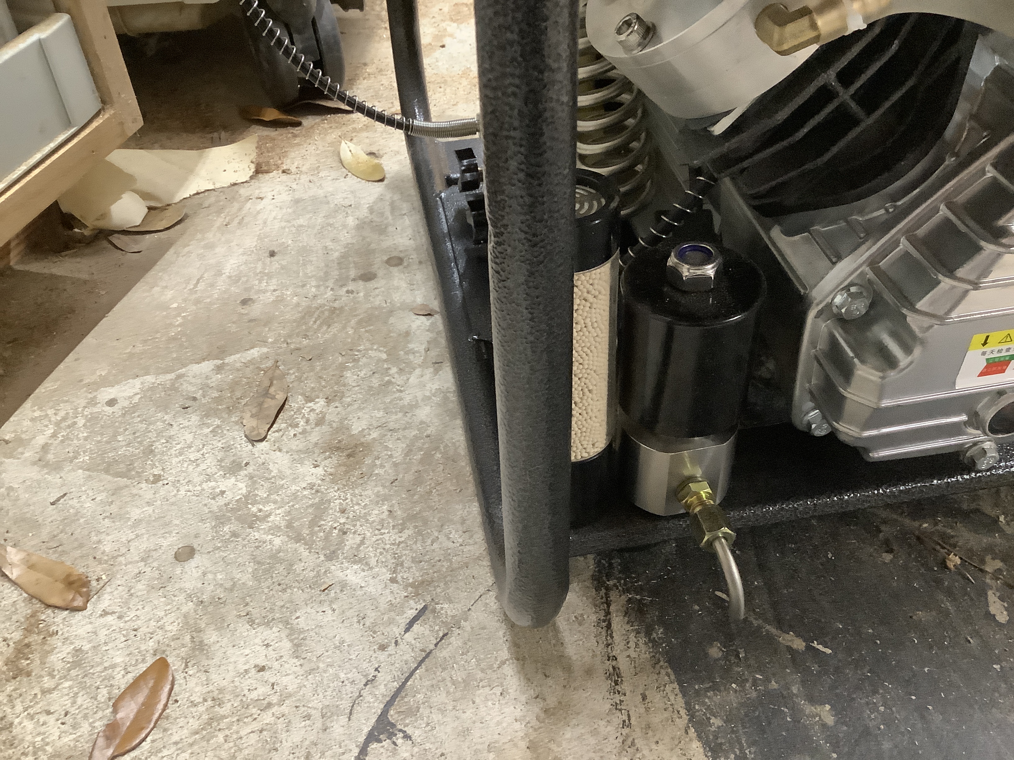

I haven't any problem loosening two screws either. I also have a purge unit with electrical connection to it, why is it here if it doesn't work? Perhaps it does I just never tried it. I'm gonna get it to work, it would be nicer to have the water and oil shot out of that little tube. And auto shutoff is nice, I believe there is another electronic gauge used on some models from what I see. Hatsan has employed Tuxing to build there compressor's also with the nice gauge.
I notice the filter towers are the same height on bottom part on Amazon, but some like mine have a taller bottom on right filter! My model has the auto purge and it works but it's not supposed to be on here. I bought the fancy gauge from Amazon for 29 this morning, should connect right up, Tuxing site does not offer the upgraded gauge. I would only buy this compressor off of the Tuxing site not Amazon site.

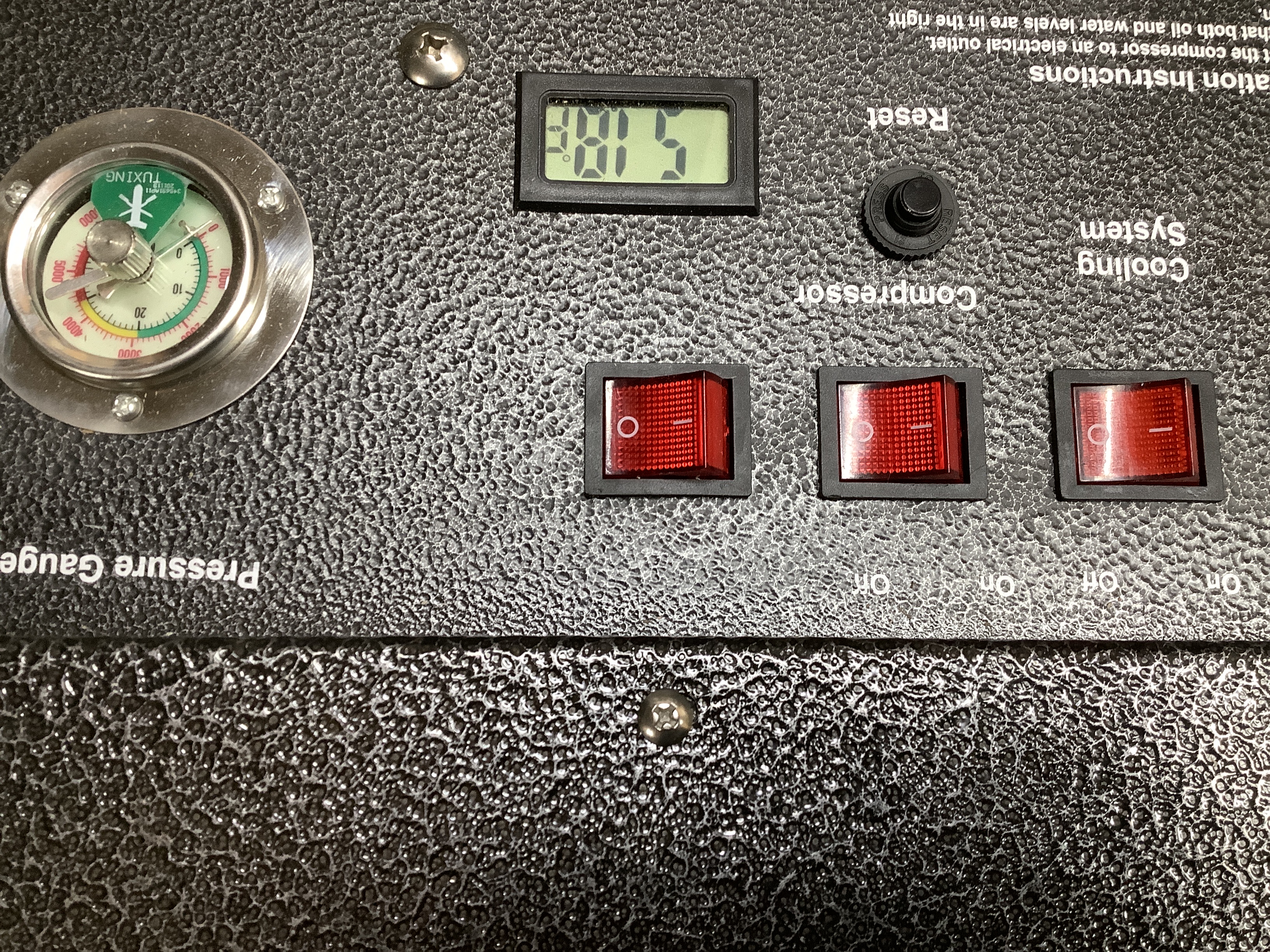

That one has a digital gauge. I think the gauge sets the auto purge time interval and the rocker switch only turns off the feature

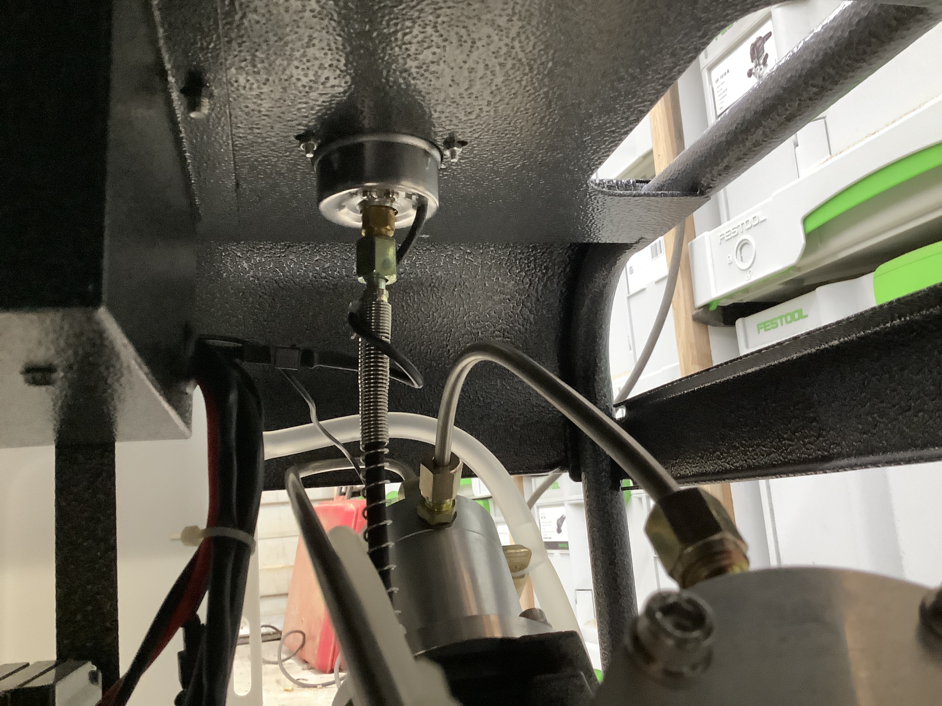

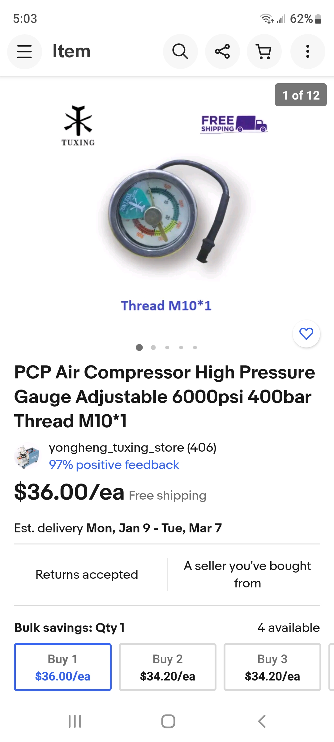

I can't say for certain, but I replaced my gage on my Tuxing compressor TXEDT032 with a new one at no charge from Tuxing. The gage I measured was a metric M10 x1. You can always measure your gage threads with a set of calipers...there is enough thread showing to get a reading so you don't need to disconnect the hose. Then see if what you have is proper diameter for M10 or M12. Just a suggestion.
29 on Amazon for the gauge it has a wiring harness that appears to be an exact replica of what's on mine and I'd bet a dollar that it's an exact fit. I've bought it but won't get it till Jan 6.
I spoke to soon it might not fit. Thread size is M12 I don't know why they'd use m10 for the other one that's on here. Probably have to replace the hose from the gauge to the filter. It might not be a bad idea to replace that hose with a better one anyway.
You can keep the dollar, Hope you can find the M12 hose and fitting for the filter side of the connection.

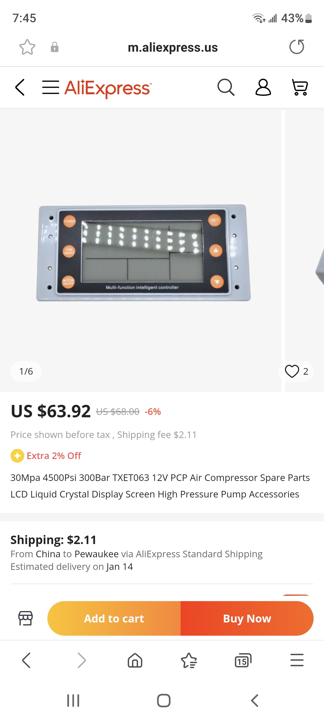

The electronic control unit is different, you can see them on AliExpress.
