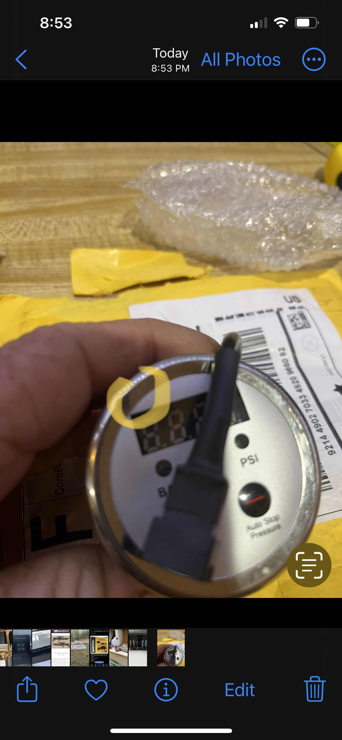

I received my gauge. It's dented.
It has a four pin connector and the one that's on the 033 has two pins.

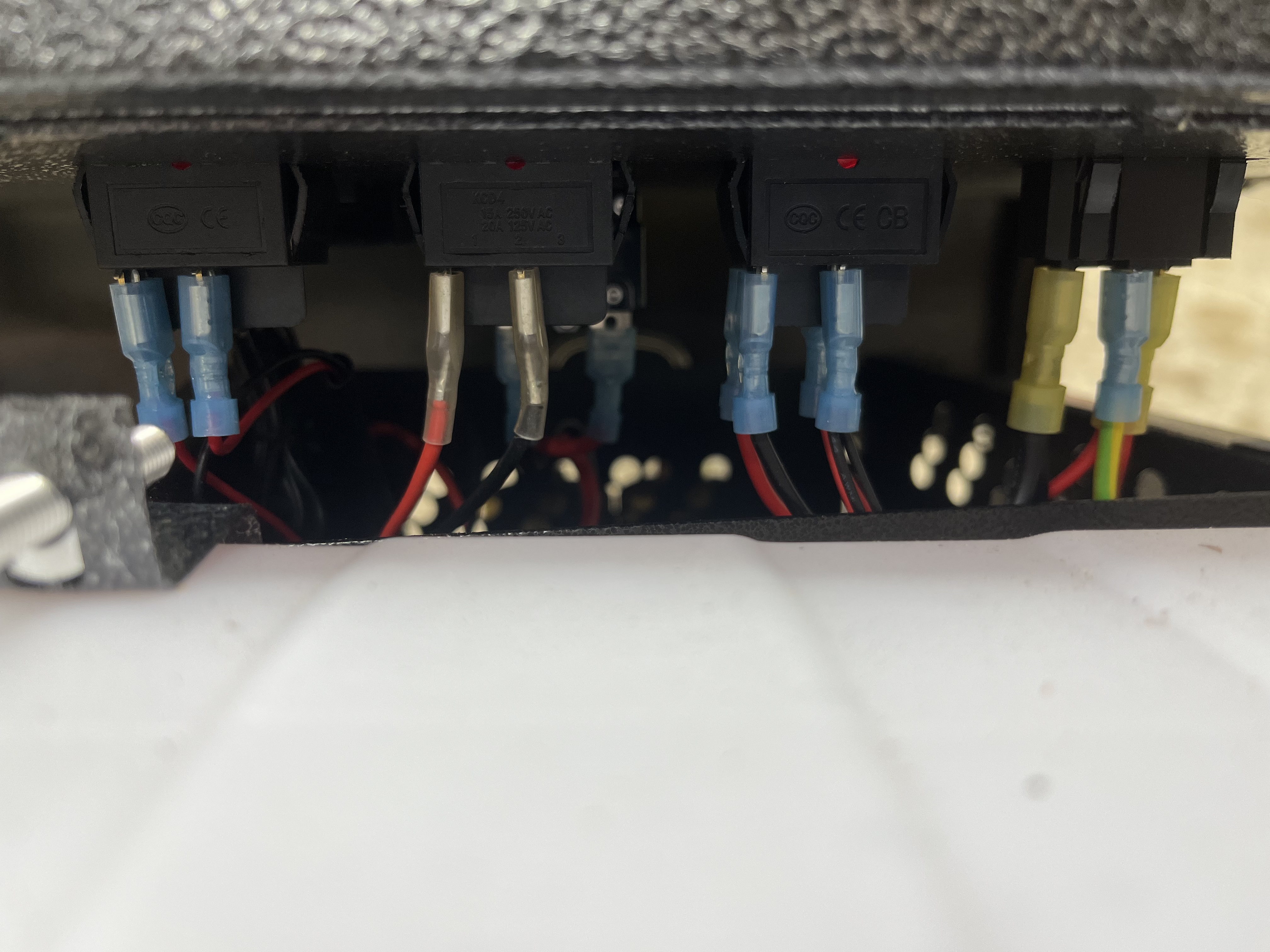

I'm looking for an electrical box for the 031, none are specifically listed by model #, they're simply 110/220 or 12 volt, and you assume any liability by ordering the wrong one. Also I don't believe they come with any instructions so if the wires are different colors and amount of wires how can we do this mod successfully unless a member who owns an 031 takes his apart and shows us a photo. It's imperative we label each wire before unplugging the mess to get to the elec box.
I ordered the control box and another digital gauge from the 031. They wouldn't identify the control box separately. Once I get it I'll check the supply voltage for the gauge and identify the 4 wires. Then all you need is a little power supply for the gauge and a 2 wire to 4 wire harness with the power being injected. I can send you the connectors or amazon links. Bought a 10 pack of each.
Your saying I don't need to purchase a control box off of a 031 to convert the 033 to dig gauge and I also want to be able to input purge times? I just need a power supply for dig gauge. Tuxing isn't as responsive as they once was. I actually received the wrong compressor and just told them. I'll see what I can get for free.
