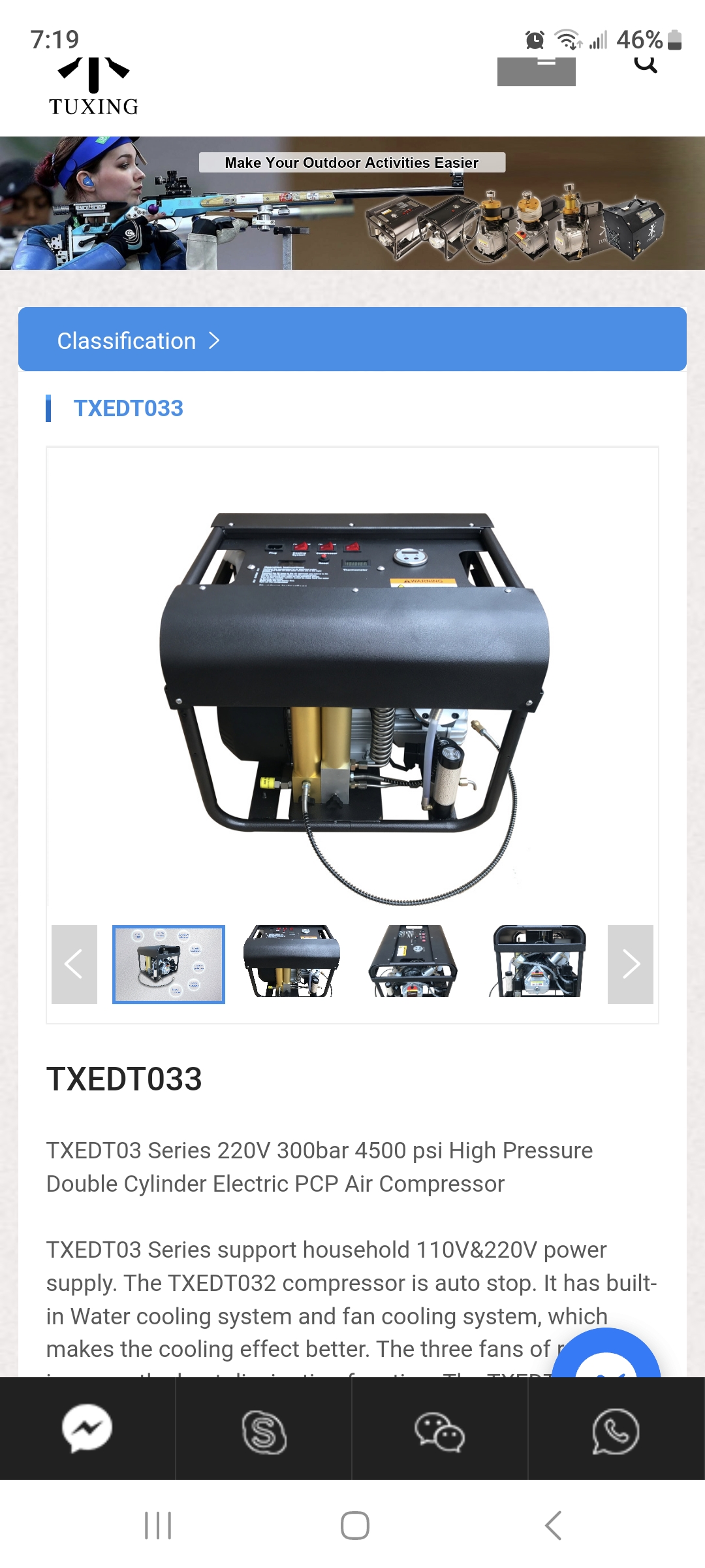

Yep...that is exactly how the 032 purchased as Autopurge was designed to function. That's also why the Autopurge of the design you received is no longer listed as an option onTuxing site...it's a misnomer. That's why Autopurge was changed to 033. And 032 is now Only Autostop.

I should complain and make Tuxing take this 033 back. I ordered an 032 and pictured it didn't have a purge unit. Only because they want to charge me 159 dollars for the correct electronic box to operate said dig gauge and to truly transform mine into a true 033. If what your saying is true an 033 now has digital gauge, auto stop and purge! So technically I don't have an 033 I have an in between model

No the 031 is digital but the 033 is mechanical. The 031 has more filtration than Air Venturi version but less than 032 and 033. 032 and 033 run double filters but one of the filters looks smaller to give height for the purge connection.

No the 031 is digital but the 033 is mechanical. The 031 has more filtration than Air Venturi version but less than 032 and 033. 032 and 033 run double filters but one of the filters looks smaller to give height for the purge connection. Don't worry my electronics should be here in a couple of weeks. Once I can check the voltage we should be good to go. We'll have the pinouts and the voltage.
And that wasn't on there site when I bought what I bought. Or I would've sprung for it. They were obviously making some changes and they sent me an older stocked model. And now they want to charge me the price difference of the two to convert to that model. Which I think should be less because now we have to source other parts and figure things out without any instructions.

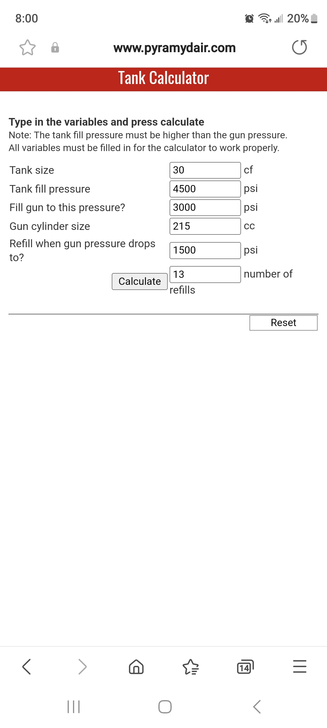

Man, I had to fill this mrod every 30 shots. From 3000 to below 2000 on the gauge I would fill it. If I'd shoot 40 rounds it would drop to 1500. Someone said I could top off this rifle 19 times with my 3L tank, that's not true either. I would literally run the compressor every 3 days to top off the tank if shooting the mrod. It was an air hog but now it's going bye bye. I ask how you only use yours an hour a month?
1 hour is three fills, 18 gun fills, 1000 shots, 2 tins. I’m not shooting slugs, I exited that rabbit hole. 18.14 in .22. 25gr in .25
