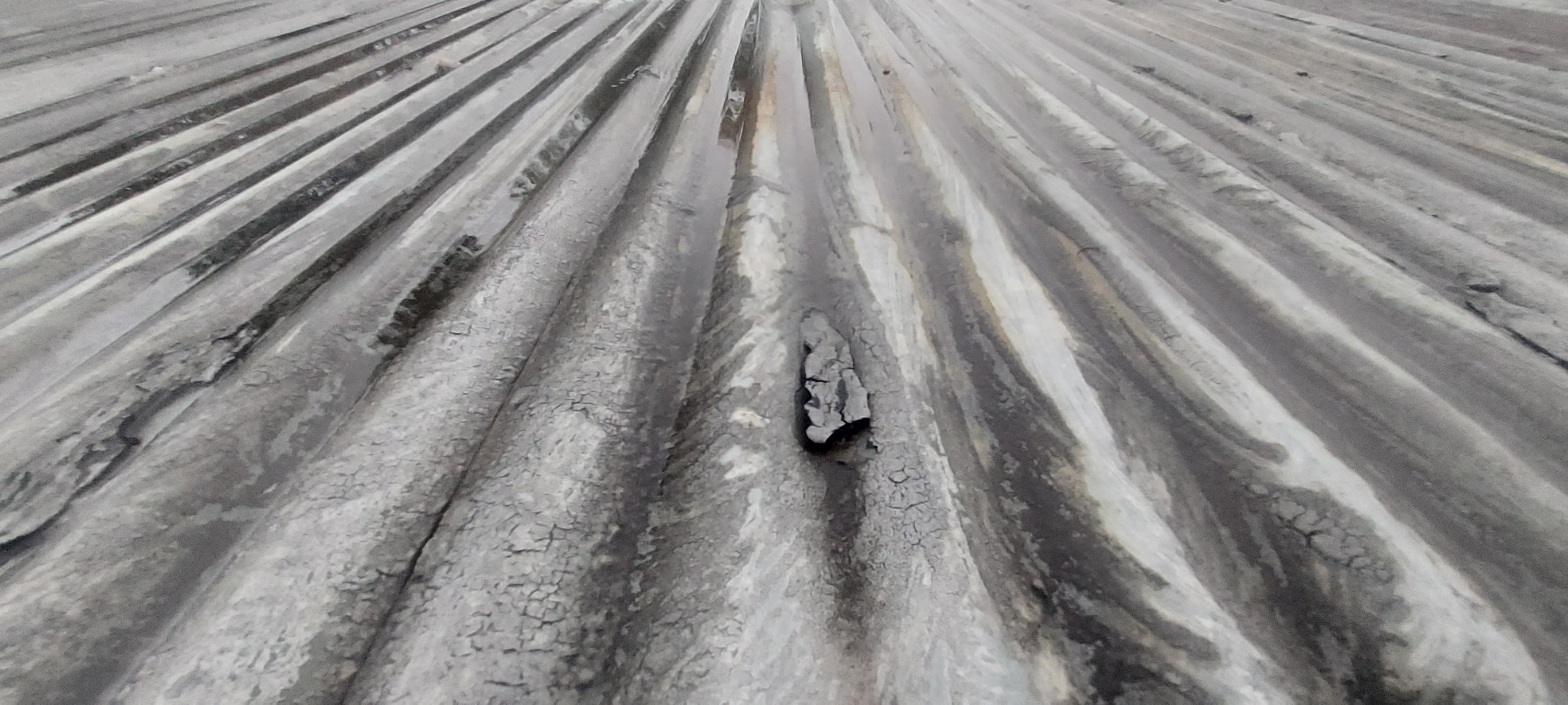

They been running a ad for a new kinda spray on roof here .. ( spray over old)
If i see that run again ill get the name and see if theres a link to a home page to it..
When i first seen it i thought industrial sized flex seal. Lol
Oooooo!👀 I've seen that spray foam insulation too but man ...the install price 😵 spray roof?🤔I am definitely intrigued
Thanks!🤪🤙stick my head in the crawl space under the house today; said NOPE, then chucked bug bombs under there like a swat team raid🤟🤣
It's been around but this seems new / better stuff .. you can google like spray over shingle roofing and see some..

Foam is expensive and a bad ass heat block. But i would suggest Blown insulation it's easy and cheap, put floor in attic treat dead space under and all walls even interior ones. Take a little extra care sealing around light fixtures electric boxes etc.Help hold heat and cold in and huge sound block. You have a lot of metal if any way possible best permanent cheapest fix for roof. Your window's are your biggest liability good ones aren't cheap but you can do one at a time as budget allows. Do all and your house will be cool and warm as any new one. Spraying worn out shingles is like painting rotten wood don't waste your money doing that. Good luck look hard enough should soon see light in far end of tunnel.

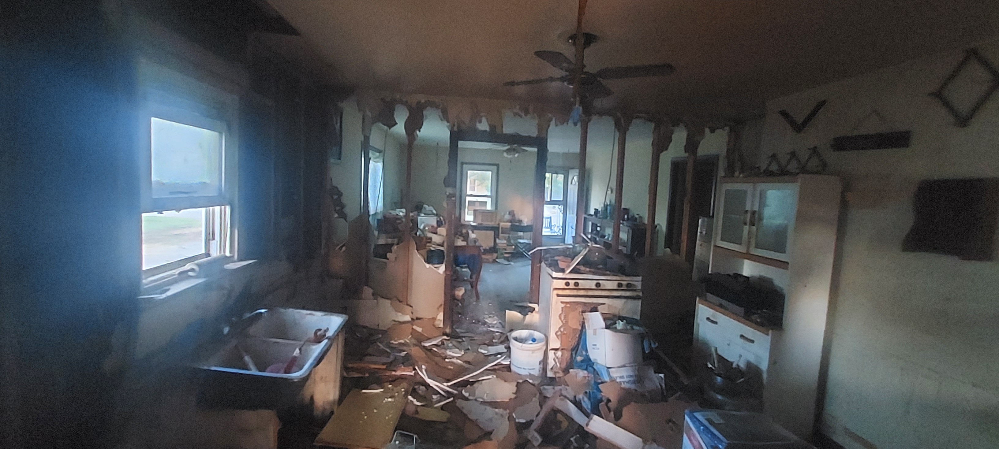

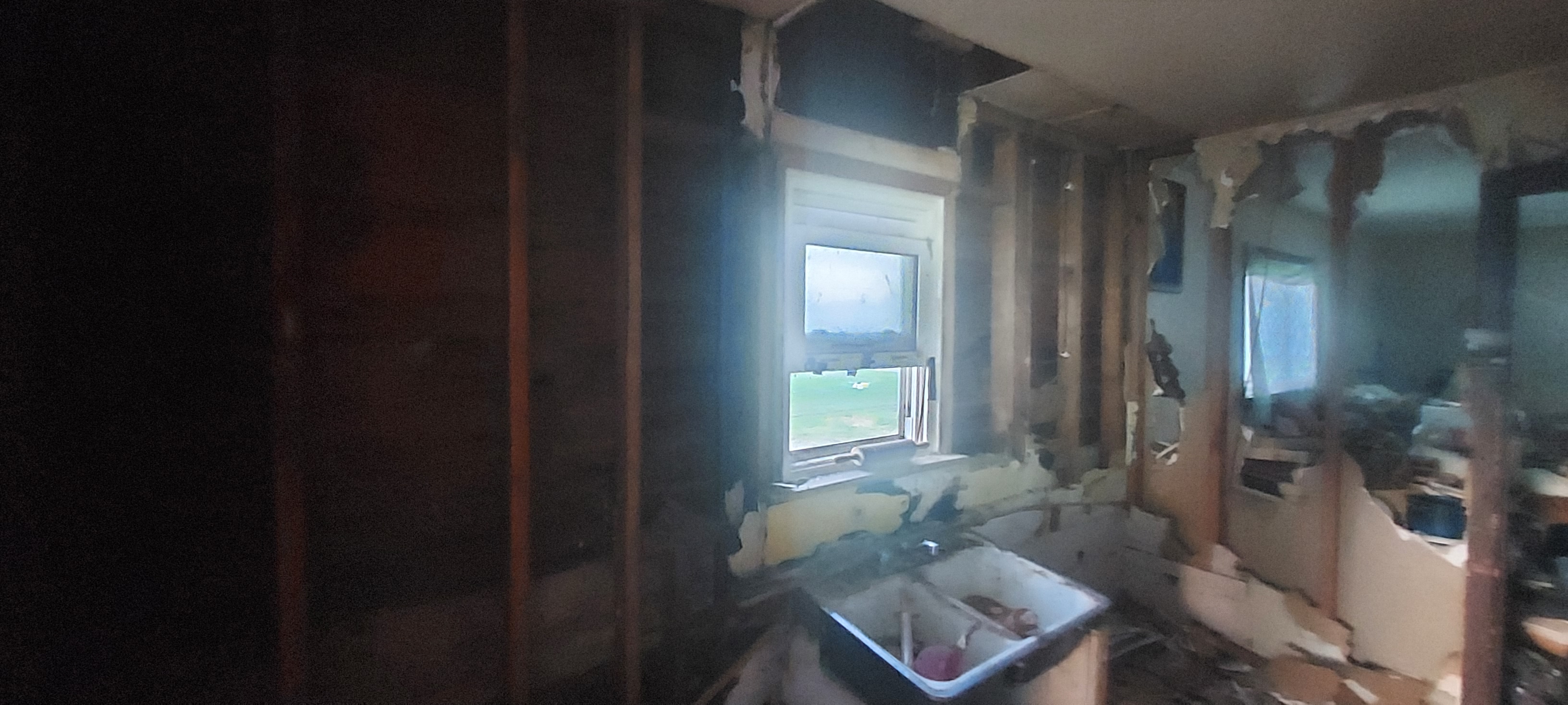

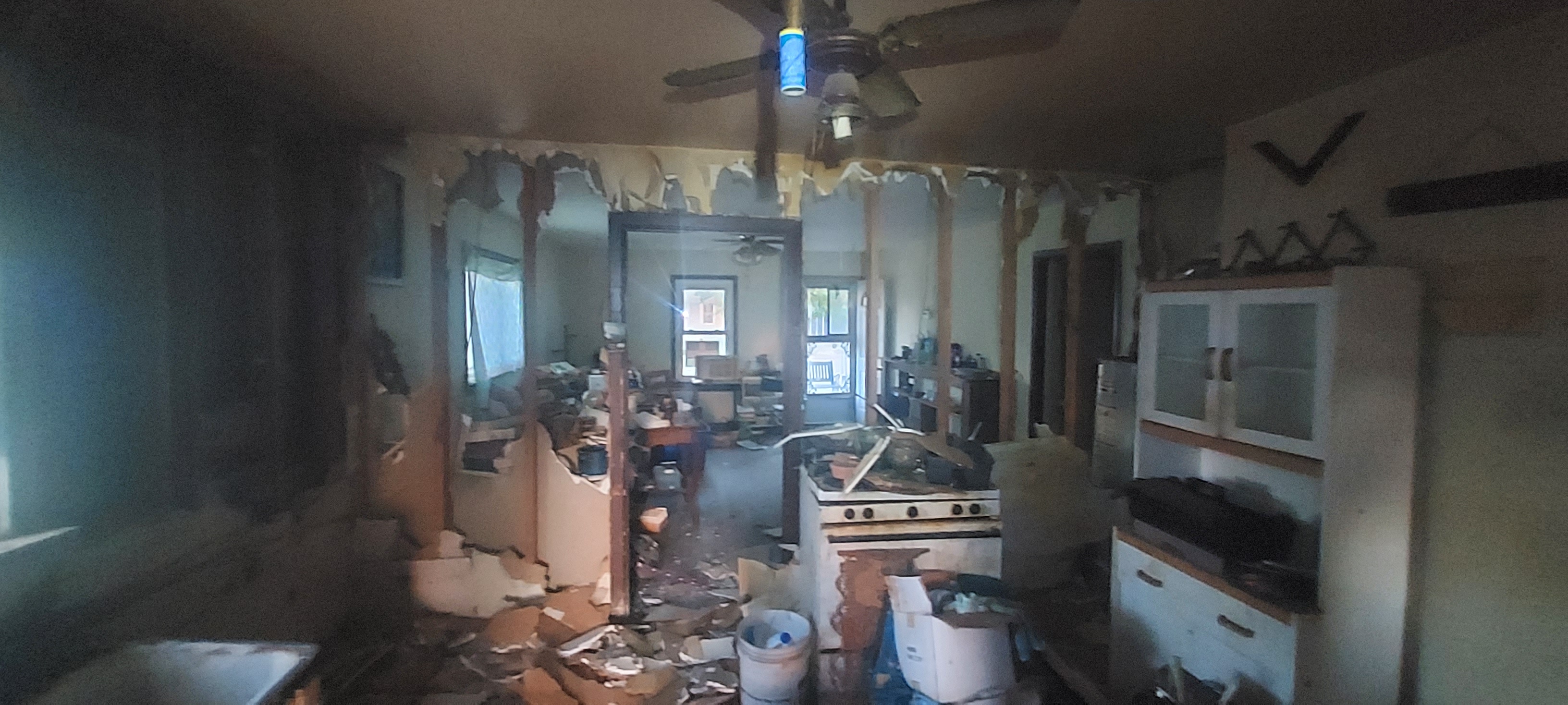

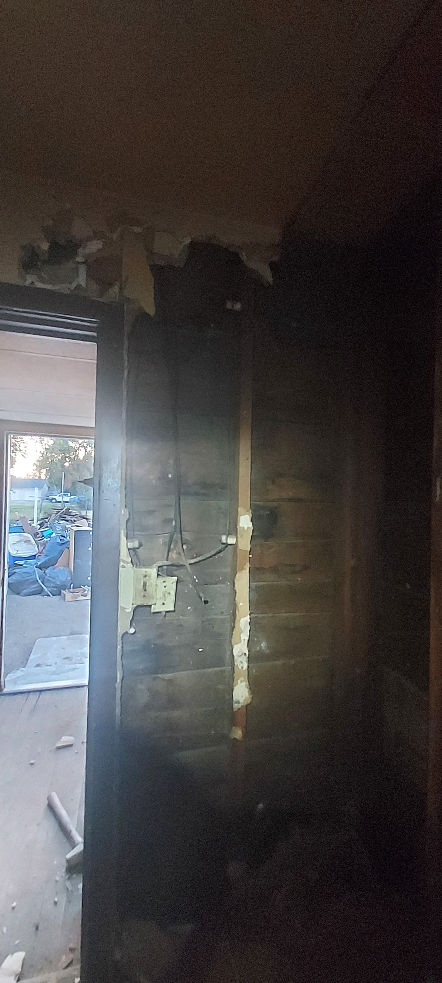

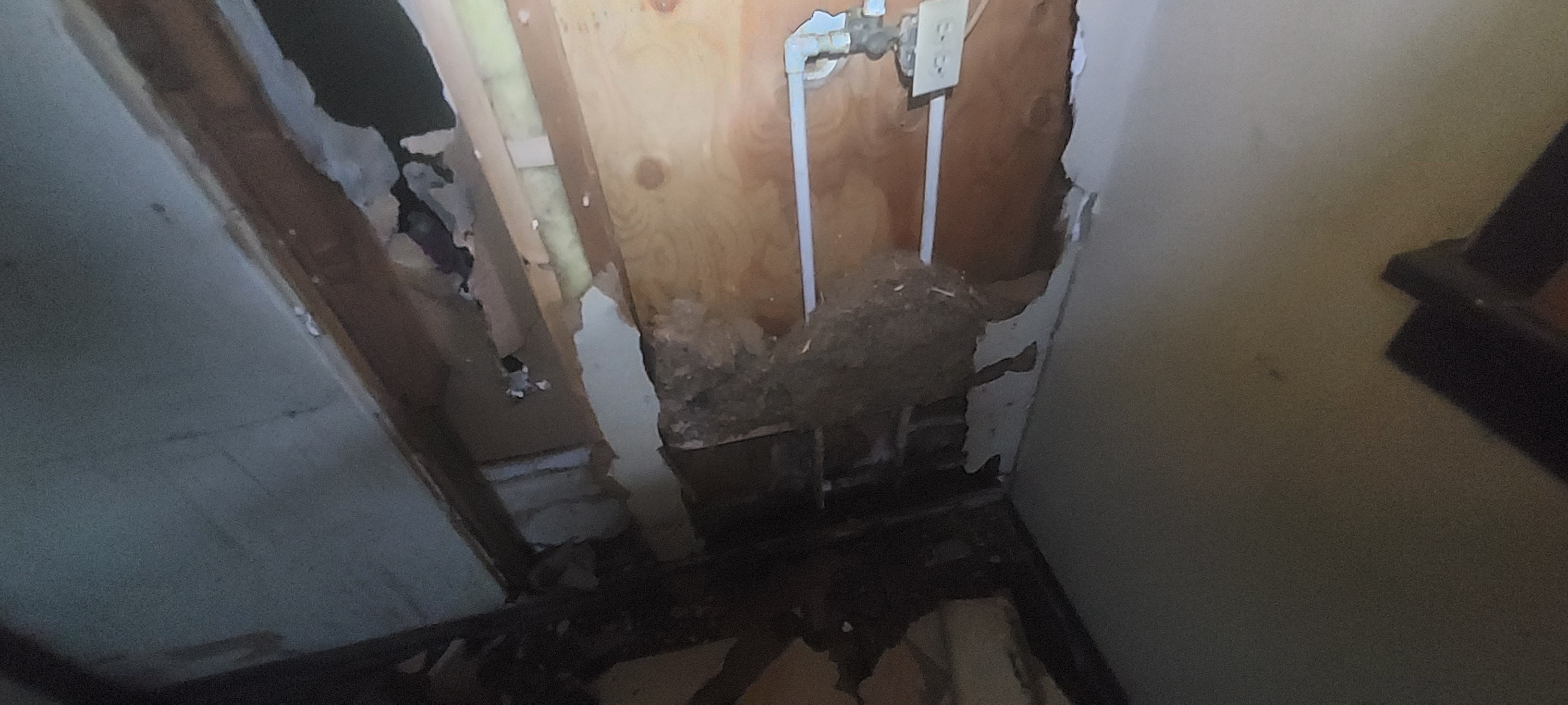

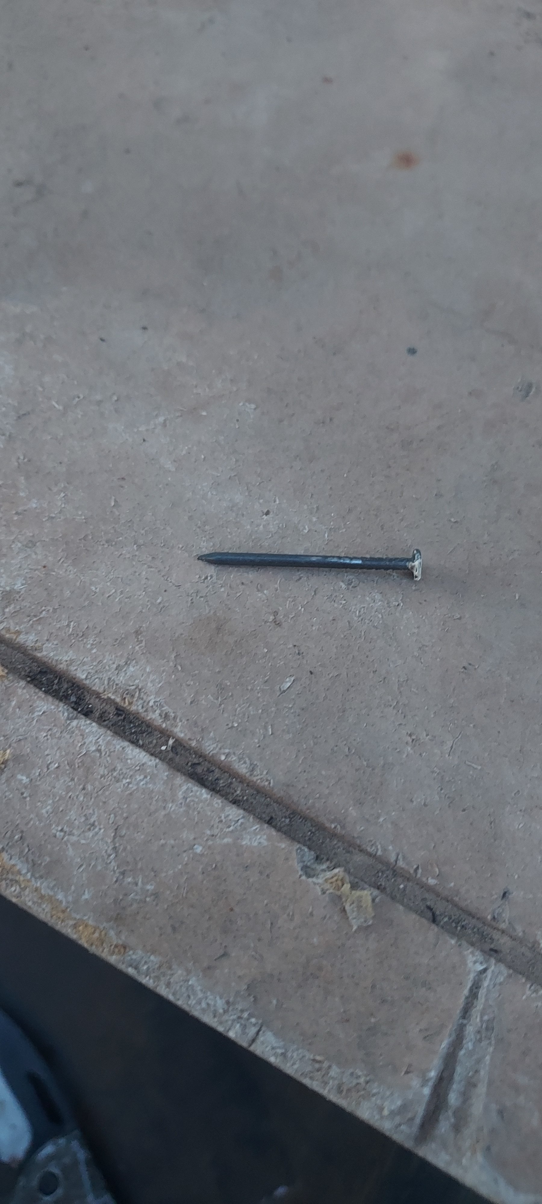

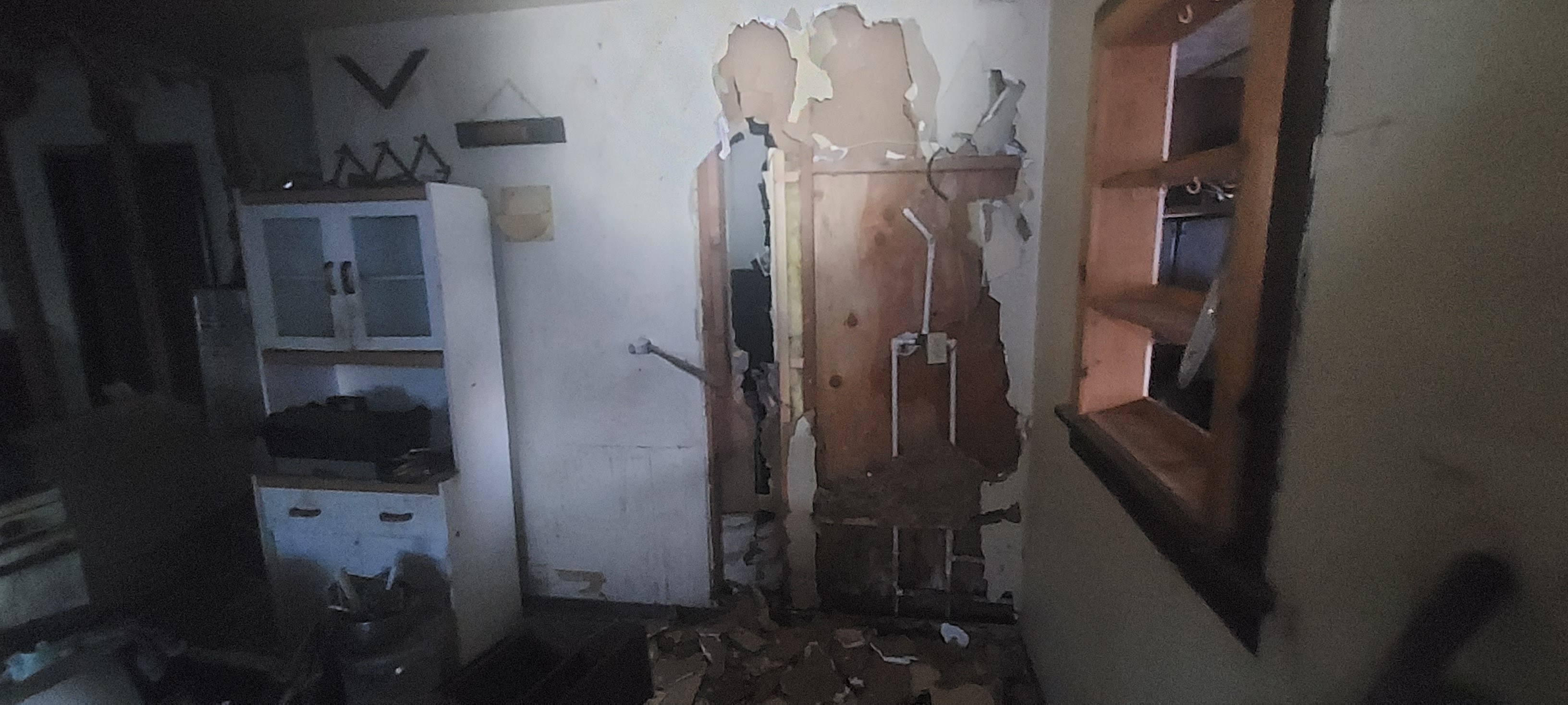

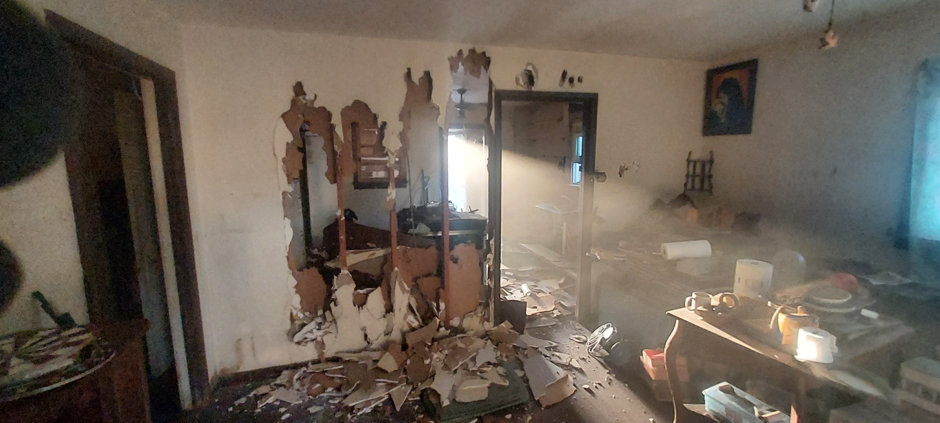

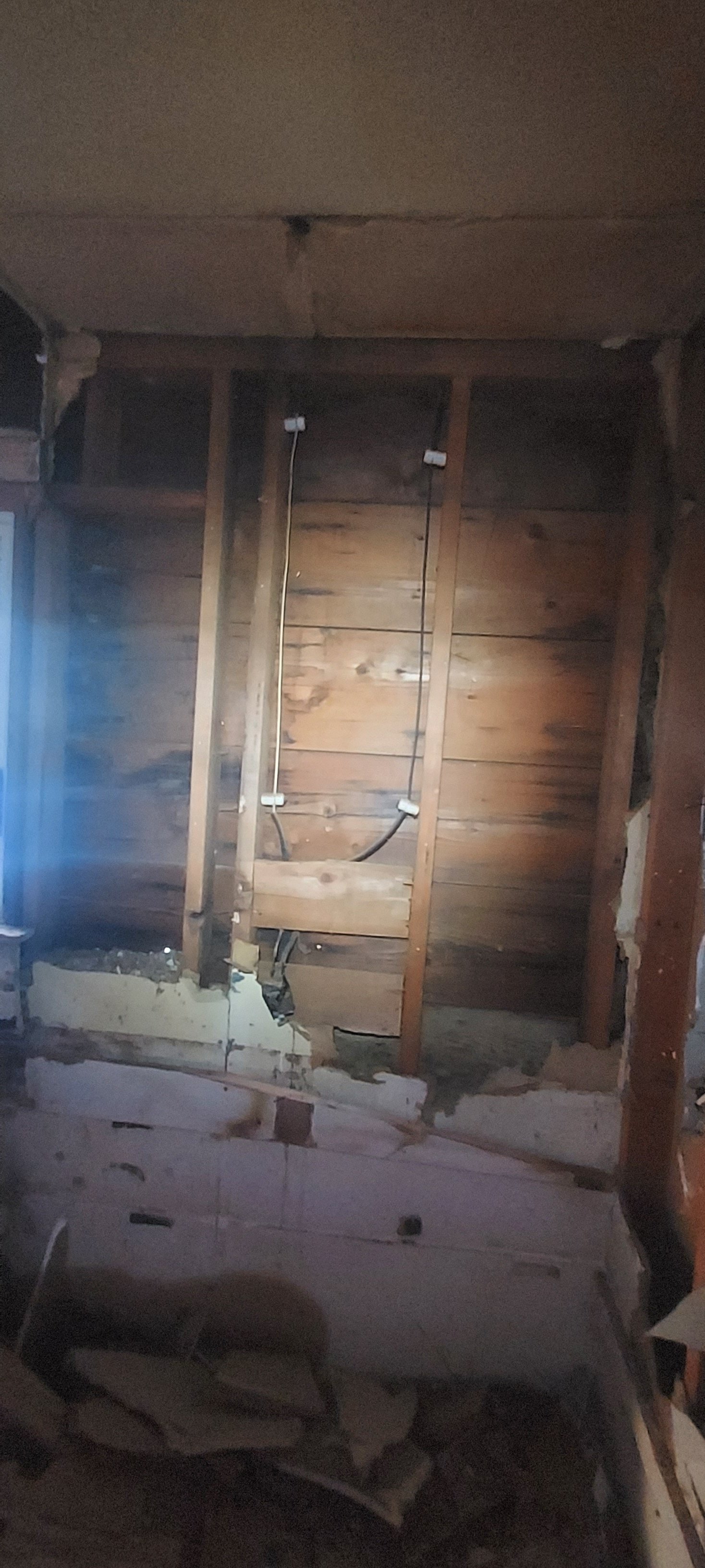

Sweat poured out of this man today!🫠 had some time and a hammer. Huge mouse headquarters located, olddddd woring identified, a nail felt like a tiny rock in my shoe, so ibstopped for the day. Pictures/video tell the rest of the story
That old knob and tube wiring is a big scary…plan on addressing that, please 🙏
That WILL be totally torn out and replaced. Already have had a guy come by and gander at it beforehand. We WERE just gunna try and rerun some new stuff by. Not now!😅gunna rip ALL of that old wiring out and start new lines in every single area. Not gunna risk it. That's why I haven't got the electricity turned on yet as well🙃 the squatters before had even tied into it on the outside. So glad it didn't burn down.🥹 I'm planning on new breakers, wiring, outlets,...the whole shubang

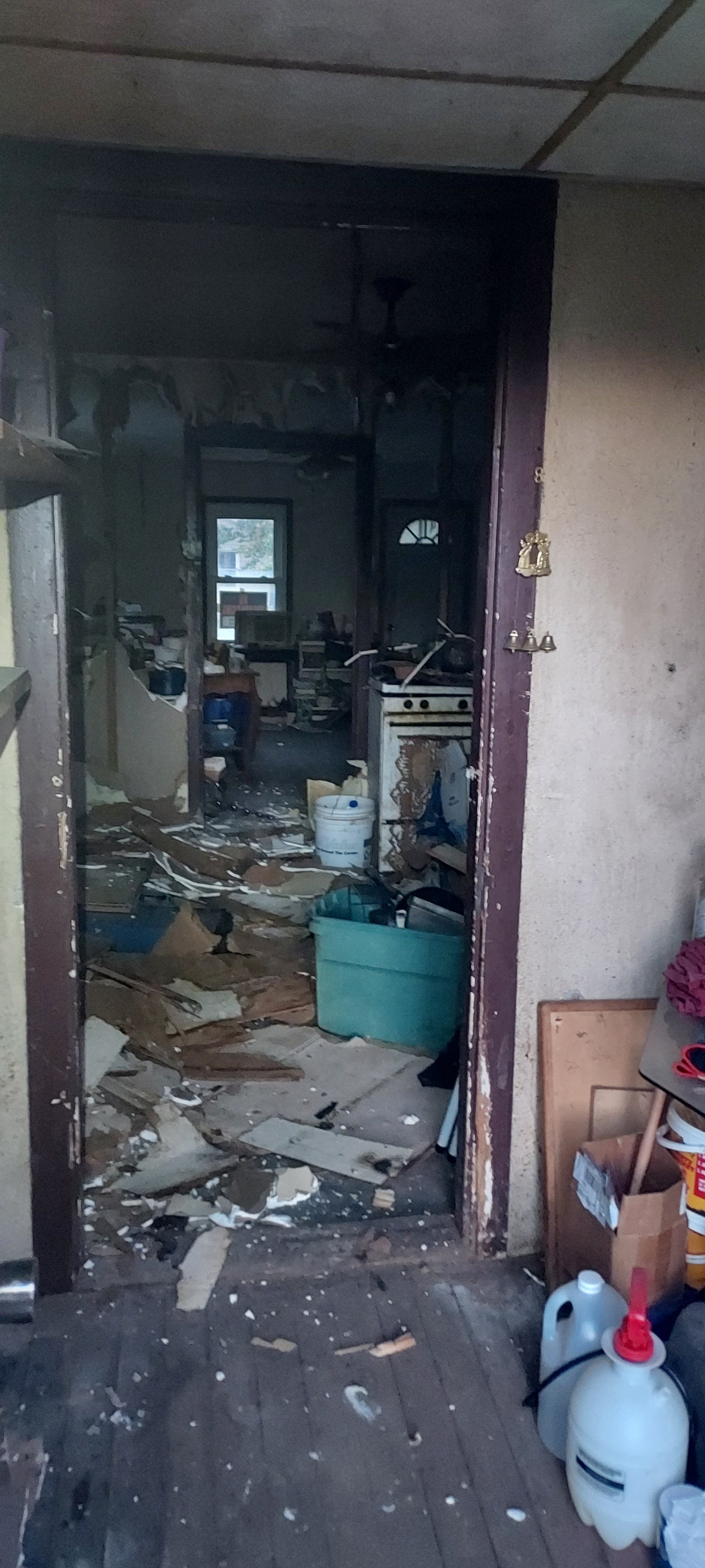

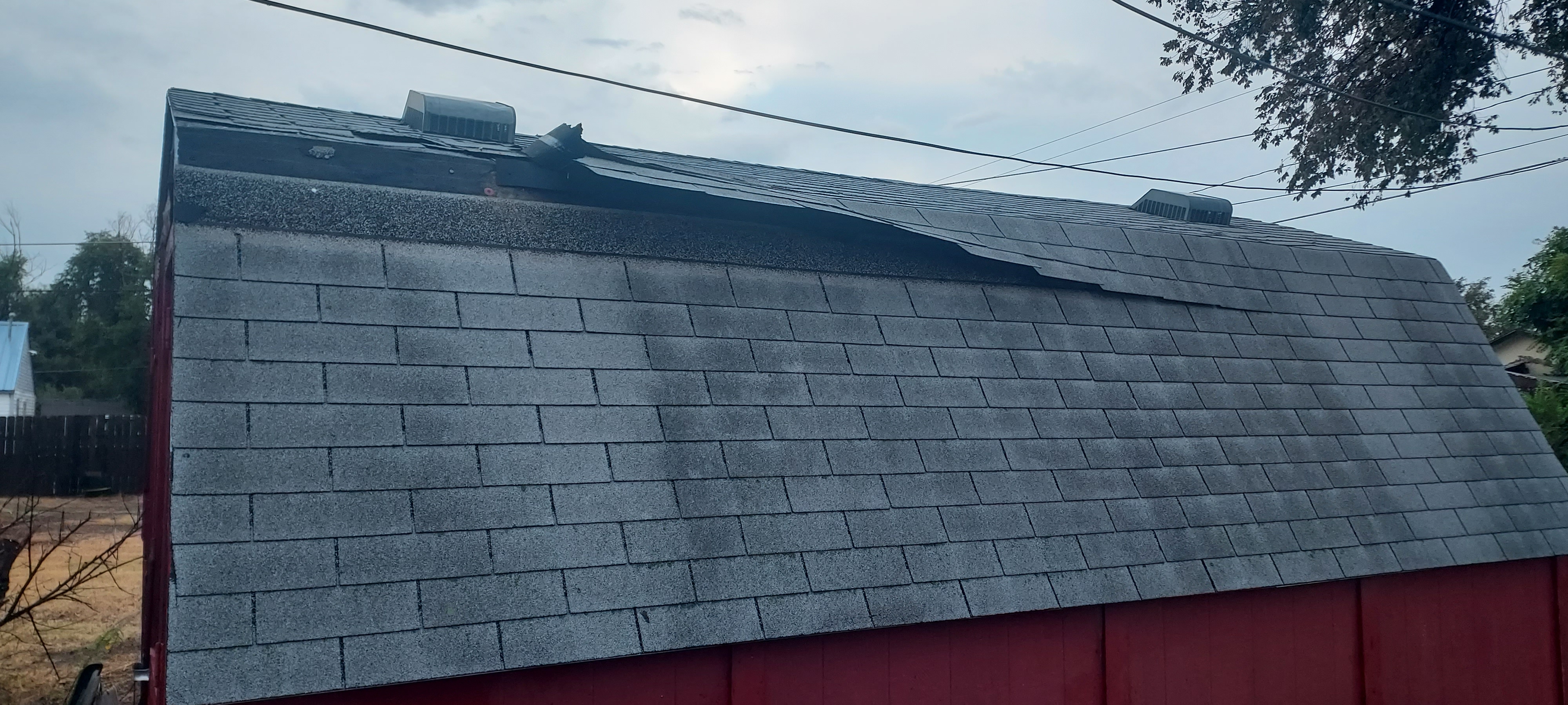

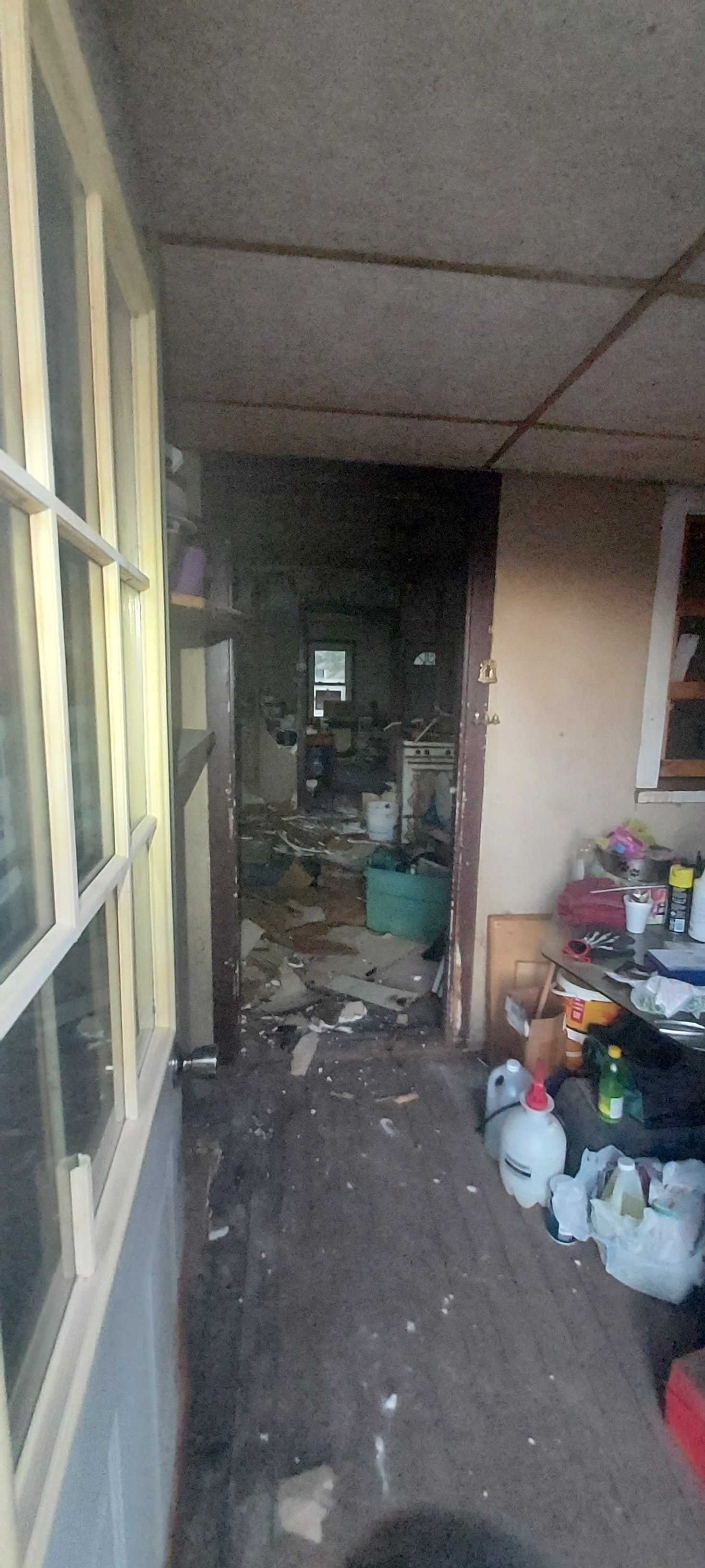

Got all of the trash out of the house and the garage.. finally totally out! The fridges and freezers from both the house and the garage. Got my tool truck from my previous place. So now i can sort my tools and setup the garage for normal usage. Then...mother nature said hello😅
My grandfather had built a little red shed when I was about 14 or so. And WOW...it finally got some damage. Aaaand the garage roof leaks a bit😵‍💫so I have 3 roofs to fix now🤷‍♂️ but hey, they say God only gives the hardest tasks to the hardest workers...or something🤣🤙still not gunna stop me! The neighbors across the street moved out about 3 weeks ago. Lucky move because their vehicles would've been smashed by the tree limb that toppled down.

Looks like that fiber " tin looking" roofing panels ..
For temporary and may last a few years as well maybe do that koolseal .
https://www.koolseal.com/
Kinda like that spray on but you " paint " on some brands mop it on ..
Check your home Depot or lowes type places and try some over the leaking areas ( patch over ) spots and see if ot stops leaking and gives you one less thing to deal with for awhile..🤤
Thank you! I'll take a gander n see what I can get ahold of🤓🎩🤙
