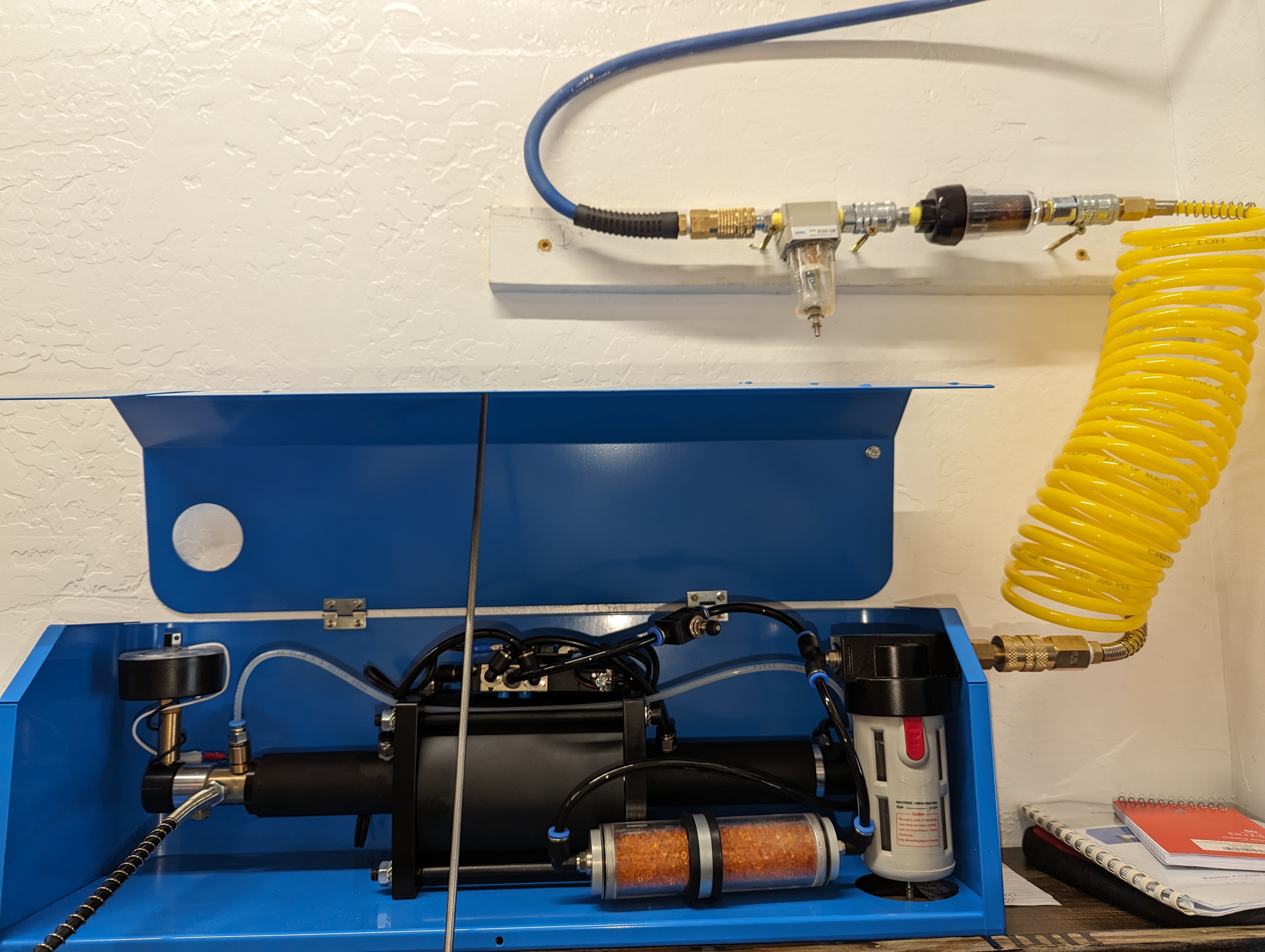

Like most booster pump users who end up Rube Goldberging the situation, I also added some more drying components a few months ago. The water separator and desiccant canister that come housed within the booster are sufficient, but I wanted an external drying source, with more readily available connectors/fittings than those used by Altaros.
So here are my added components.
Bought dessicant with the same color change as what came from Altaros: orange is dry, green is wet. In the above photo you can see how orange it still is in the OEM dryer. And that the small silica canister in the upper right is wet (green).
Here is a closer image...
I swapped it for fresh silica at this point, roughly halfway through the 90 minutes.
I do get a fair amount of moisture at that first blow out, at the end of the blue hose and before the dessicant/silica.
I'm still running a tampon filter on the output and it is bone dry with the above. Even the OEM Altaros water separator right inside the box is seeing 0 moisture now.

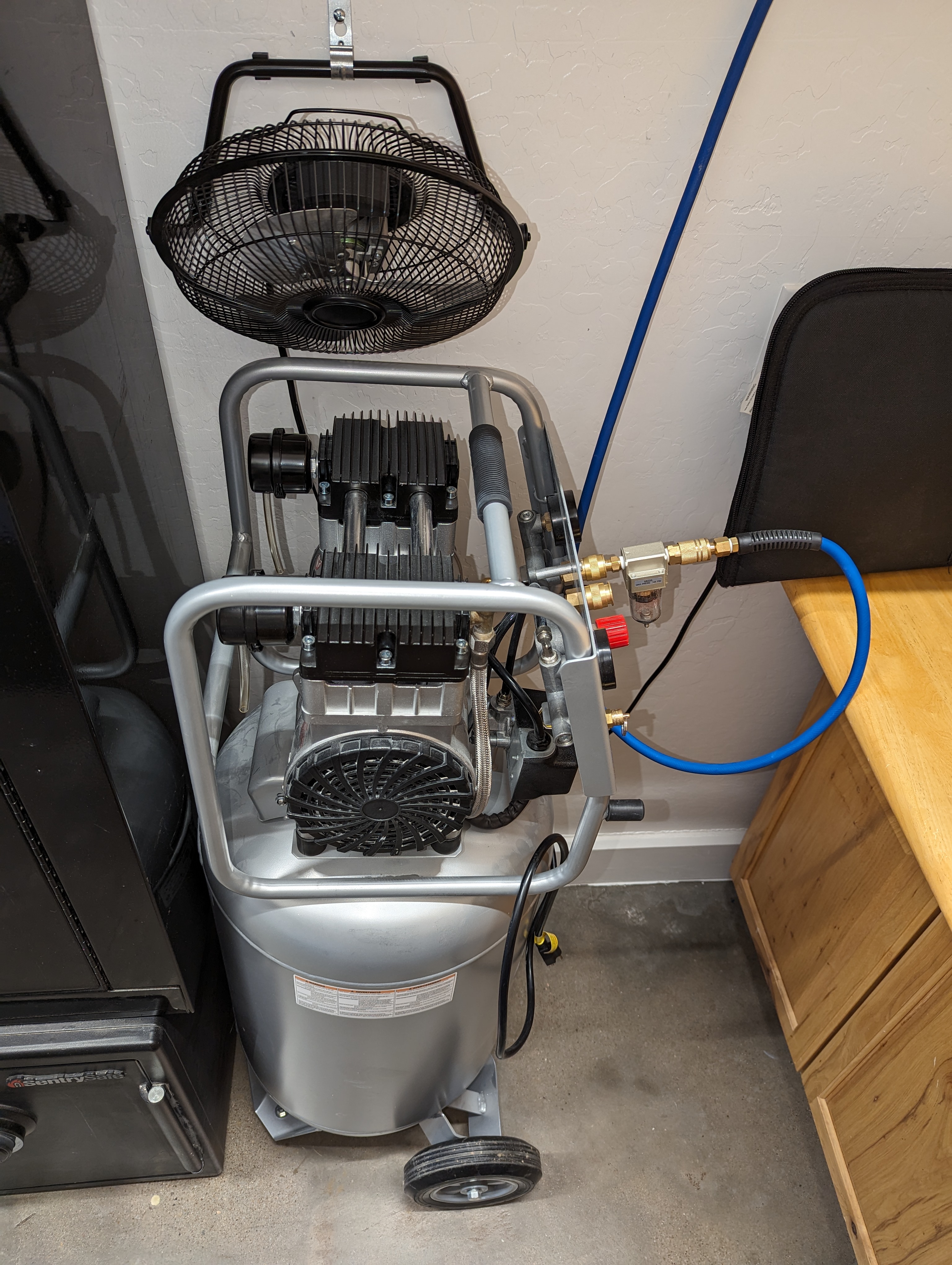

I also added a better fan situation for the heads on the California compressor. Already had the fan so no additional cost incurred there.
