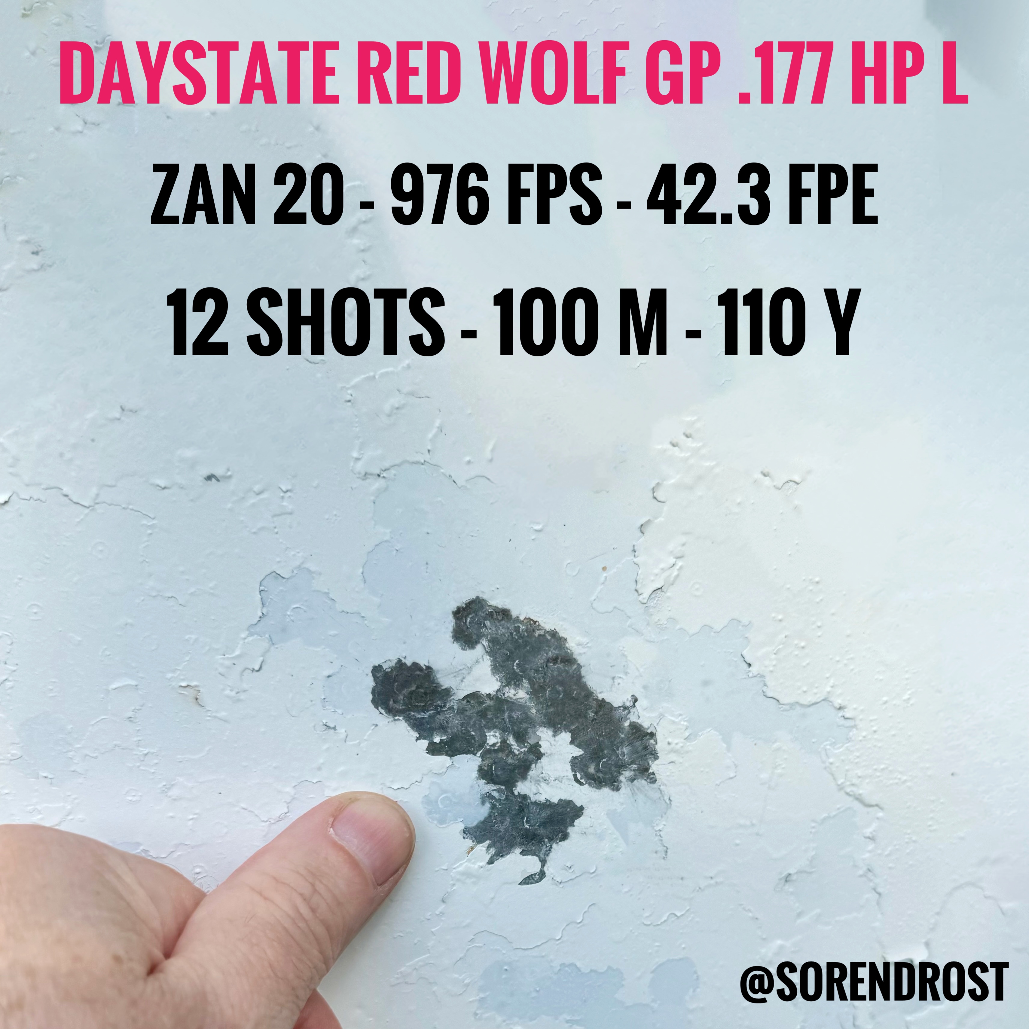

The LW 28” slug prototype barrel that I am testing at the moment in a Daystate Red Wolf GP .177 HP setup is doing great with the Zan 20 gr slugs 👍🎯🙂
