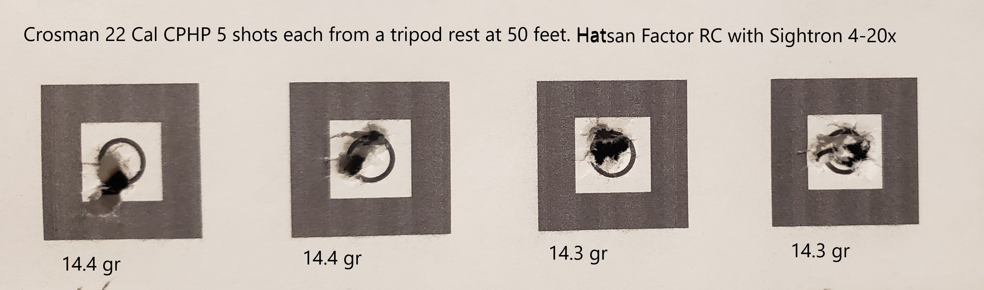

I test fired the sorted pellets this morning and there was a slight shift in POI at 50 feet indoors between them - see photos. I fired two 5 shot groups from each lot out of my Hatsan Factor RC shot from a tripod rest which is a bit wobbly. I know I can cut these group sizes down a bit from a solid rest, but for indoor testing I need to build a bench rest that is high enough to shoot across the furniture in the two rooms I am shooting through into the garage!
Not sure what to think of the first group from the 14.4 gr sorting. I might have had the rifle canted to one side but was not aware of it. The 14.4 gr sort does seem to have the most POI shift of the bunch.

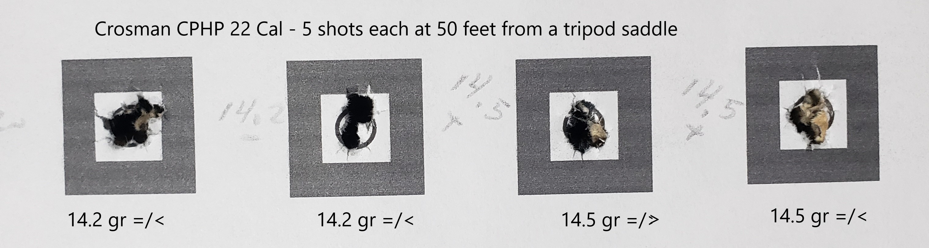

I recently read some posts where the authors stated that weight was not as important as head size, so I will probably be getting the tools to sort by head size later. I was surprised by how slight the difference in group size was between the sorted lots. I don't think I will bother weight sorting after this test with this lot of CPHPs unless I decide to start shooting at competition events. Some of my other brands of pellets have rather large weight variations, so sorting by weight might help, but I don't shoot them much since they cost more than these CPHPs and they don't shoot very well in my Factor out of the tins like some others do. The only other pellets I have tested out of a dozen+ types I have on hand that shoot as well as the CPHP are the JSB Jumbo Heavy 18.13 gr and some H&N 30 grain HP slugs. I weighed some JSB Jumbo Heavy this morning and found a variation from 17.9 to 18.3 grains which is pretty close to the CPHPs which ran 14.2 to 14.7 grains.
