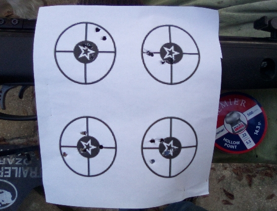

I shot quite a few more of the weight sorted CPHPs and couldn't see any improvement in group size between the sorted groups. From what I am reading head diameter and skirt inspection are the two most important sorting aspects as long as the lot of pellets you are using don't have a huge variation in weight. The unsorted CPHP pellets shoot great in my Factor RC. Sorted or unsorted they don't do much better than about an inch for 5 out of my Prod at 50 ft. If I were to start shooting in FT matches, I would probably just shoot the JSB Jumbo Heavys out of the tin, as they cut the group size from the CPHP in half most of the time and I have not had any fliers from the bench.

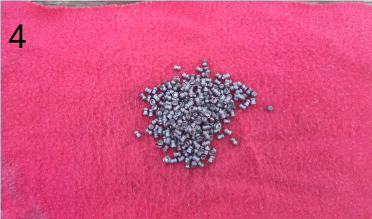

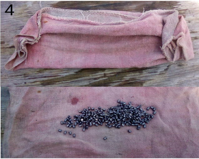

I don't have any evidence of the lead chips that are sometimes high in number with tins of CPHP pellets, sticking to it and impacting accuracy or feeding but if there is a chip of lead inside the bottom cavity, and it stays there when firing, I could see that maybe causing fliers. I just don't like dealing with the chips so I shake each new tin in a sieve with holes that let them fall through into the trash, then put them back in the same tin. I am still mulling over the idea of lightly oiling them with silicone oil.
I clean mine most times use a fleece rag and shoe shine buff them , the fleece traps and hold the flakes pertty well enough. The i use a lightly olied rag (Alphabet org fluid) and re buff for a lube coating.. sometimes a pretty dirty tin i will wash.. it all depends on how the tin looks when i open it ,. Sometimes/ most i shoot stright out of a tin as is ..

a lot of us use lemon Pledge , spray on a paper towel (moisten not wet ) and gently roll pellets across
Don't matter if you shoe shine buff it down as thin to nothing with a rag.
Heck ive used car wax ( i think ive about tried everything handy around here..lol)
Add your lube to the rag center dunp in pellets , fold it, work rag back and forth to buff and tumble. What helps in thay is keepinf crap out of the inside of the pellet skirts ,. I found that to be big overall. (Opinion)

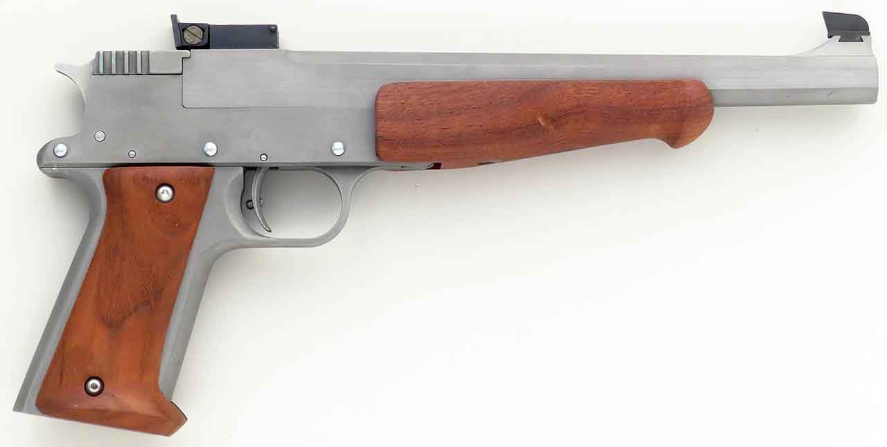

All my pistol competition over the years has been with iron sights. Never did any rifle matches. My favorite setup for IHMSA 200 meter centerfire unlimited would be a hooded front sight with a peep insert and a hooded peep rear sight on a Remington XP100 chambered in 7mm-08. The production guns I shot all had blade fronts and notch rear sights - TC Contenders in 22 LR & 7 TCU, 44 Mag, Dan Wesson Revolvers in 44 Mag and 375 Supermag, For a while I had a Wichita single shot production gun in 7mm IHMSA, S&W Model 41 and 17 in 22, High Standard Trophy 22 LR and a few I can't remember. I wish there was an airgun field target match within an hour of me. I do enjoy shooting reactive steel targets every week but informally.
Pushing 70, I find that I can't shoot the iron sights like I used to, but still like them! This is a photo that looks pretty close to the Wichita 7mm I had.

That looks like its built to last a long time (y).
