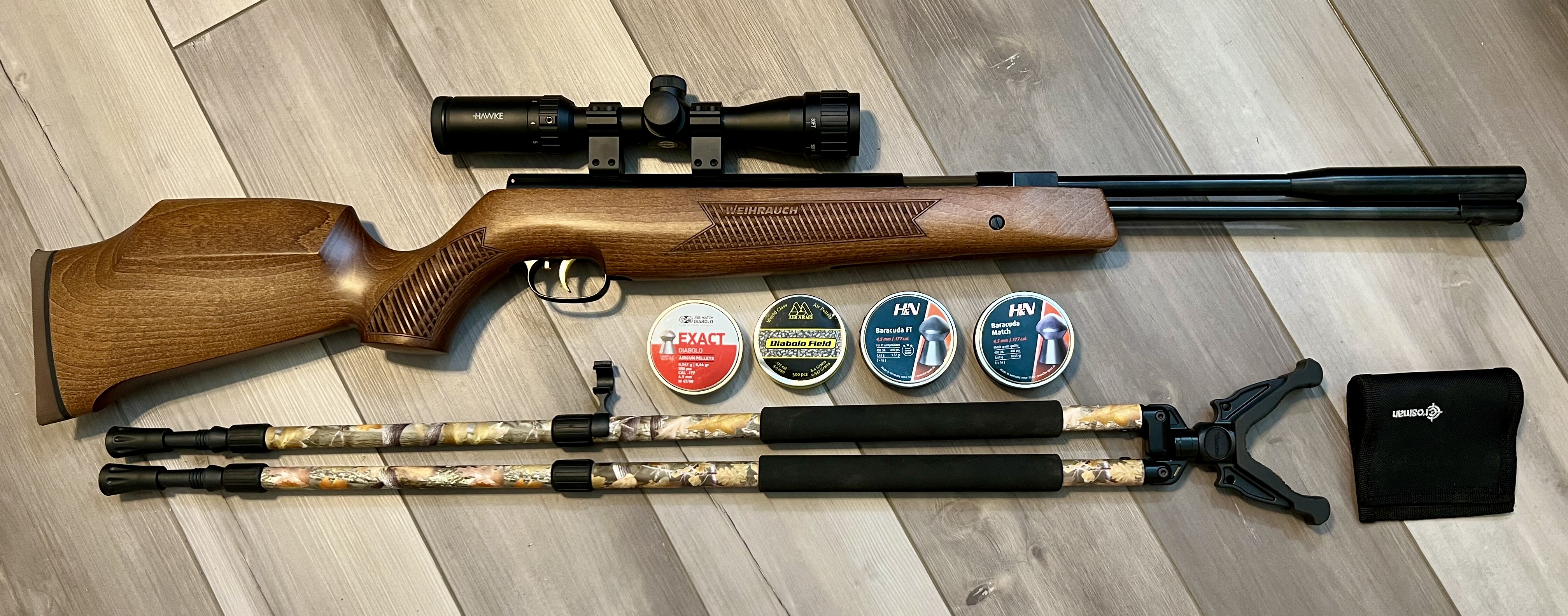

Hello there! Are those the pellets you recommend for the 97? I’ve just ordered this gun and hoping to save some $s on testing brands. Thanks for any comments. 😬
Reactions: bustachip
I'm not the original poster, but I have a 97K. Mine will shoot several pretty good, but the best accuracy I've got out of it, is with the QYS 8.48 domed, JSB Exact 8.44, also Air Arms 8.44.
It kinda depends on how the pellet fits your particular bore. You want a semi snug fit, and you can tell when you insert it into the barrel. Generally speaking, loose fitting pellets don't group as well and often will be flyers. Back when I first got mine all I ever shot was JSB Exact 8.44 and they were great. As the years went by I tried many others until I found the QYS 8.48 domed would out shoot the JSB's 8.44. But like I say, it will depend on your particular barrel.
