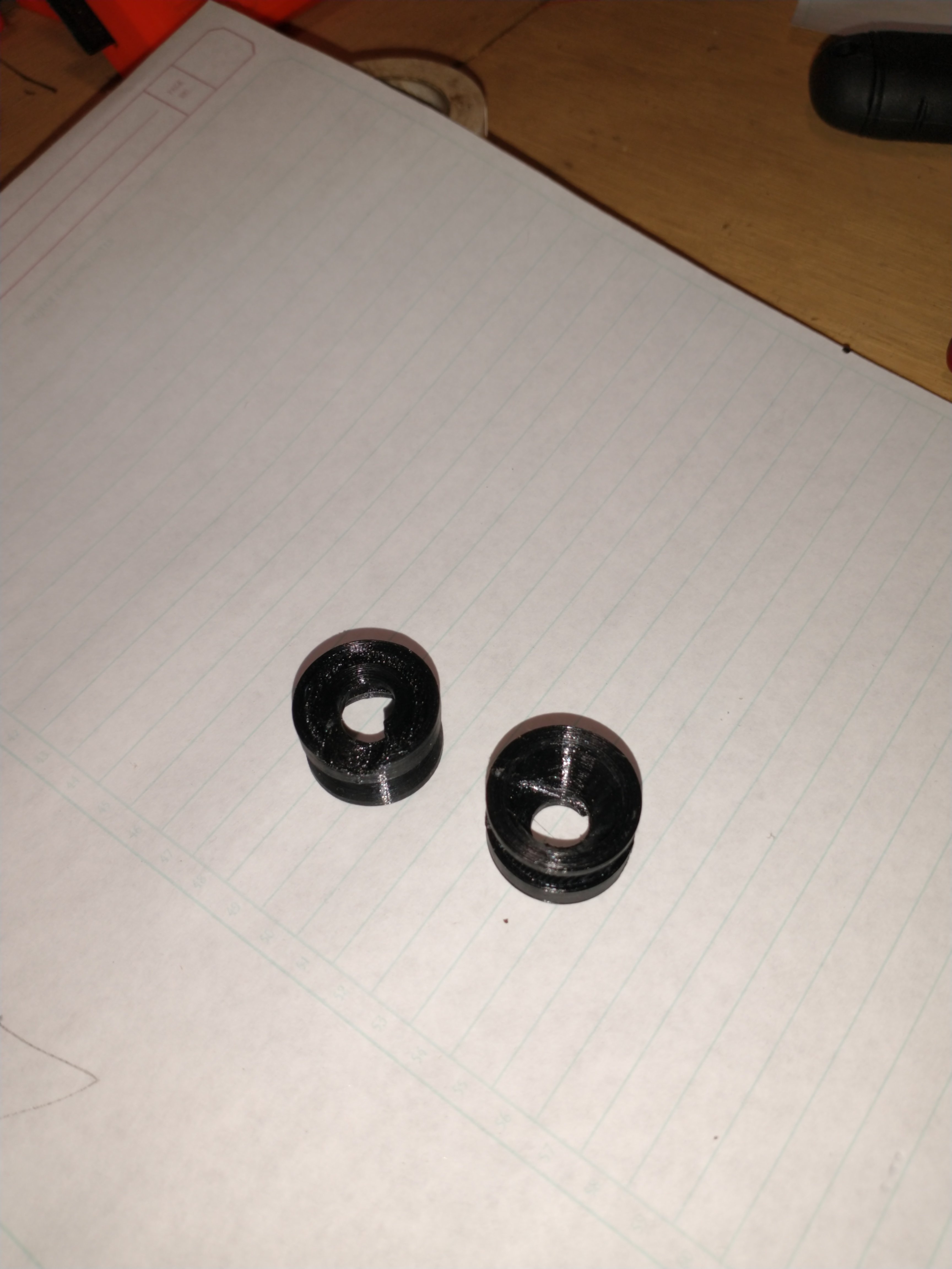

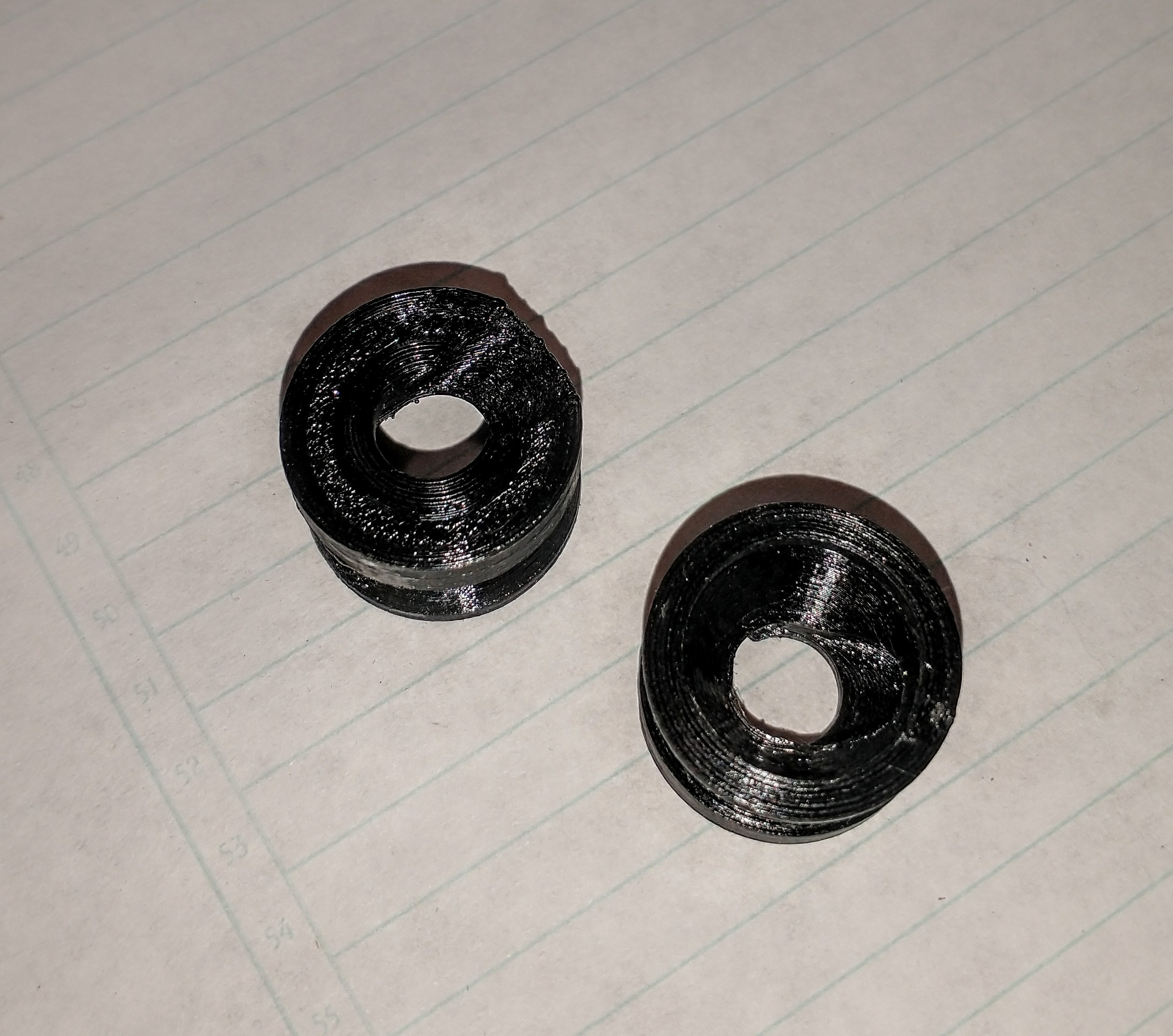

The K baffles are coming off the printer very nice now.
These are for a Stormrider moderator.

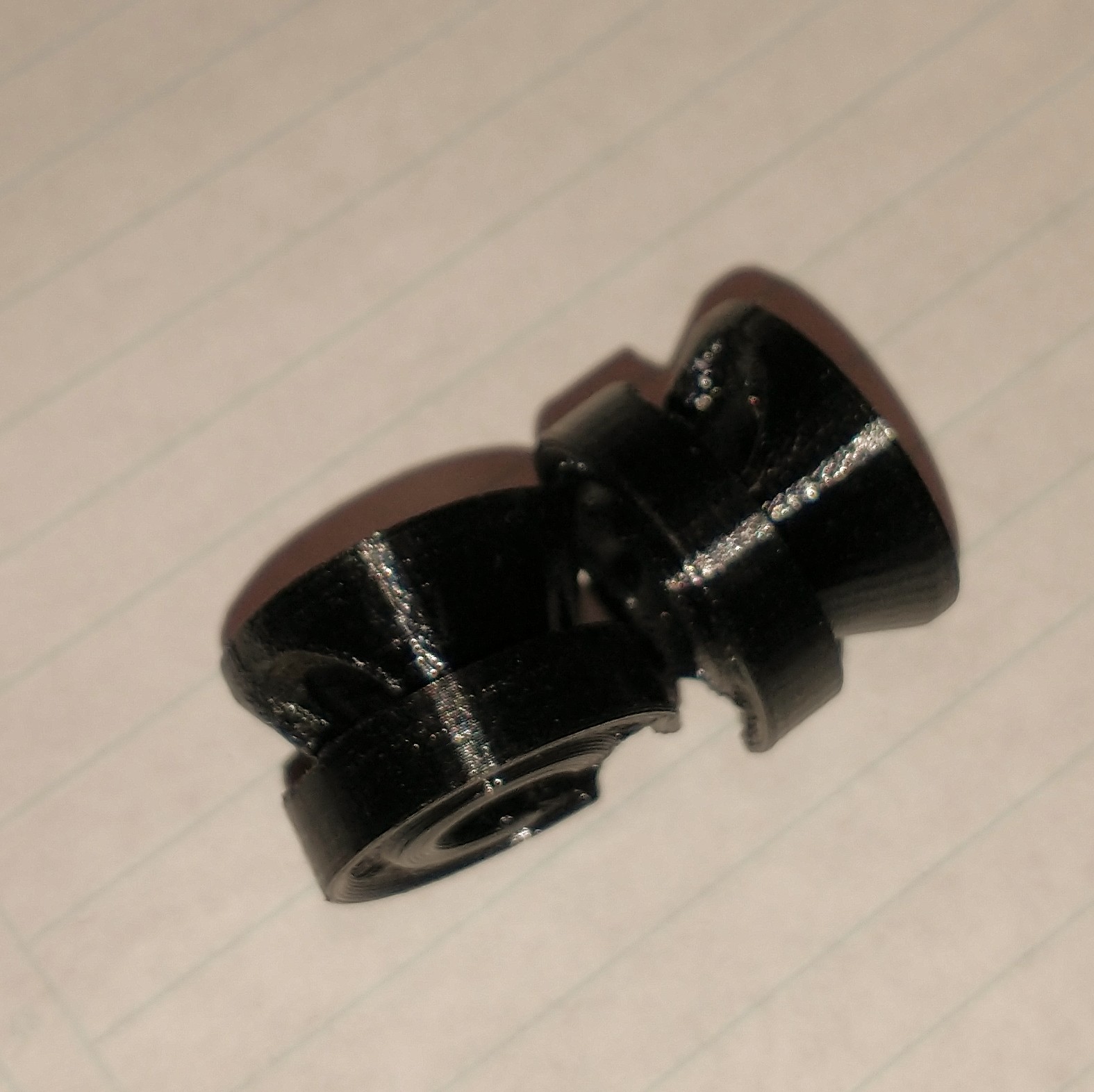

Hi Mike,
The OD of my Baffles matches the ID of the tube I am building the moderator upon. The length varies depending upon what I need in the specific application. I can also vary a number of other parameters programmatically. The angle of the port can vary by about 15 degrees. I can change the ratio of the cone to the "deck". I can increase or decrease the size of the port and the diameter of the bore.
I use OpenSCAD to build my baffle programmatically. This allows me to tune the baffle to the specific application. I can scale the entire structure in X,Y, and Z.
Now if I just understood fluid dynamics I'd be able to use all that code to good advantage
