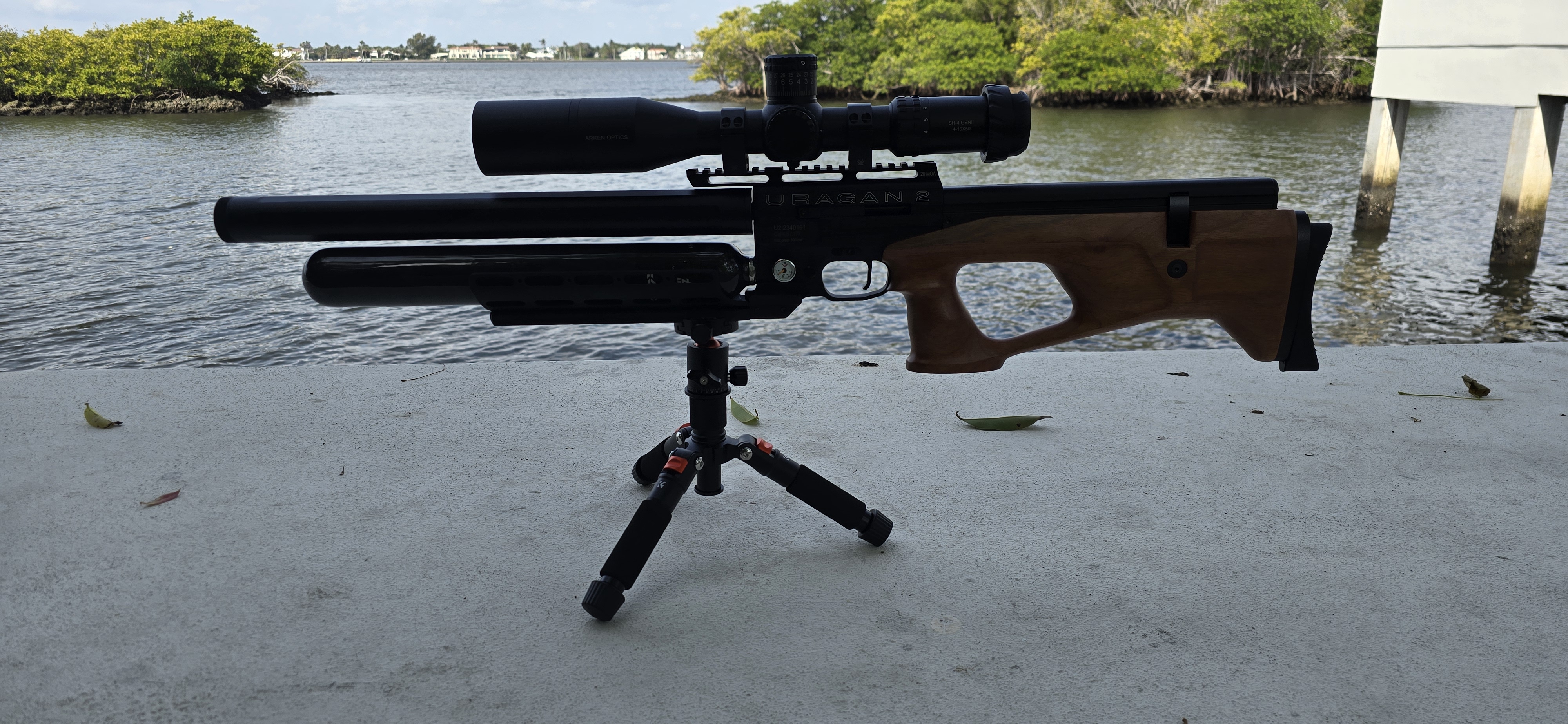

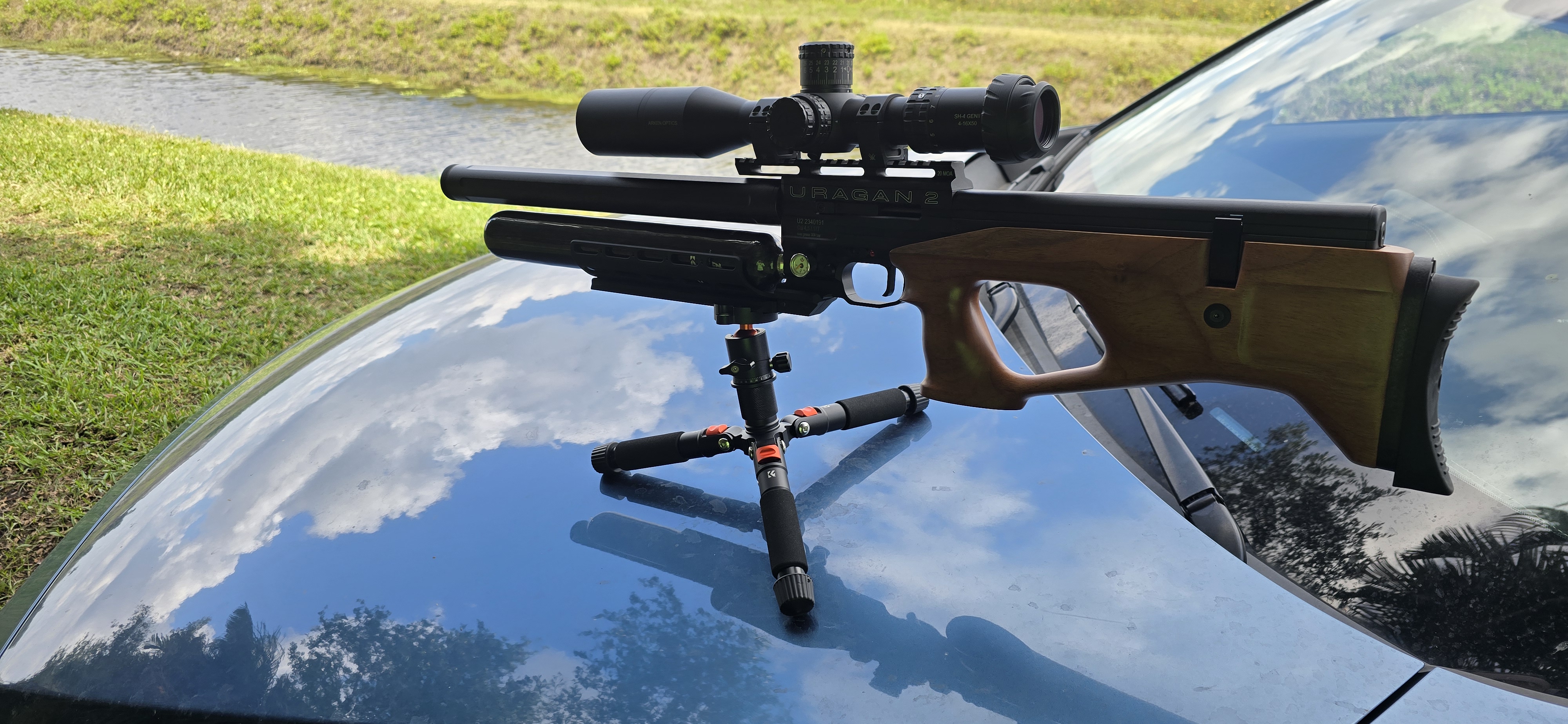

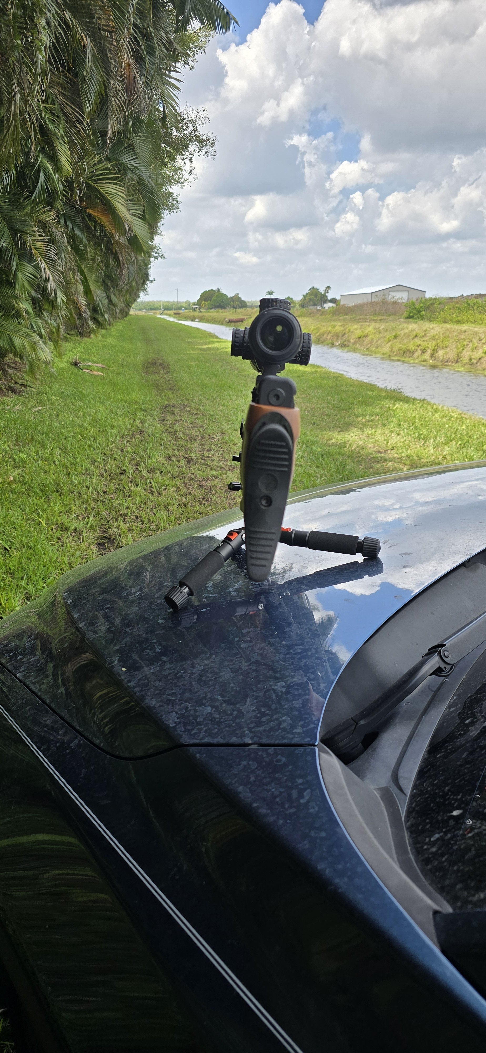

This is not an in depth review but more of my take on this little tripod as I have been using it for the past few days.
I originally got this tripod to shoot off the hood of the car, along with trying out shooting prone, and shooting while I sit as I have many opportunities to do so.
Things I like:
It's really small, portable and lightweight, the legs are twist locking, and it is very stable for such a small tripod, and it has 3 adjustable angles.
When the legs are extended they are very secure as long as you make sure that you twist lock them correctly.
There is zero wobble to this tripod and it has an adjustable post that can give you extra height or bring you lower to the ground.
Things I don't like:
It will not support the weight of any rifle in rhe 23⁰ angle position, even if the legs are fully extended, no matter how compact the rifle is or where it is centered, it simply is too short and will want to tip in which ever direction it is heaviest. (The other 2 angle adjustmentd work just fine).
The adjusting knobs aren't too small, but they definitely aren't big enough. Not to say that you need to crank it down to be secure for all weight but when you want to put say a 10lb gun you need the extra grip and force.

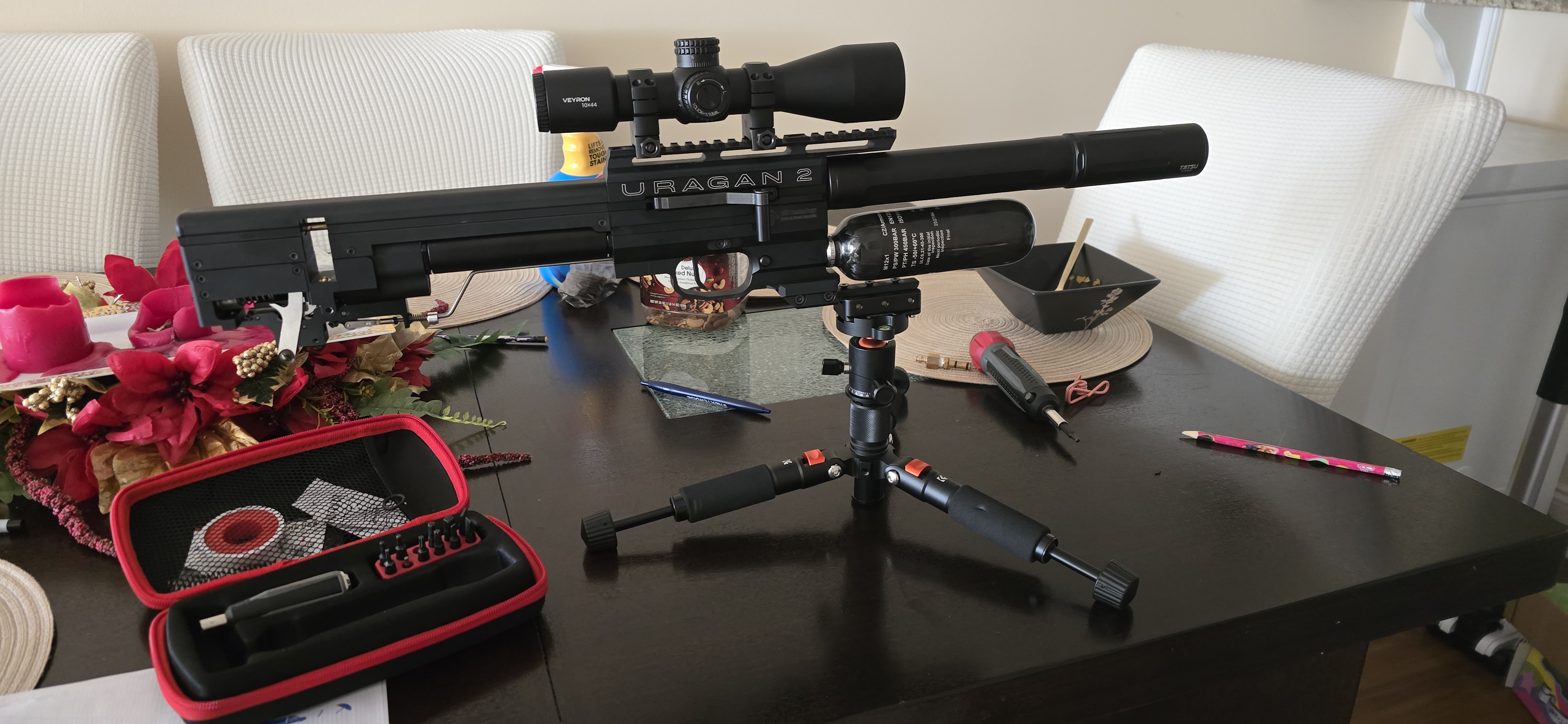

The ball head I find to be too small and weak, this issue is also worsened by the adjustment knob not being being enough to tighten properly. With guns like my Uragan 2 600mm .177 with an Arken SH4, the rifle  NEEDS to be centered, otherwise it is too much weight on the ballhead and the rifle will tilt back and not stay in place. Also make sure that the back of the gun is in line with one of the legs for proper balance.
It takes time to set this up, idk if I simply set my expecting high given the ease of using a bipod, but it takes me about 3-4 times as long as it would to set up a bipod.
All in all, this tripod has it's quirks, and if you want to shoot this from specific positions it will work very well, just be ready to take some time to set up. A lot of my shooting as y'all know is on the spot, I don't have time to set up and wait most of the time. In a few of my areas I can set it up and use it to pan and quickly lock it in for a shot which is very nice.
I will also say that for what I originslly wanted to try which was shooting off the hood of the car, it worked beautifully!
Just dont expect to be able to do everything like I did. Haha, I will likely be keeping this, and also be getting and ARCA bipod and swap between the two

Yes I do agree that I would not leave it unattended cause it could fall, but I will say that I did test it's balance on the floor and on the vehicle before leaving it attended.

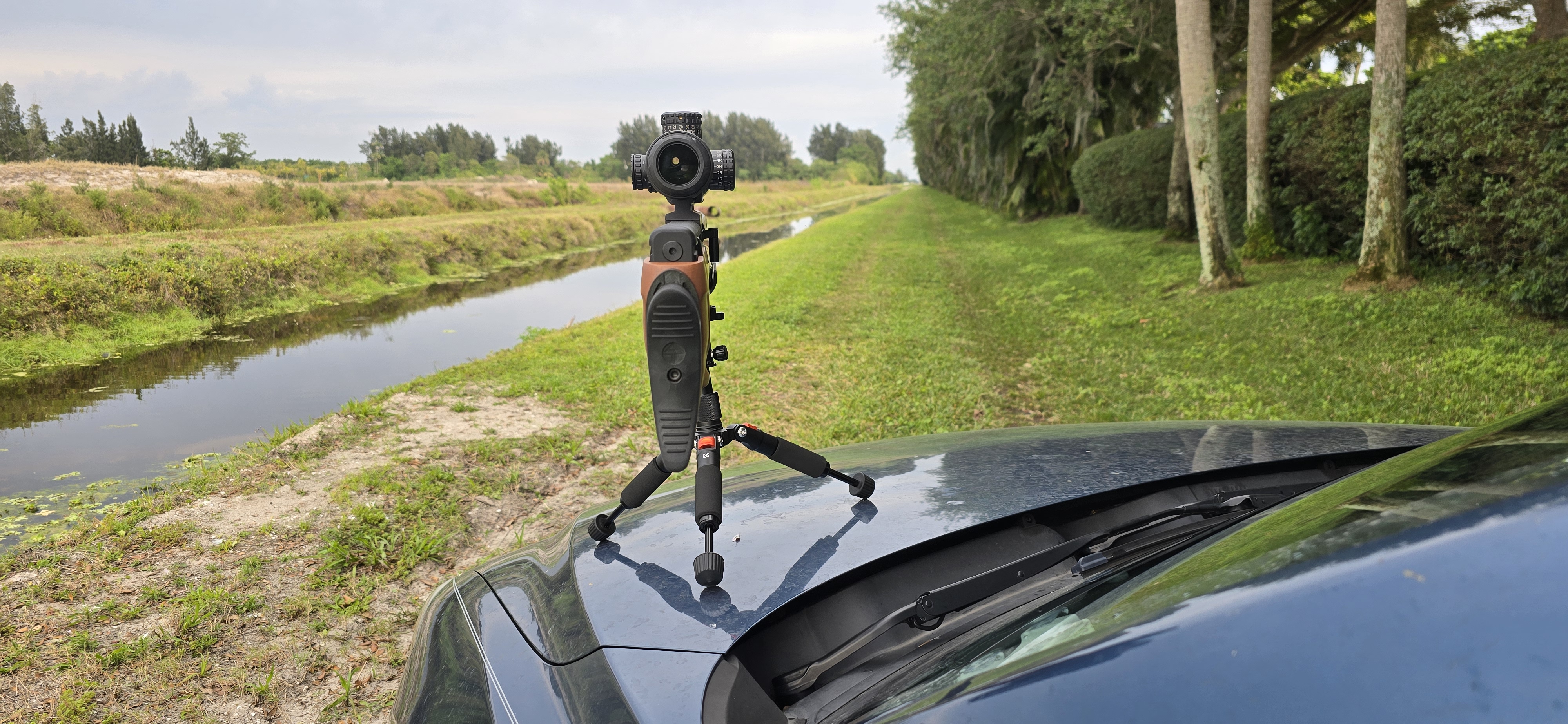

On the 5th picture I actually walked away from it, to my car about 60yds away, refilled 2 mags and came back to it still in place. Risky, but given my weather scenario, I knew it would tip or fall. That being said it there were wind or on top of the hood of the car where the car can be moved by the wind I wouldn't know have left it alone for that long.

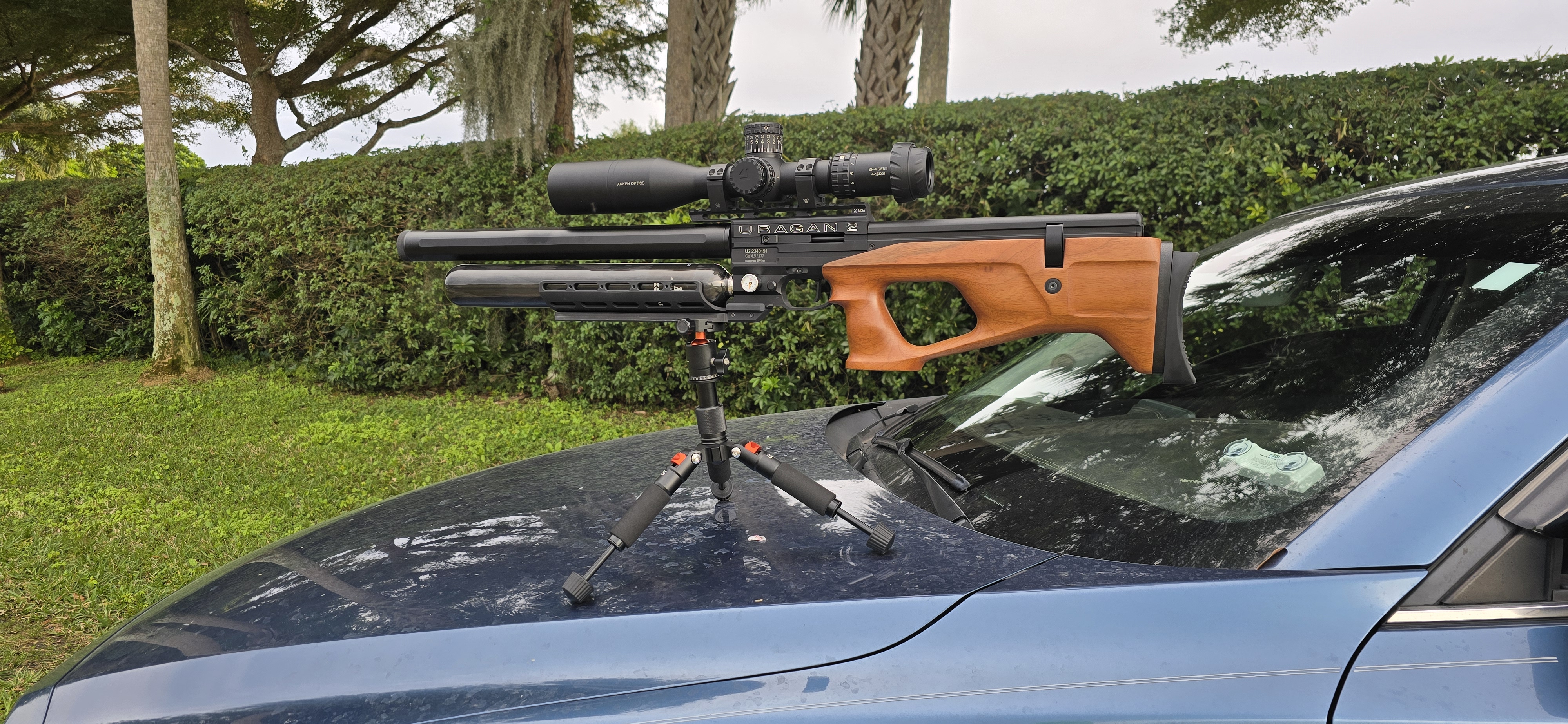

Also if you look at the last picture a little longer you'll notice that the gun is canted to the left, 10-20 degrees, I also tried wiggling it in that position and it did not want to fall either.

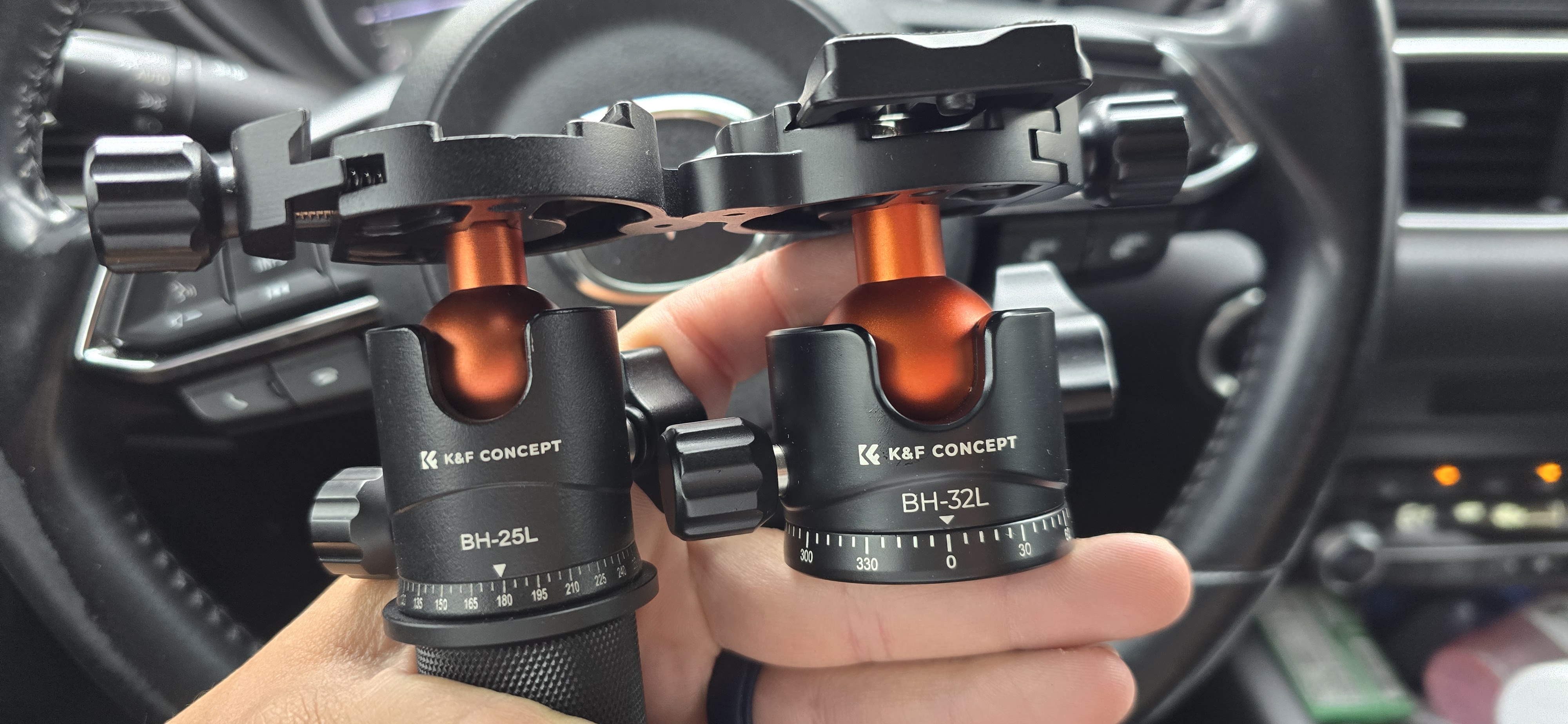

So I noticed that the the size of the ball head is printed above the degree lines for panning. The one on mine is a 25 millimeter ball head, i was gonna go for the 28mm but decided to instead go for the 32mm ball head just to be on the safe side!

While I don't have personal experience to compare, most posts here & other (air)gun forums seem to recommend 40+mm ball heads, including into the 50+mm range. The larger ball head gives more clamping area, and given a choice, even 32mm seems pretty small, since it's not just the weight to consider, but the leverage a rifle has compared to a typical camera. Even in the <$50 price range, there are lots of 40+mm to choose from.
I wasn't sure that you could interchange heads between different brands and that's the largest one that K&F offered, at least through amazon. But it says the 32mm ball head is rated for 26lbs, where as the 25mm ballhead mine is rated for 13.4lbs, so i'm hoping it's enough, and if I really need to increase to a much larger ballhead, then I'll get another one and return the 32mm
32mm ballhead is definitely girthier both on the ball and the neck. Feels much more solid, and I have more leverage on the lever, not a ton more, but significantly more. Also changing ballheads was much easier and quicker than I thought it would be. I spent maybe 2 minutes total swapping heads.
